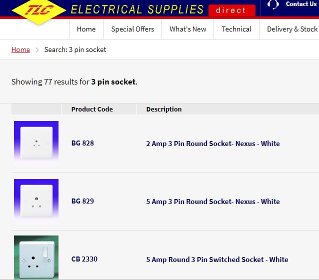

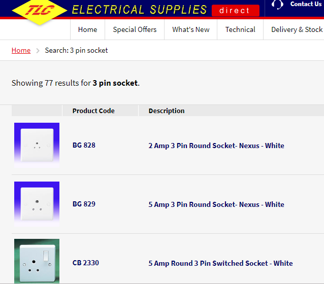

I suppose it would be an acceptable description to say they are sockets for 3 round-pin plugs.
Yep, that sounds like a perfectly reasonable description.
They are not, though, 3 pin round sockets, are they? ... Also, no one would say the sockets had three pins (let alone two), would they?
As you imply, they have no 'pins' at all - hence my presentation of that to indicate that the use of terminology in this area is, at least partially, confused and confusing.
It's a pretty widespread issue. If you do searches for "N-pin socket", where N can be any single-digit (or smallish double-digit) number, you will find (amongst other things) countless hits relating to things that have no 'pins' at all (but do have 'holes'/places into which one can plug 'pins').
Kind Regards, John
Did you miss a part of what I meant?
"3 pin round sockets"
Not only do they have no pins, but they are not round sockets.

Did you miss a part of what I meant? "3 pin round sockets" Not only do they have no pins, but they are not round sockets.
Yes, I did miss that. I suppose they could have avoided that particular criticism by writing "3 round pin sockets", but that would not have altered the fact that they have no pins (of any shape) at all.
Although not an excuse, I suppose that some of this arises out of a desire for a somewhat more concise product name/descriptor than, say "Socket for 2A 3-round-pin plugs".
Kind Regards, John
