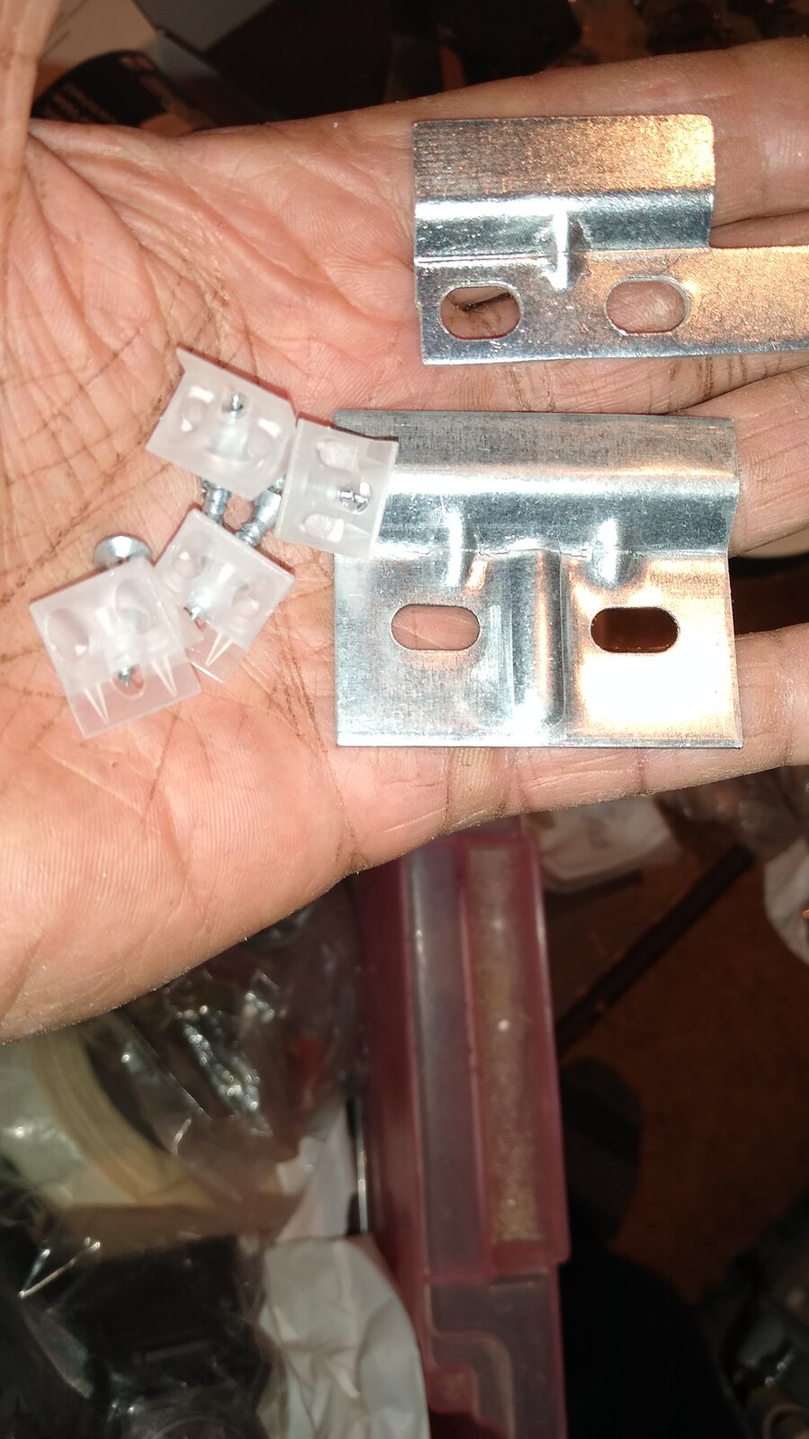

This year B&Q have a new kitchen range under the Good Home brand with a so called 25year warranty.
Its still flat pack and from what I can see it looks like backward compatable in terms of size and fittings with previous one.
Theyve added four plastic clips that screw through the back panel into the main frame which does stiffen and take all movement out.
They have however downsized the wall unit hangers so small that the screws are so close together thy may merge into one on a less than sound wall.
Picture shows bracing clips ,new and old type hangers
How do these compare with the other flat packed kitchens?
