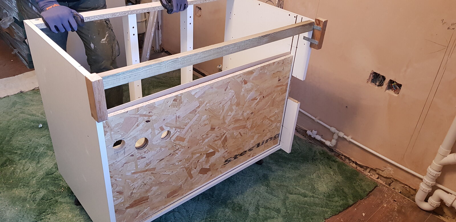

Also, howdens carcasses have a solid 12mm or 15mm back chipboard, while the diy from b&q or wickes have a 3.5mm mdf panel which pops off as soon as a pan is pushed against it.
When I had to fit such kitchens I would ask the customer to
1. Send me an email confirming that they understood the fragility of these back boards and accepted full responsibility for it
Or
2. Pay me to re-inforce them so they won't pop off.

I hope your customer johnny appreciate the rarity of this level of care and attention! Many chaps wouldn't give a monkeys and as soon as the jobs done and moneys in they forget about it and are off to the next customer. It's nice to see someone appreciate what a quality job is.
In the above picture I take it that's a cheapo B&Q or similar and the inside piece of wood is there back and you've made a superior back using sterlingboard. Are you now going to glue the sterlingboard to the back of the MDF panel that came with the carcass
I'm officially retired now and only take jobs when I know the customers.
They're the kind who don't mind to pay for quality workmanship despite being on a budget.
I can save them money in the long run.
In the pictures you see a cheap b&q end of line cabinet which the customer paid peanuts for (£7.50).
I couldn't blame them for it.
All the cabinets came to less than £100, although I had to slice 6 of them from 800 to 600.
I don't glue the sterling board, i put a couple of screws, especially on the sink cabinet.
If in 20 years time they have a leak and the thin mdf panel is damaged, screws off and panel replaced in half hour (or even sterling board painted.

How old is the house that you're working in as I see they've got plastic plumbing? Is it a new build?
It's a 1930 terraced house.
New plumbing was installed prior to us fitting the kitchen at the beginning of the year.
