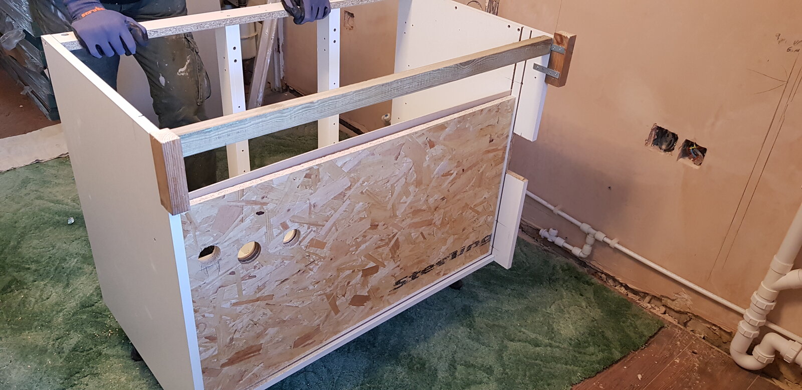

Also, howdens carcasses have a solid 12mm or 15mm back chipboard, while the diy from b&q or wickes have a 3.5mm mdf panel which pops off as soon as a pan is pushed against it.
When I had to fit such kitchens I would ask the customer to
1. Send me an email confirming that they understood the fragility of these back boards and accepted full responsibility for it
Or
2. Pay me to re-inforce them so they won't pop off.

I fitted our Wickes kitchen probably 12 years ago and its still in good order. All the carcass backs were thick (same thickness as sides).
No problems with the cupboard doors or drawers either.
Shame if their quality has gone down the pan as I was genuinely impressed how solid the units were.
