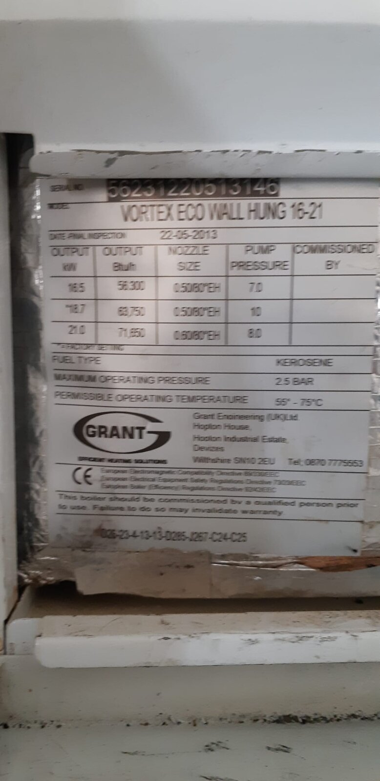

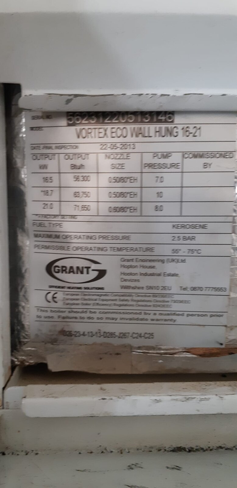

Can you post a photo of the boiler labelled details, can then download elec schematic to take a few tests.

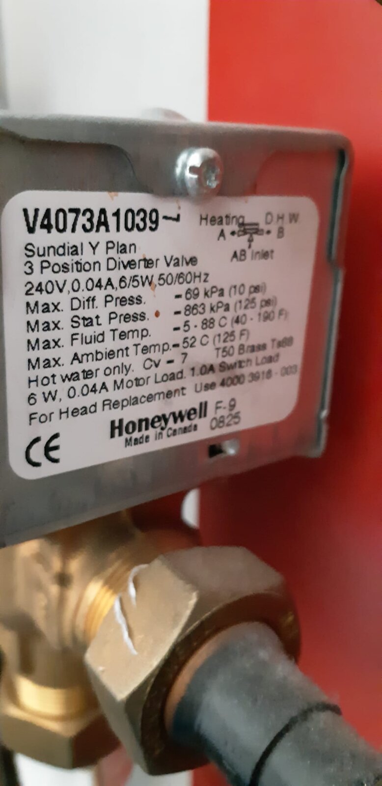

Also a photo of the MPV details.

had already done MPV
was hoping that would be the case with removing actuator.

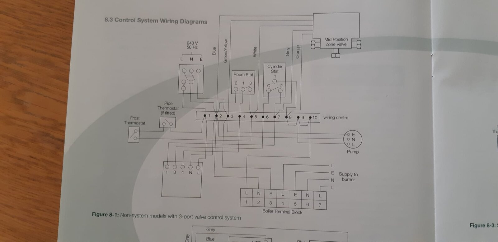

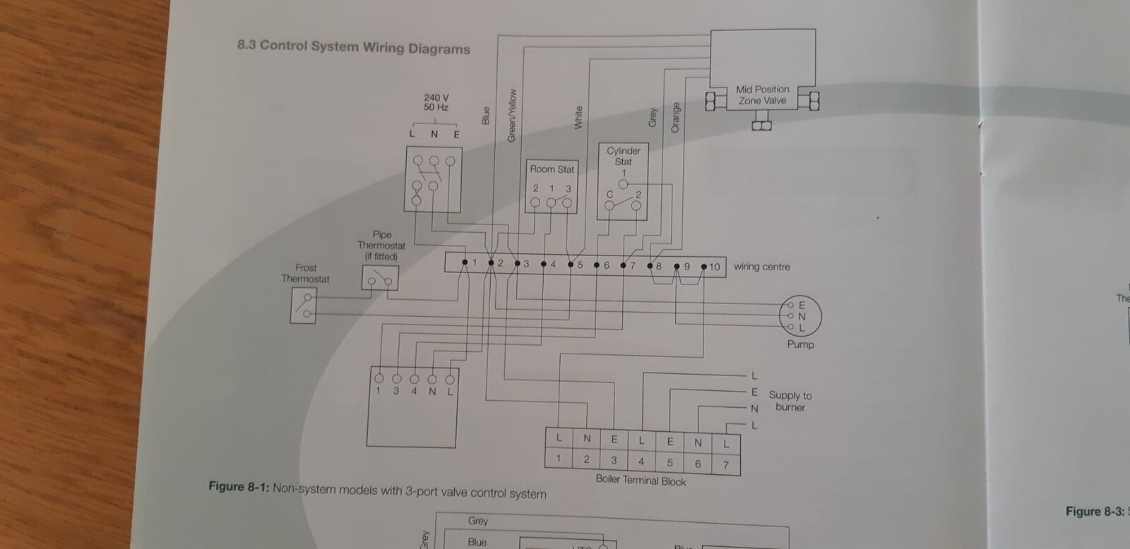

I have install manual with wiring diagrams but the quality of my pics, on here, are not very clear. Heres one to test if clear enough

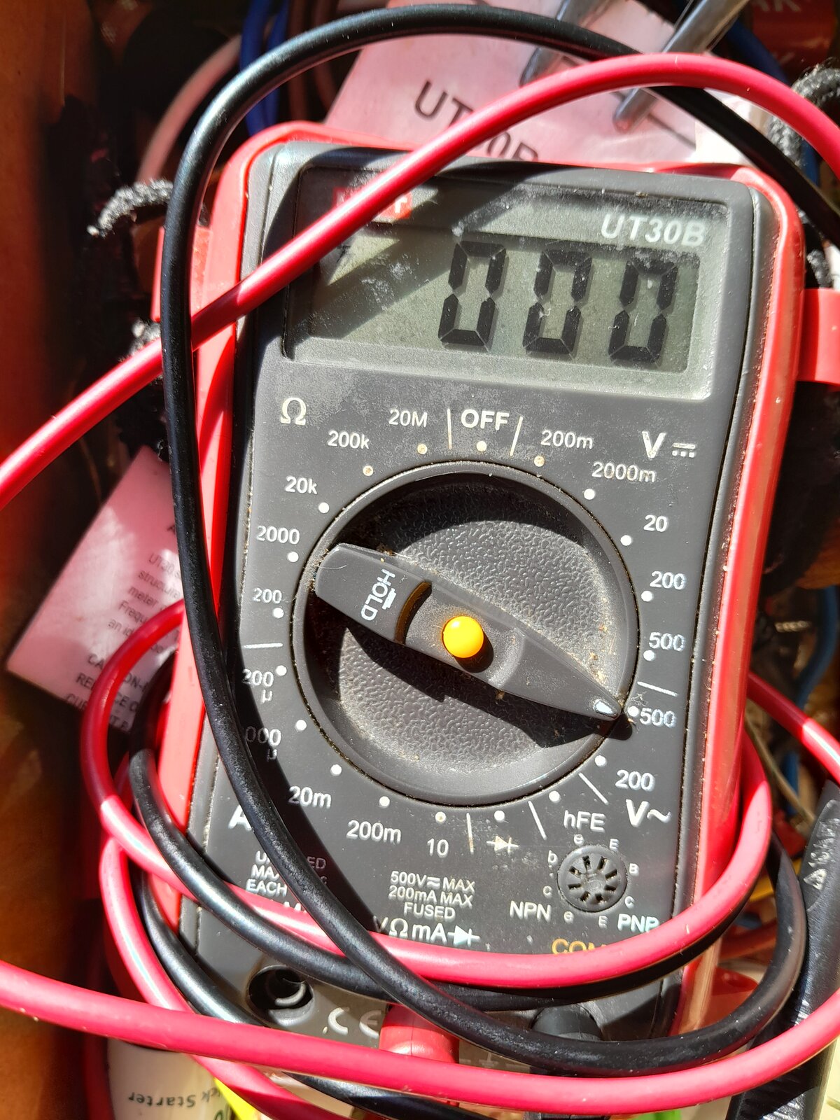

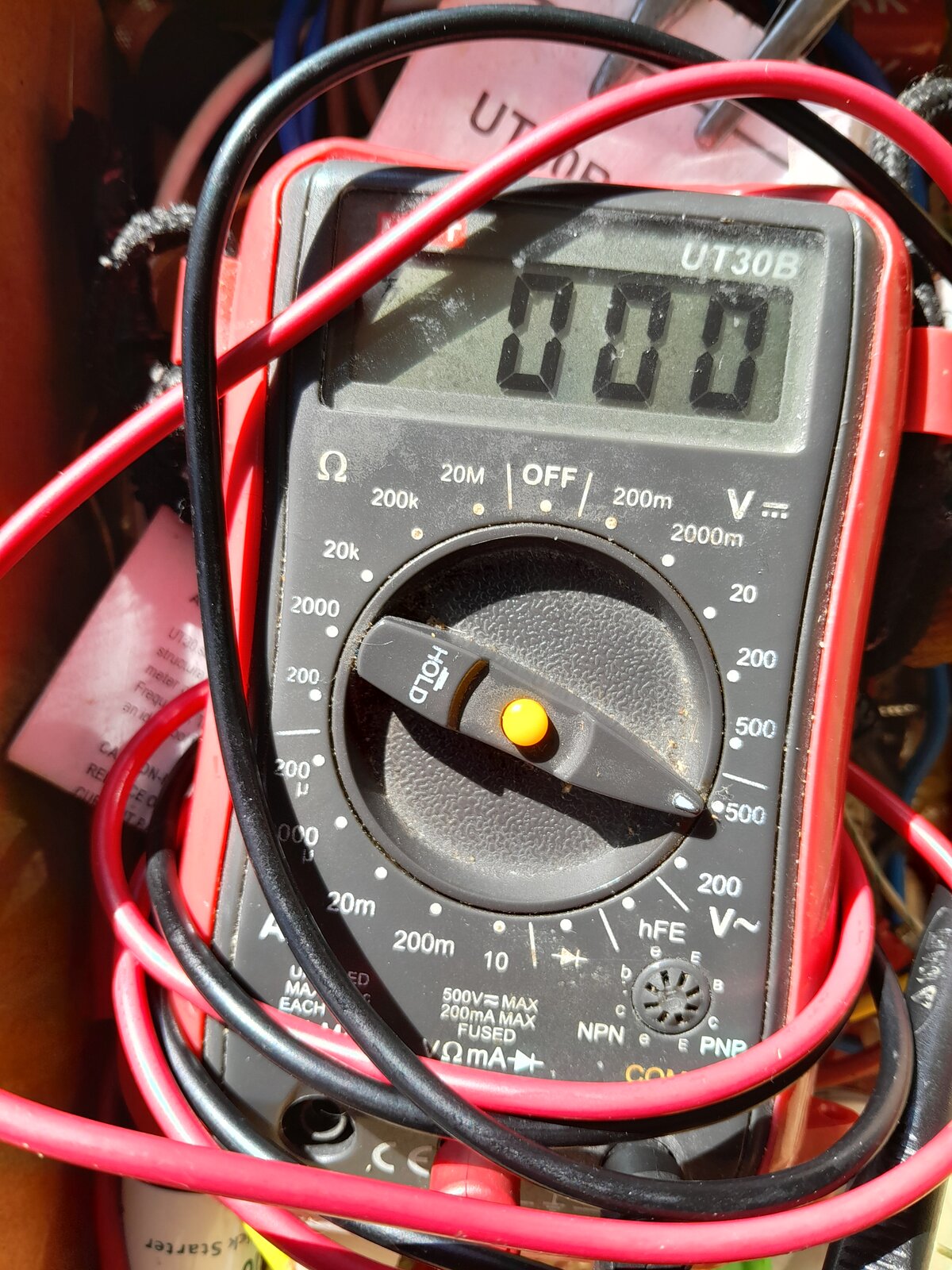

To carry out test, set your M.meter to 500V (AC) the V has a squiggle after it, like mine, below, on the boiler wiring terminals, put one probe on terminal1 L and the other probe to N, do this test with both HW & CH selected and boiler hunting, whether this voltage is changing or not, do the same tests between ter 4 & N and ter 7 &N., 10 secs or so should be enough.
I left meter on for over 10 secs for each of the 3 tests
2(N) - 1 240v constant
2(N) - 4 all over the place. Probably about 58. is most consistent reading
2(N) - 7 240 through cycles. Shows OL for split sec when switching back on
Ok, thanks, repeat that test with HW Only on and post back, then repeat it again with CH only on and post back.
2(N) - 7 random figures as low as 6v and up to 180v
