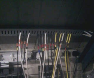

And to really add insult to injury in the AV industry cables are often colour coded, often with PVC tape flags. The terminal box pictured earlier often has a set of brown wires with tape flags in the orter: brown, red, orange, yellow, green, blue, purple, grey, white, black [ie the international electrical/electronic colour code] and a matching set of blues in the same way as the numerical cable markers. Worse a bunch of wires in one colour, or a random selection, with 2 flags, as shown plus a brown or a blue.
.... a set of brown wires with tape flags in the orter: brown, red, orange, yellow, green, blue, purple, grey, white, black [ie the international electrical/electronic colour code]
Indeed, that exactyly the sort of 'personal convention' (although, in this case, it would probably be more widely understood) I use with electronics or signalling/control situations, particularly when there are assoiciated multi-pin connectors etc.
... so, in that context, to me brown identifies a conductor as being "#1" and blue identifies it as "#6" (not 'line' and 'neutral').

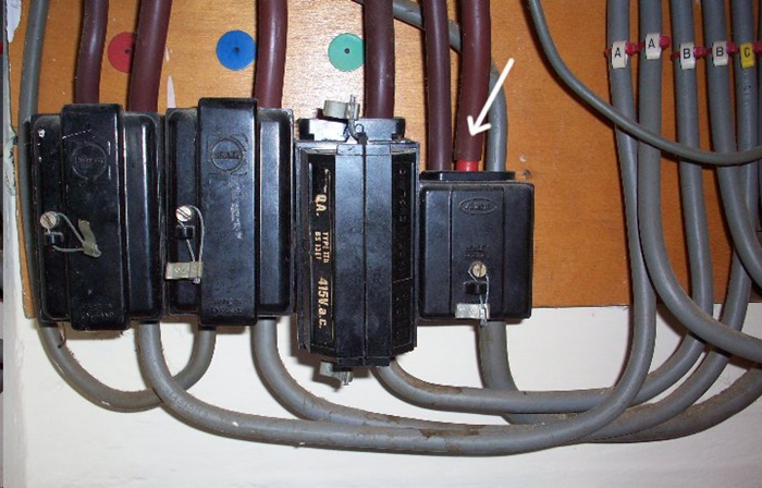

I wonder what (if they also misunderstood the scope of an EICR) they would have to say about the 'identification' of my incoming neutral (red insulation with a brown sheath!) (this pic taken before the most recent meter-changer 'covered yp the evidence' with grey silicone :) ) ...
Kind Regards, John
