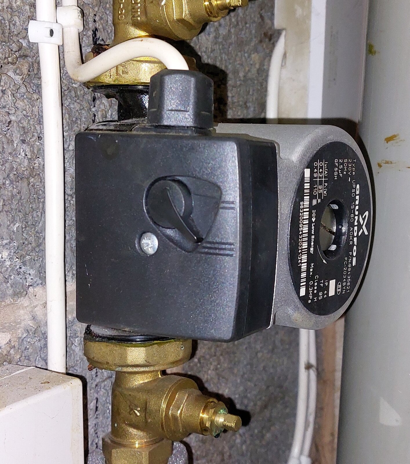

I have a Worcester Bosch Greenstar 24ri gas fired boiler for water and central heating. Hot water is via an indirect cylinder, tank stat set to 60C and boiler set to give flow temperature at around 73C (measured using contact thermocouple on pipe). Grundfoss pump set on speed setting 2 of 2. Time clock is set for a 1 hour cycle in the morning.
Problem: At the start of the cycle the boiler fires and runs for around 35 minutes. Boiler then stops firing but zone valve is still open and pump running because tank not up to temperature. Flow temperature drops to around 57C but boiler does not re-fire for 15 -20 minutes. System shuts down at the end of the one hour cycle. If I let it run beyond the one hour the boiler will re-fire eventually and the tank will get to temperature in about 90 minutes.

Buy a couple of cheap, Chinese, digital temperature displays, with remote sensors. Clip them to the flow and return pipe close to the boiler, then you will be able to accurately see what the boiler is actually doing.

I've got one on the flow pipe which is how I'm monitoring the temperature. I am thinking about buying a simple temperature data logger so that I can prove to WB what is actually happening.
I have had a temeprature data logger measuring the temperature on the flow pipe from the boiler. Temperature peaked at around 70C after 35 minutes and then dropped to 51C over the remainder of the one hour cycle. Boiler did not re-ignite. Bosch attending tomorrow to replace the temperature sensor which is what they should have done when I first reported this issue two years ago!
