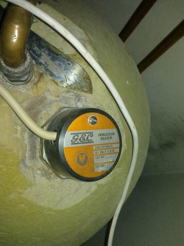

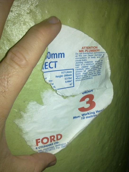

In the interests of establishing whether it's likely to be a limitation of the cylinder causing the problem, I attach a couple of pics to possibly identify the age / type. The pic of the immersion heater head is included with the assumption that it's the same age as the cylinder, it may of course be newer.
