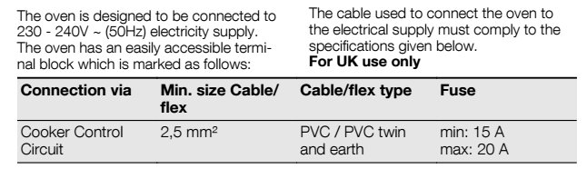

Will the arguers please give an example of a manufacturer (extractor fans excepted) demanding specific overcurrent protection for their product where it is not for a supplied flex?
Why extractor fans excepted? Aren't they a good and common example of where a manufacturer specifies a maximum fuse/MCB size?
Do you agree that the 15A relates to the supply necessary for operation (presumably without diversity, although for such a small appliance it may not apply. Two elements may possibly be used at the same time) and
the 20A is for the 2.5mm² cable (although this could be 25A).
If so, do you not think these requirements are merely information for those without detailed knowledge.
If not, what damage do you think may occur to the appliance were it connected with 4mm² cable, or 6mm² - or a 25A or 32A opd?
Do you think someone with a standard cooker circuit (6mm²,32A) should replace it with 2.5mm²?

Do you agree that the 15A relates to the supply necessary for operation (presumably without diversity, although for such a small appliance it may not apply. Two elements may possibly be used at the same time) ...
Yes. Although I can't find mention of power requirements in the instructions, the OP said that the appliance itself is labelled "3.5kW" - so (without diversity) 13A is not enough, so I guess that 15A is the 'next step up'. With diversity (and I don't see why not), 13A (i.e. a plug or FCU) would be adequate.
...and ... the 20A is for the 2.5mm² cable (although this could be 25A). If so, do you not think these requirements are merely information for those without detailed knowledge.
Maybe that was their intent, but the "maximum 20A" will be taken by most readers to mean what it appears to say - and prior to July, even many electricians would probably have felt constrained to adhere to that.
As was being discussed in that other thread, that statement (without qualification) has nuisance value if one wants to run two appliances off a single 32A supply and also 'obey the MIs'. They could, had they felt it appropriate, have said that it was OK to connect it to a 32A-protected circuit if one used 4mm² cable.
If, say, the appliance contains some 1mm² conductors, then they (and the appliance) would be more likely to come to harm (or more harm) under some fault conditions if protected by a 32A OPD than if protected by a 20A one. However, as BAS says, if that is the case then, at least in an ideal world, the appliance would include appropriate internal fusing.

Do you agree that the 15A relates to the supply necessary for operation (presumably without diversity, although for such a small appliance it may not apply. Two elements may possibly be used at the same time) and the 20A is for the 2.5mm² cable (although this could be 25A).
That's not how I would read that extract, since it clearly states 20A maximum for the fuse but also 2.5 sq. mm minimum for the supply cable. Since those instructions don't preclude the use of a larger cable, it doesn't make sense to say that the 20A fuse requirement is only for the supply cable. If, for example, the manufacturer felt that the internal design of the equipment made it safe to protect it with a 30A fuse, why wouldn't he say so? In that case you could then happily feed it with 4 or 6 sq. mm cable on a 30A circuit.
Ok. that's fair enough; I may have overlooked the "Min" but I still think the reasons are as I said above.
Indeed, as stated in the 'instructions', 1.5mm² (t+e) would be adequate.
You could but then the manufacturer would have to state the multitude of options.
As he has only quoted the minimum size cable he has stated the opd size for that cable and efficient operation.

It is also stated that you must use PVC/PVC twin and earth. Is that true or, indeed, relevant?
Is there any difference in the internal wiring of small ovens and large ones?
You apparently disagree but I consider these 'instructions' merely as information for someone who does not know what to use through knowledge.
