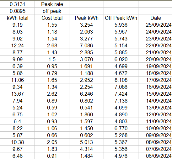

I have on the app kWh or £ and I know peak 31.31p per kWh and off peak 8.95p per kWh, I want to know how many kWh at peak and how many at off peak, I have used excel and had it change ratio so found 9.19 kWh total was approx 5.93 kWh off peak and 3.26 kWh peak, but did it by changing the ratio 0.01 kWh at a time and read it where result was £1.55. But must be an easy way to write a formula to give a direct result.

The second battery will cost around £1000 fitted, the app on the phone has a switch to add standing charge or show without standing charge. The formula you have given is spot on, now entered as an excel sheet, second battery is 3.2 kWh so on day given as an example it will means most power used will be off peak. But second advantage, think the inverter can handle 5 kW but battery max charging rate is 2 kW so even with half charged battery I end up exporting and producing over 2 kW, solar is rarely over 4 kW so second battery means will not export as much, as well as using more off peak and less peak power.

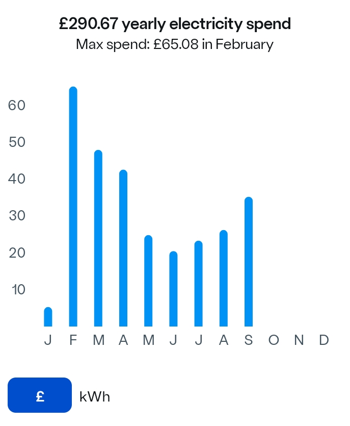

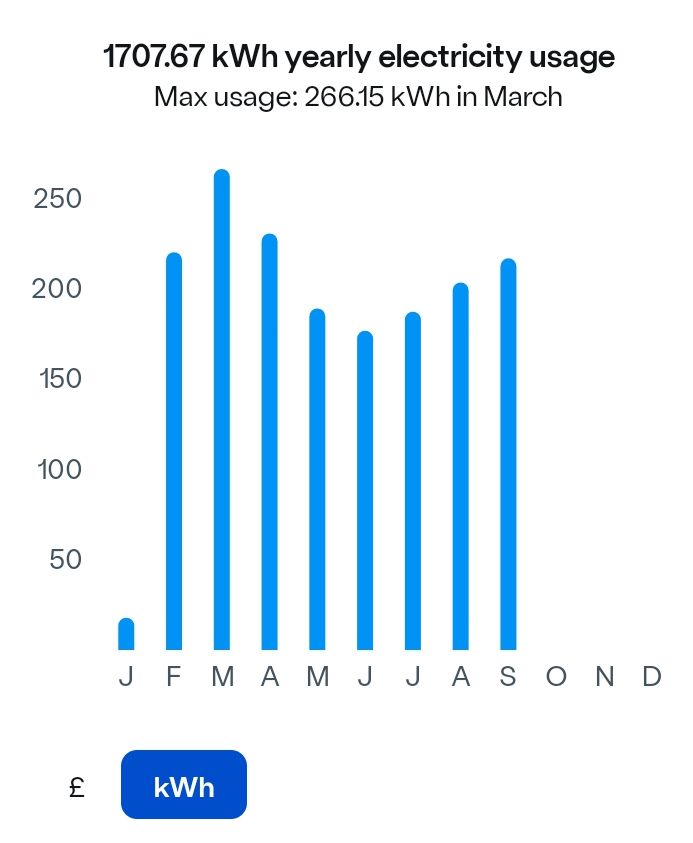

Actual usage can only really see since smart meter fitted, 1727425521902.png Jan smart meter fitted, hence low, the marked drop April to May was due to using off peak, set to kWh rather than £ 1727425737809.pngthe sharp drop is not there, a rough calculation solar saving around £40 per month, and battery around £20 per month existing battery 3.2 kWh, but also first battery means we have an UPS so heating still works when we have a power cut, also freezers, so there was an added benefit, piece of mind, the wood store in case we need to light a fire is reduced.

I had modified as you show, I should have been able to do it, but had a mental block.
Also took ages to find out how to get rows to letters, so could use $ in front of tariffs so always uses same reference.
