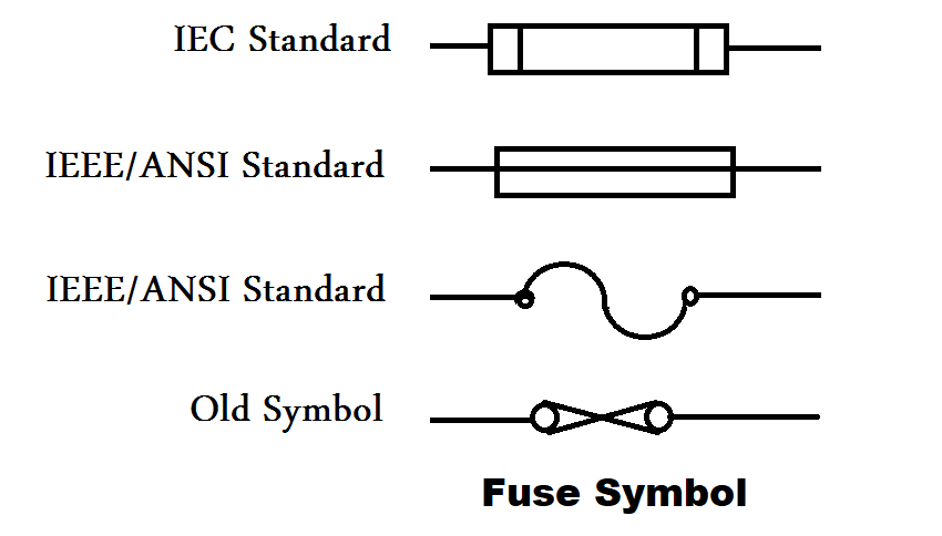

Ok, so I checked the data sticker on the tumble dryer, and it has a symbol like the attached (2nd down) with the 16A rating next to it.
There are no 16A fuses for UK plugs.
I might have to speak to Sharp then? I have what I assume is a U.K. 3 pin moulded plug and not European, 13A rated, 16A alledged fuse rating - still states 2700W, which is around 11.5A.
