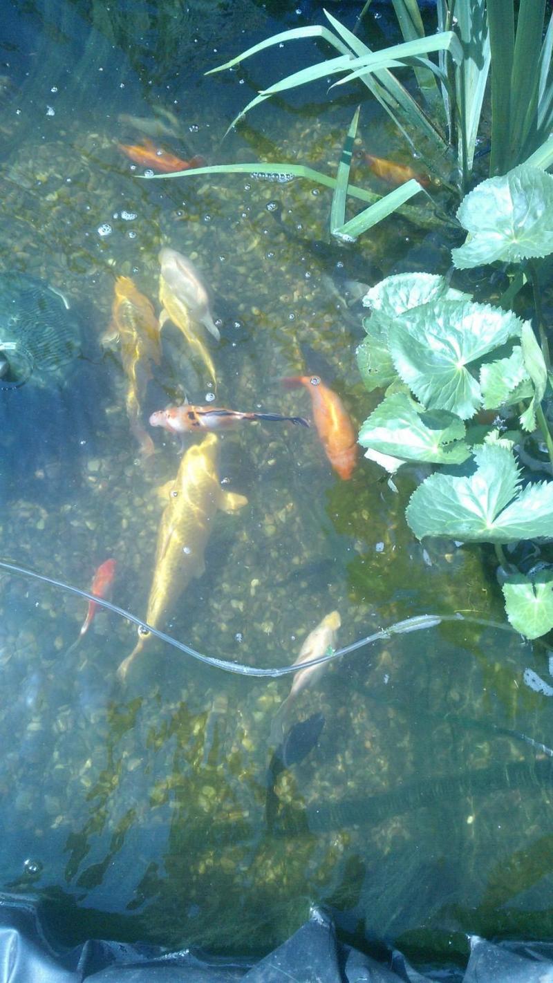

You can just see the pump on the left in the center, i have a blanket weed problem at the moment, to much direct sunlight, the yellow fish in the center is 12", 2 others just a little smaller in there as well.

It will run run over the wall of the pond between 2 of the paving slabs into a raised mound of soil that is level with the wall height. You can see on one of my photos where i mean- there are 2 rocks currently covering the gap for the cable. It will run into the mound and then run down it to the socket.
We are basically talking about 1.5m of cable that will be out of the water running to the power point.
