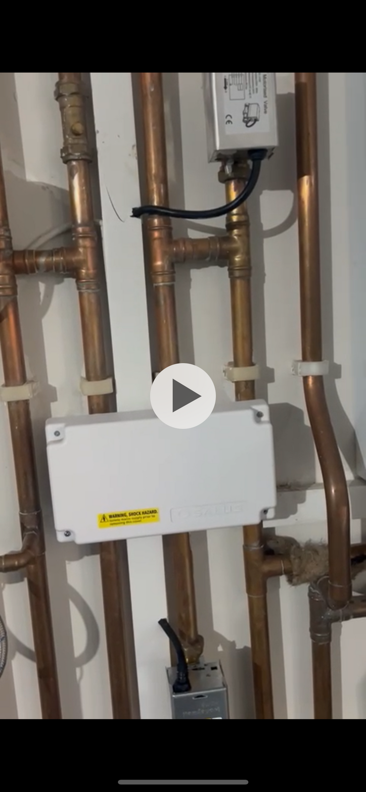

Hi DP it literally makes a huge foghorn noise which then rattles the floorboards the video is here:
This now occurs each time I put it on regardless of UFH being on whereas last year it wouldn’t make the noise when UFH was on

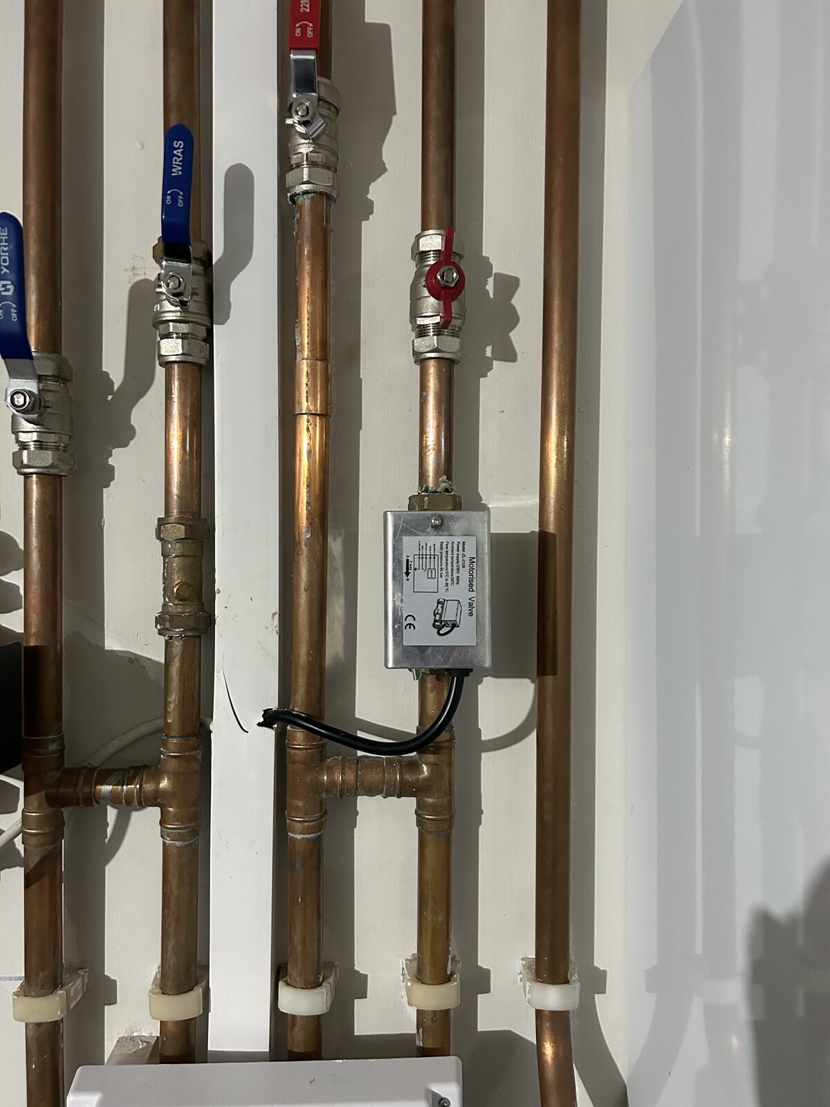

The top one is the motorised valve for the upstairs heating…
The arrow on the valve body must point towards the rads or cylinder heating coil.

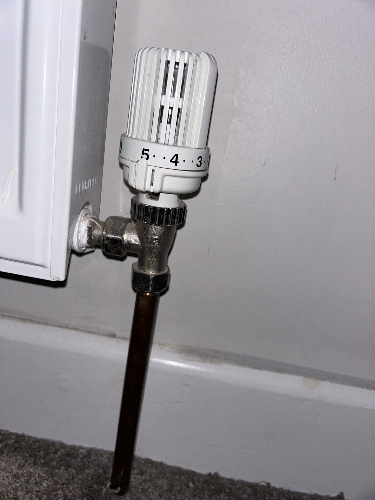

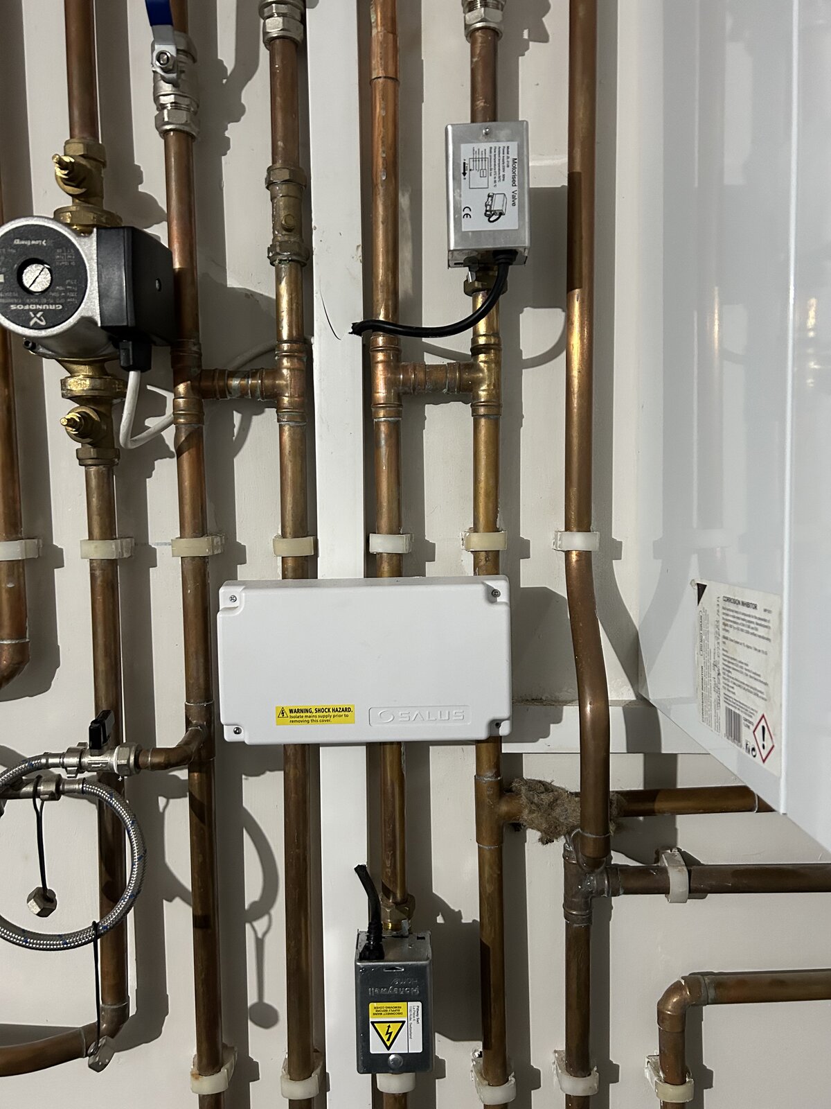

Sorry john I don’t quite understand. Iv attached a picture of one of the trvs and the actual motorised valve on my boiler

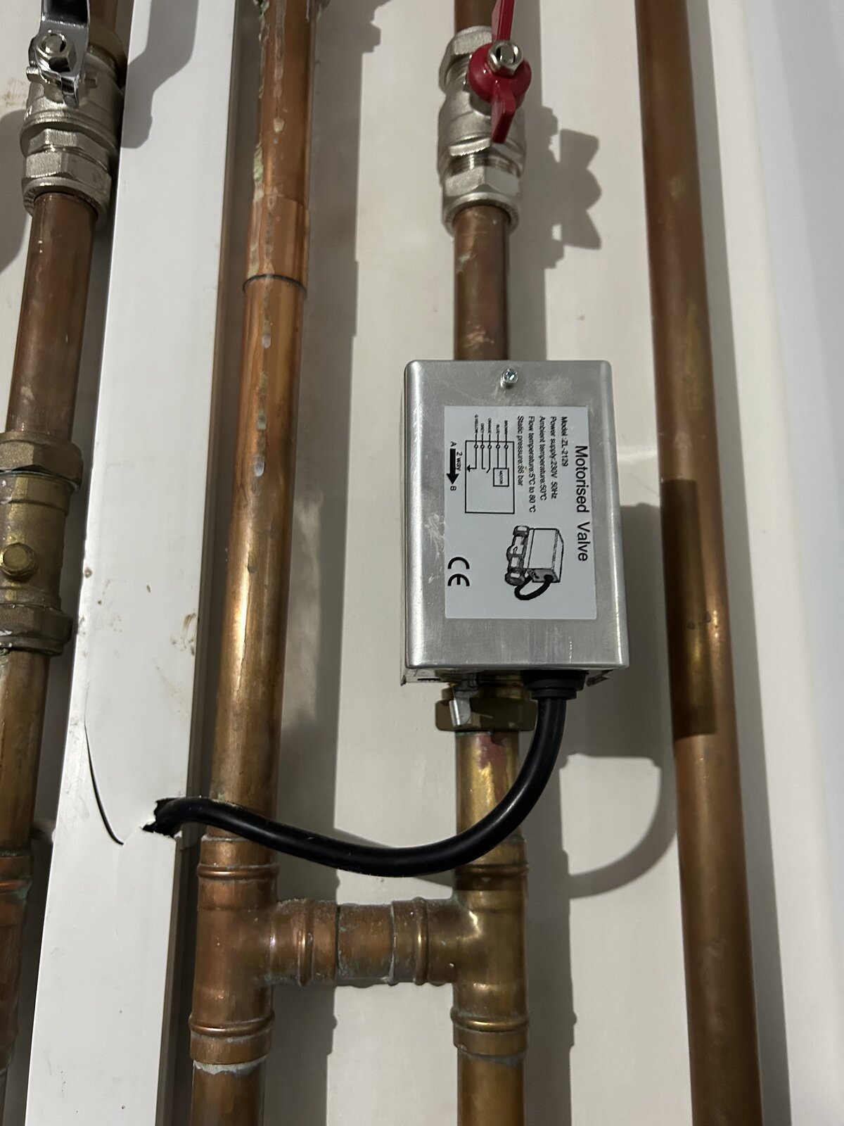

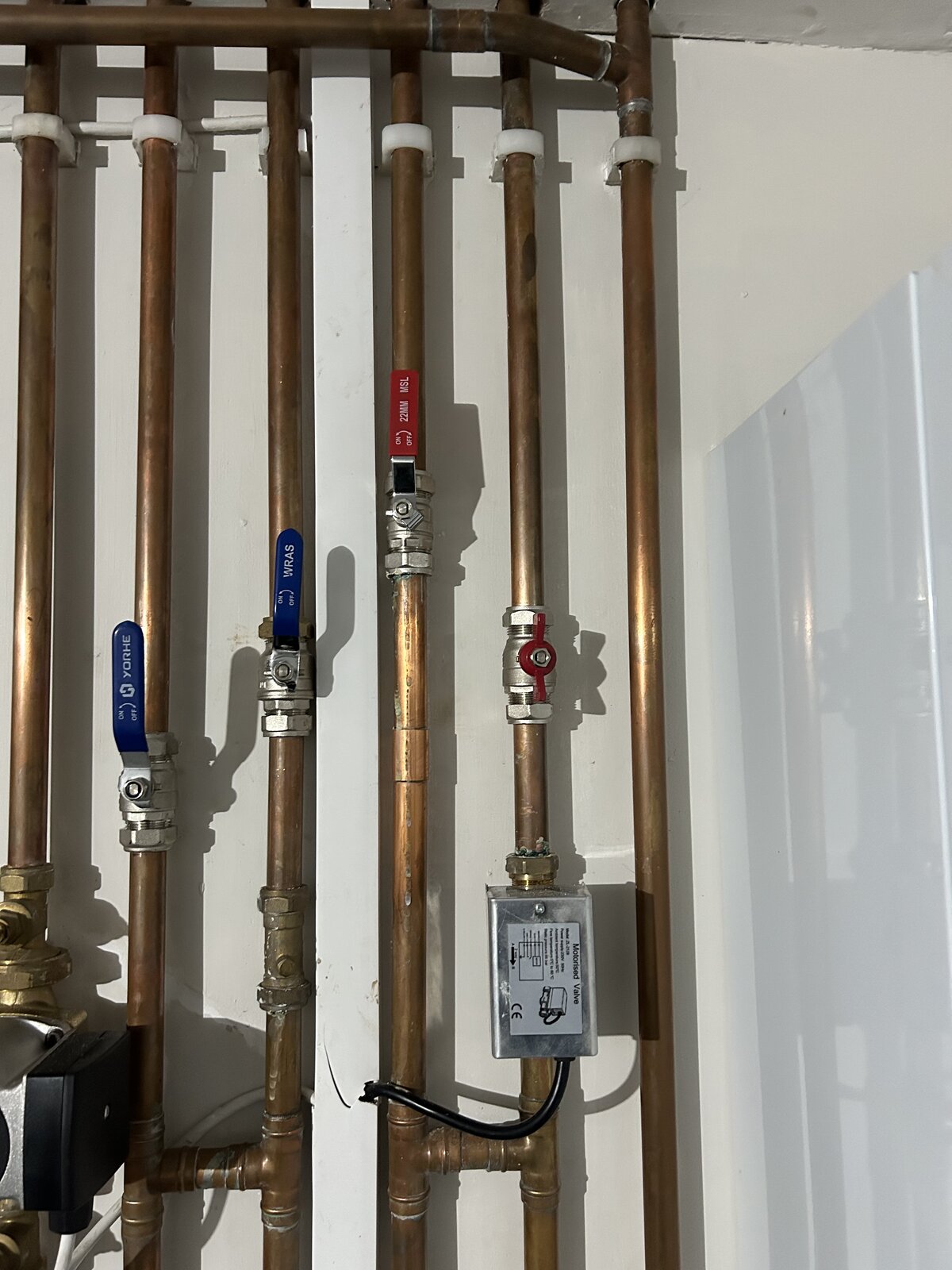

The ones that have motorized valve written on them, if the rads are above that valve shown above then the arrow on the valve body must point upward. (I think it is judging by the wiring).
I’m sorry I can’t quite understand and can’t see any arrows? All I know is the highest motorised valve is for the upstairs heating.
