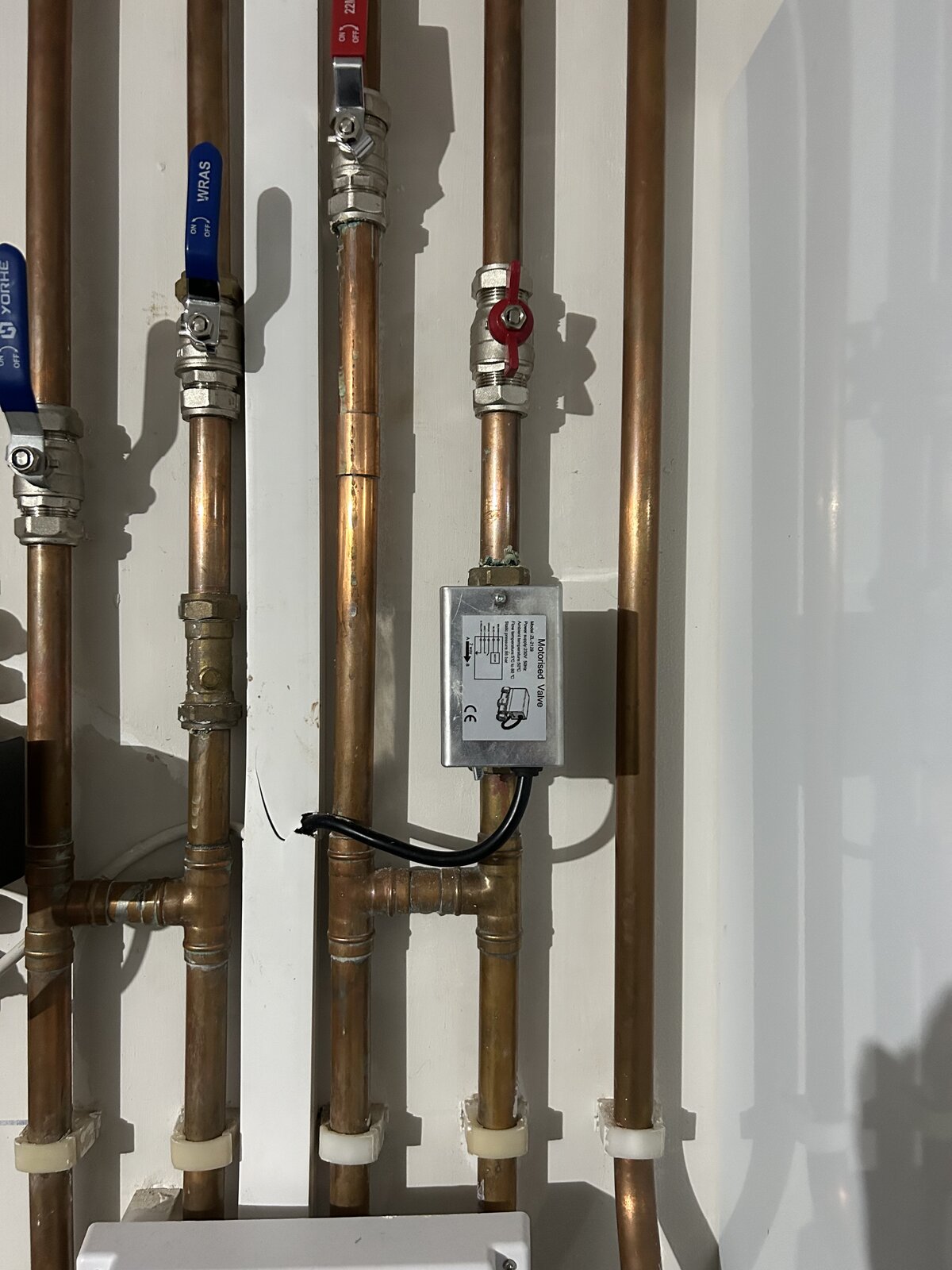

HELP: Vailiant System Boiler LOUD Vibrating Sound Whenever Upstairs Heating Is On

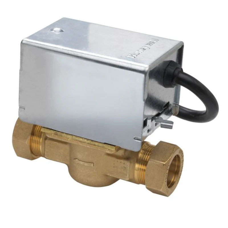

Like this one,
You say you are getting a foghorn type noise, are you sure this isn't happening when you are heating your HW cylinder?>

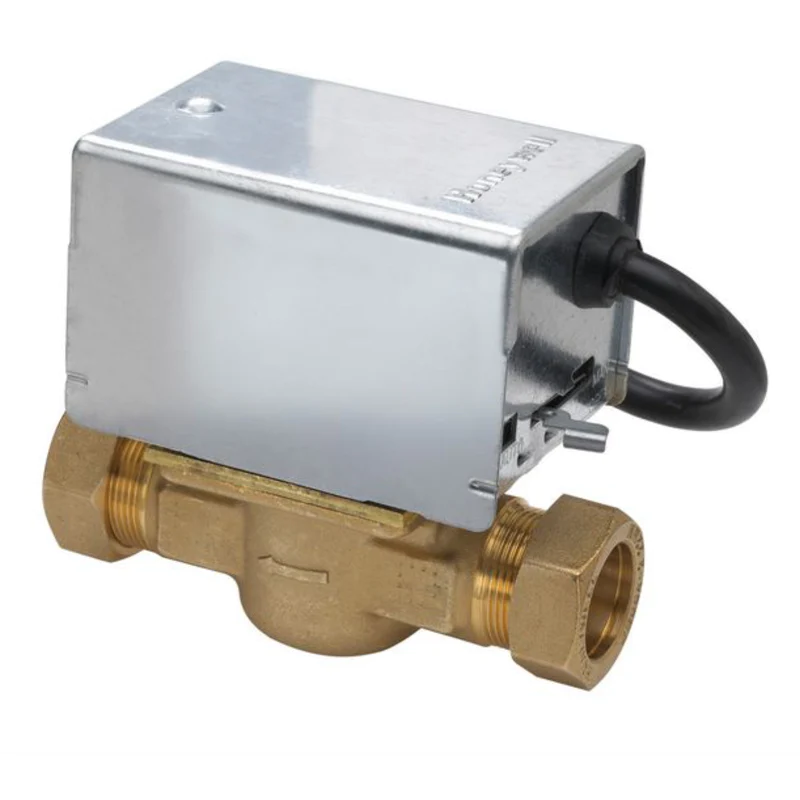

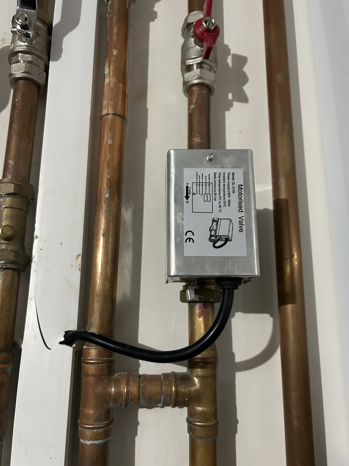

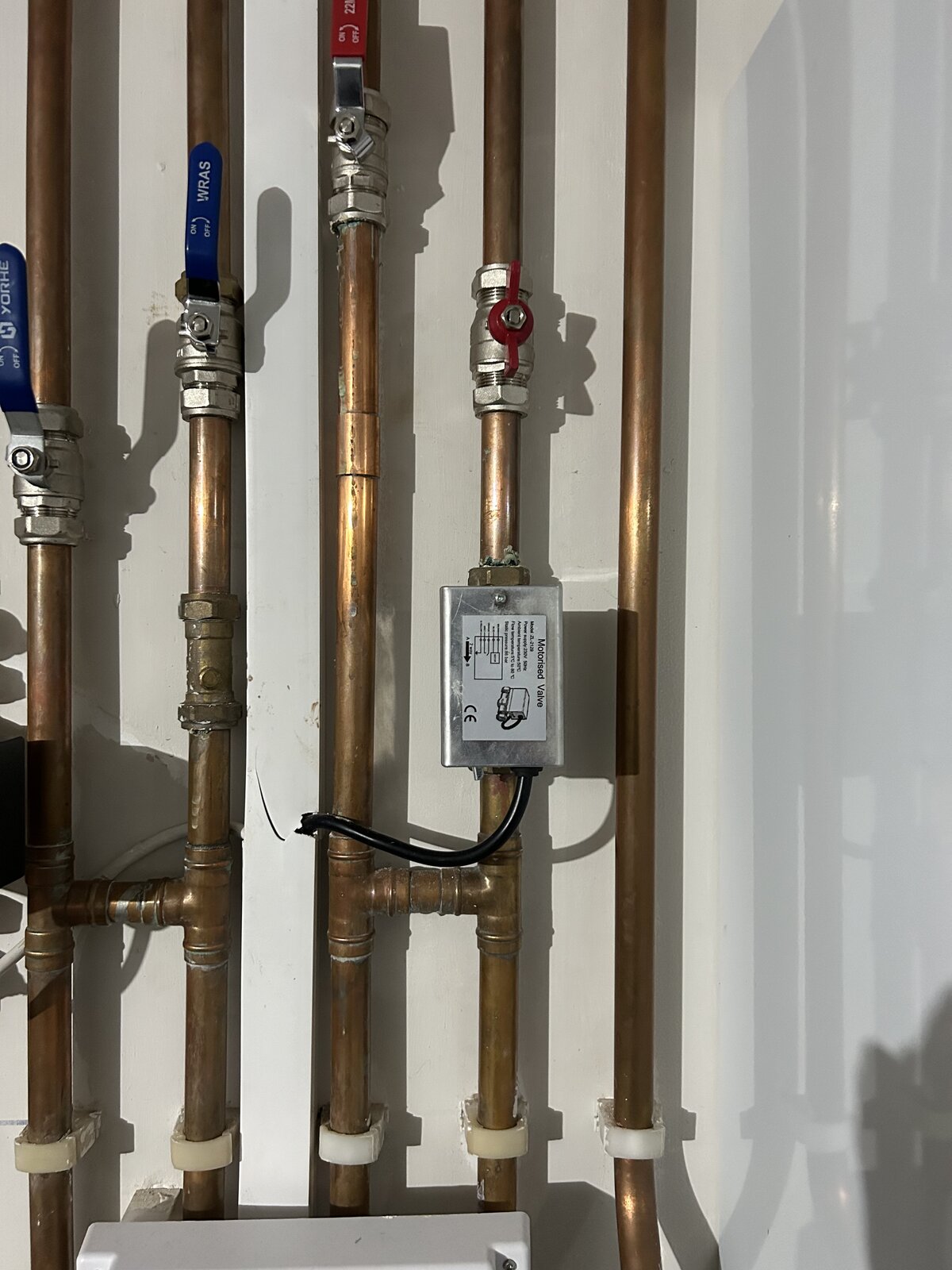

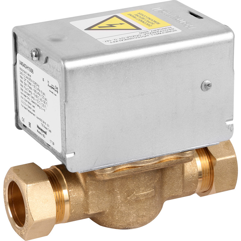

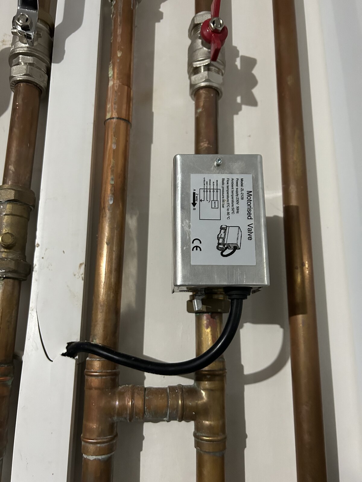

The ones that have motorized valve written on them, if the rads are above that valve shown above then the arrow on the valve body must point upward. (I think it is judging by the wiring).

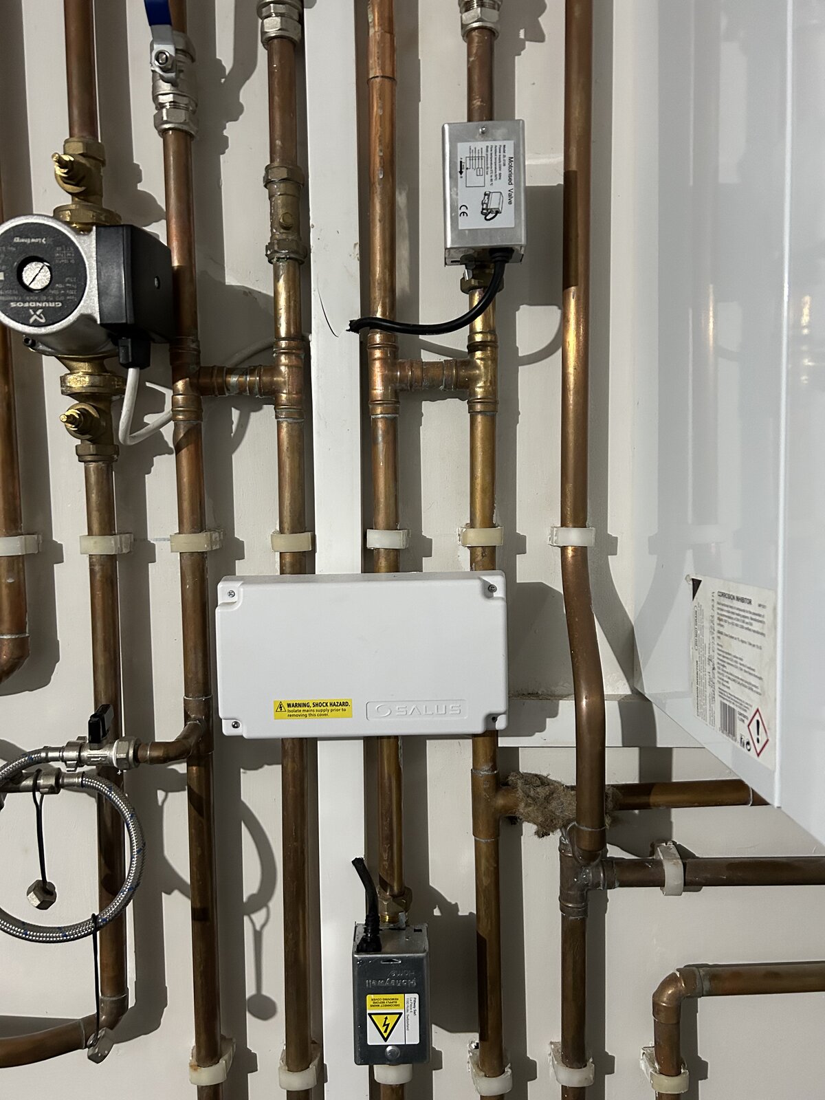

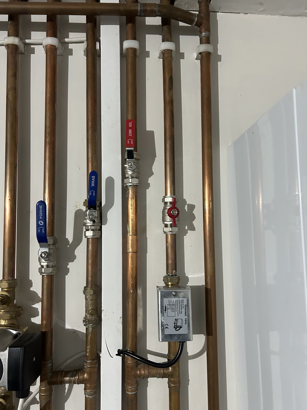

Hi John

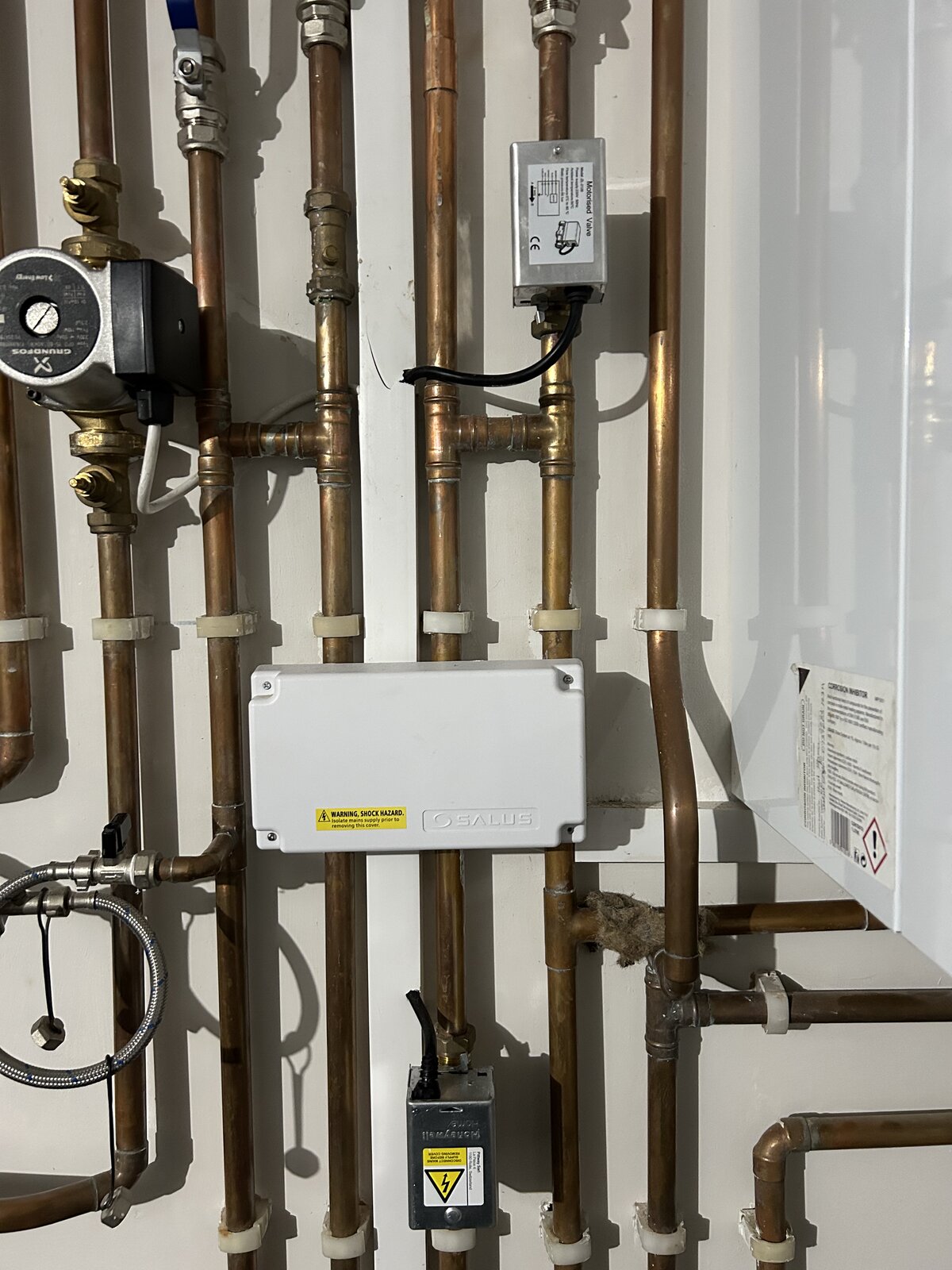

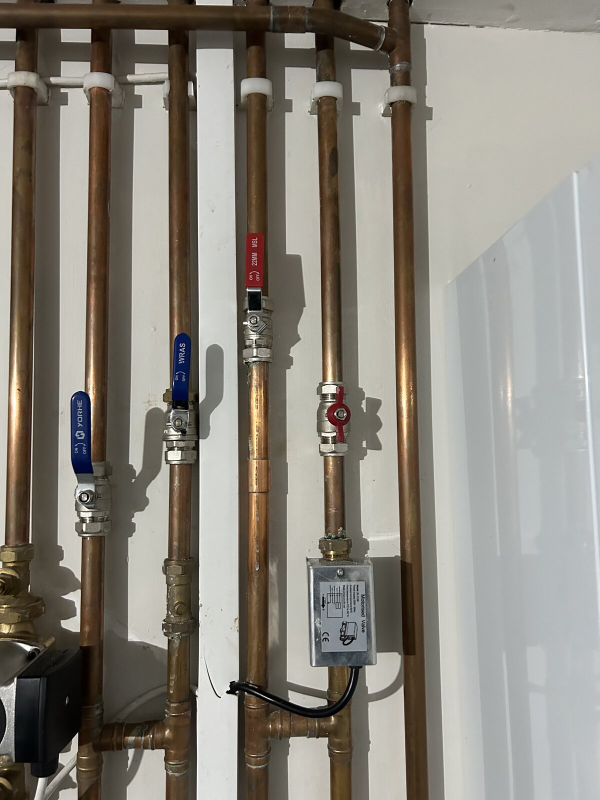

Here is some clearer pictures.

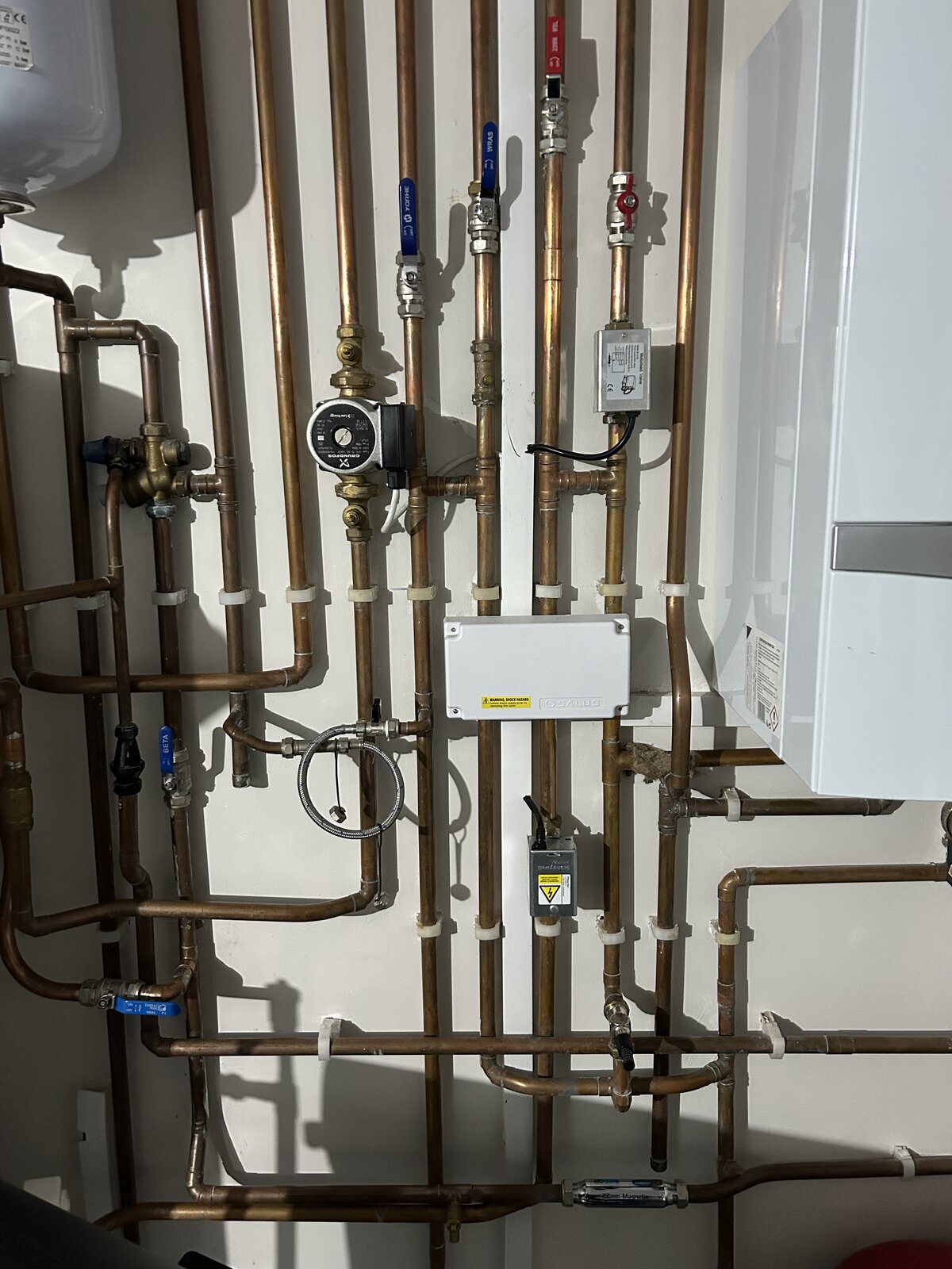

Hi
No noise comes when the hot water is on and nor does it happen when the UFH. I mean I describe it as a foghorn but its hard to tell its like a rattle more than anything else. Here is the video:
This noise will only ever come happen when I put my upstairs heating on for 5-10 seconds and then stops.

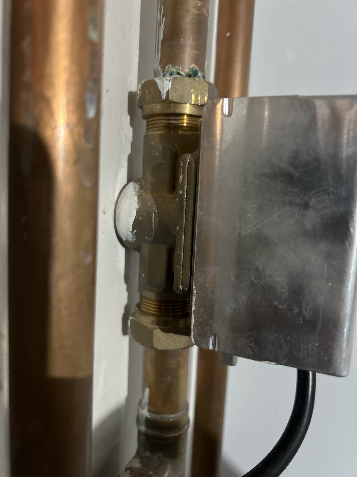

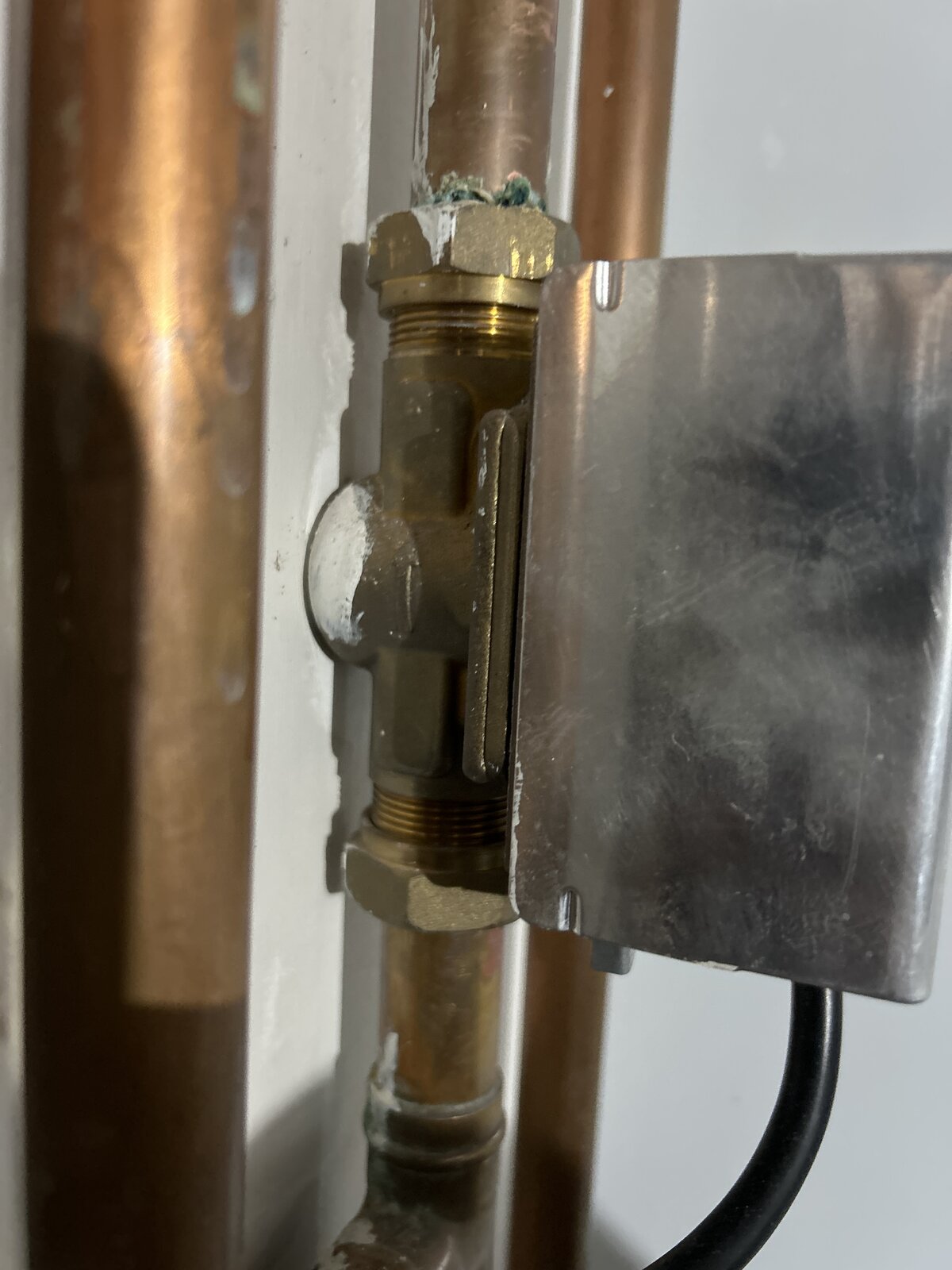

OK, see post #31, you can see the arrow on the side of the valve, you will just have to look at the side(s) of your one, it should be pointing up if the rads are above it.

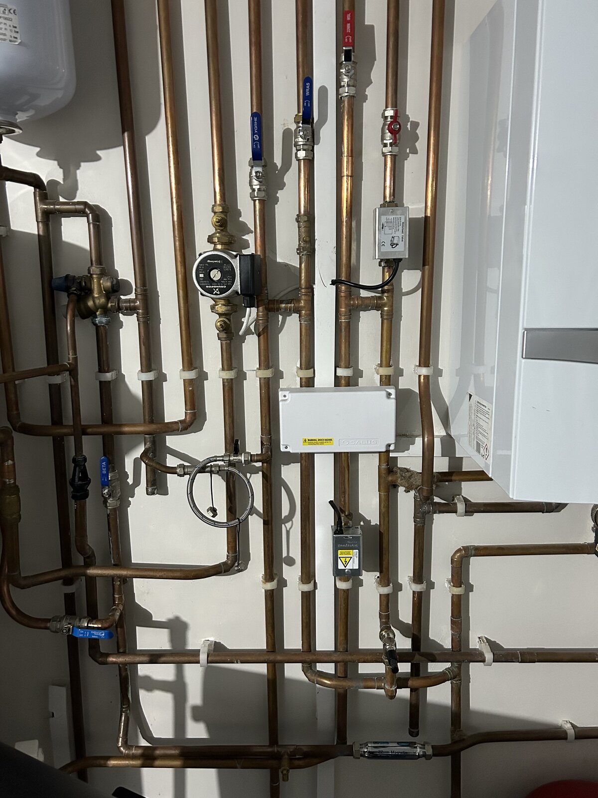

Hi john sorry for being dumb. Yes arrow is pointing up and the radiators are on the upstairs floor.
Iv also attached a wider picture of my system for your reference

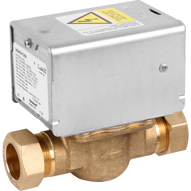

Try this, for good measure!! (can't think of much else)
Ensure the ABV is back at its original setting of 0.3.
If the U/stairs heating is on, switch it off.
You will see a lever like the one below, pull/push that right over (you will feel a little resistance) and then pull it slightly towards you, it should latch in..in the open position.
restart the u/stairs heating.
Hi John,
The moment I even moved the lever the noise just started, I wasn’t even able to get to locking it in position or switching the upstairs heating on.
What did I notice is that once the noise happened, I put the central heating on 30 seconds later (the lever was back in the original position) and the rattling noise was less faint. It’s as if it needed to get that noise out and then it can function? However if I let the system cool down for a few hours and then switch the central heating back on, the noise will return as loud as ever.

Sorry john its a vailiant ecotec plus 637

Hi John
I just tried this. I kept the boiler off for 10 minutes and my heatmiser app had all the zones (including upstairs heating) as offline.
I pushed the valve open and I then restarted the boiler. No noise occurred. However, I have to switch on the central heating through my app and annoyingly when its been offline and switches back online it defaults to a 21 degree setting so a few of my zones were online. However I think I caught it just in time, but can’t be fully certain.
AVB is on 0.3 and as mentioned no loud noise when i pushed the valvle open. I then switched off the central heating and the valve went into close mode? I then put the heating back on 30 seconds later and the valve stayed in the close mode but boiler made no noises again.
Well it seems (not surprisingly, I suppose) that there is no noie if the u/stairs zone/motorised valve is in the open position when the boiler fires up.
Qustion is why the noise when asked to operate normally, I don't know really, someone else on here might comment on this??.
