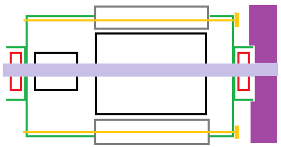

If the OP's motor is like what's in this video, both bearings should be accessible. I think there's only a nut at the metal impeller end holding the shaft in place.
This video gives a clue on how the vacuum chamber is structured. The nut is the only thing holding the shaft in place. Everything else slides off.

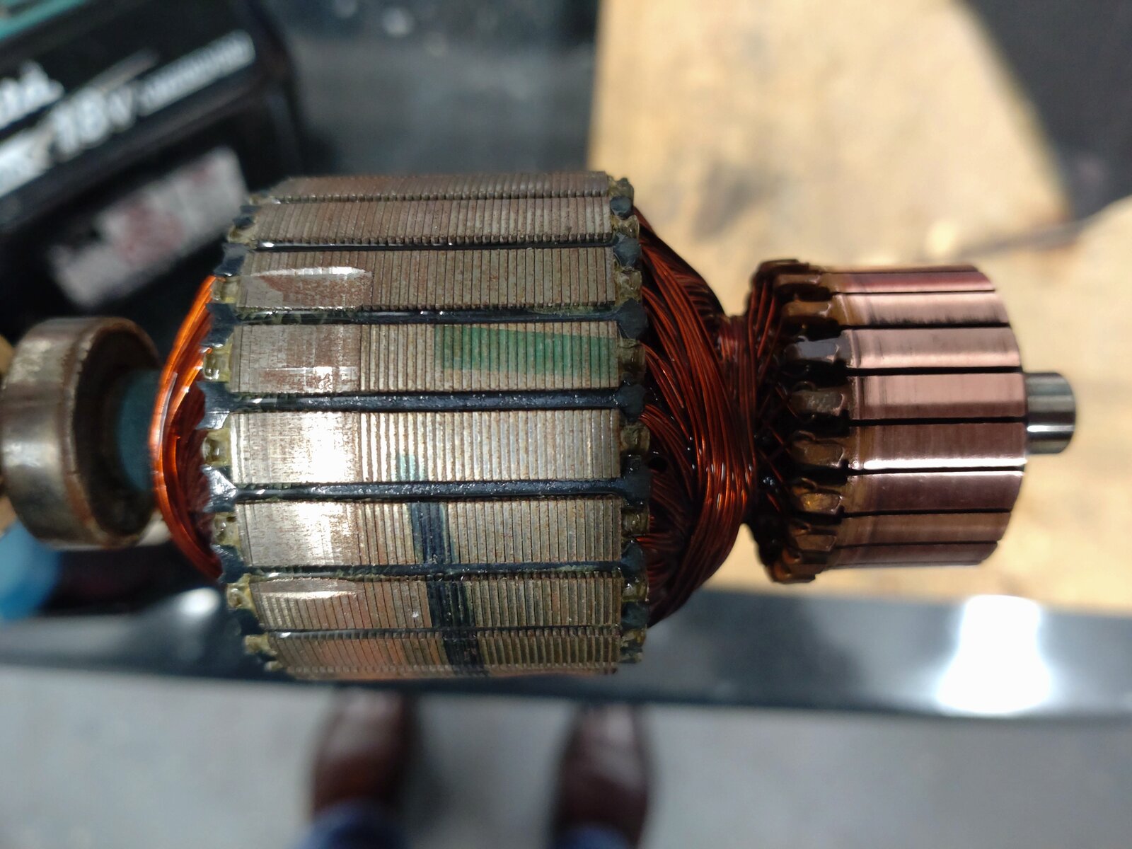

The suggestion to use a hex extension bit was perfect, thank you. I got the rotor off and it cleaned up easily. I put the axle into my drill and spun it against 320 grit sandpaper. The copper comes off fast and the commutator bars look clean. I also checked with a screwdriver that none are loose.
The bearings are fine. I took the opportunity to clean them with WD40, dry and then repack with lithium grease. Lucky as the top bearing drifts off easily but I couldn't shift the bottom one. Probably needs a bearing puller which I don't have.

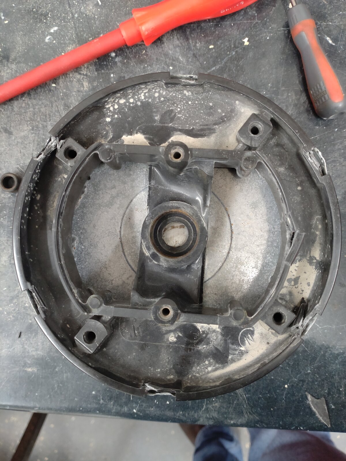

I took the motor off the impeller unit. It spins without shaking, so I suspect the imbalance is in the impeller unit. There are two divots on the armature but I suspect those are intentional for balancing rather than any damage?
guess the next step is to lever / drift off the impeller casing, clean, and reassemble.

Have you cleaned between the copper segments with a pin?
