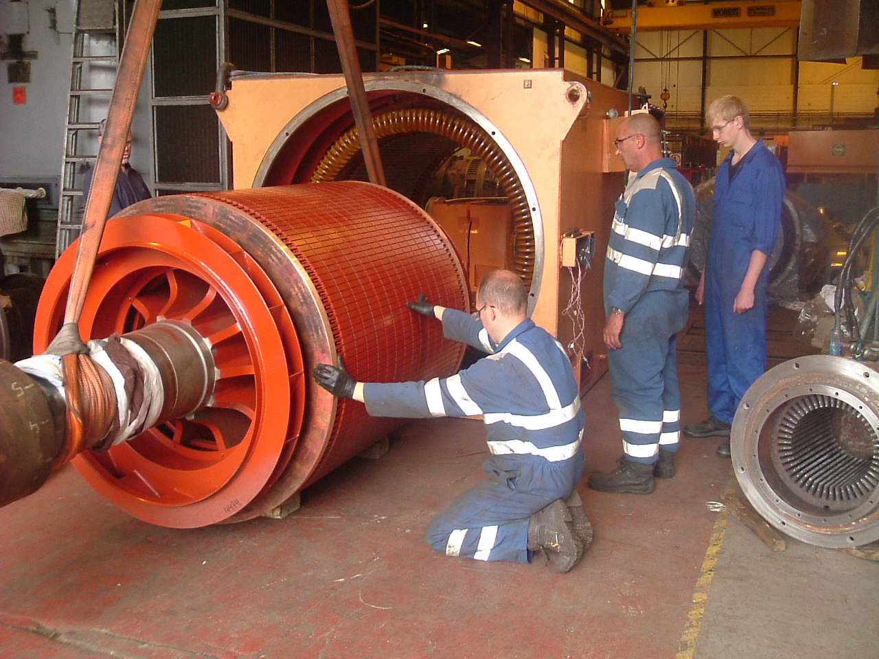

Some of the lads I worked with used to back cut but I was taught to do it forwards and couldn't get out the habit. Last worked on AC motors about 5-6 years ago. Medium sized DC about 10-12 years ago. Last large DC in 2012 when I had been seconded to our Chesterfield branch to help them out. Ostensibly for 2 weeks but ended up there for 3 months working on these beasts. Second pic is complete re-bar of the squirrel cage rotor, (can't remember the kW size but probably near the 1,000 mark). I was operating the cranes. That armature certainly doesn't belong with that AC stator. LOL
