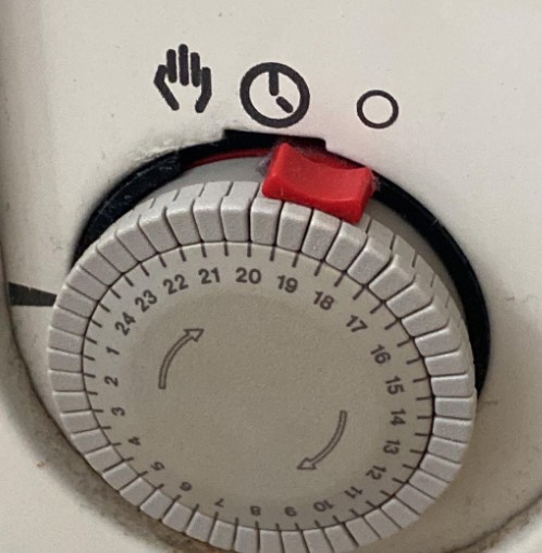

My daughter is getting very high electricity bills in her tower block flat. These predate the recent increases, so God knows what they’ll be now…
She spoke to an extremely rude and unhelpful woman at SWALEC, who told her that the excessive consumption was at night.
She’s on some kind of dual tariff (Economy 7 type, I guess – she’s spectacularly ignorant of these things), and there are two things which concern me:
(1) Her immersion heater doesn't appear to have any kind of timer on it – is this possible? Could it be running all the time?
(2) She appears to have 3 storage heaters, but says she only turns them on occasionally if it’s very cold, which isn't often. I’ve attached a picture of the control on one – she turns it to the left symbol (manual on?) when she wants heat. But surely, for it to give out heat, it would have to have been charged up at night first??? Does this mean that she’s paying to charge the rads every night, then not using them except when she occasionally wants heat?

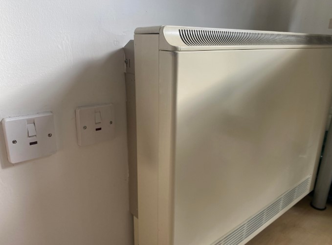

Does this look like what you're suggesting?
The picture in your first posting looks to me like the controller on a panel heater rather than a Night Storage Heater. The switch is in the 'Off' position.
First recommendation is for her to switch OFF the 3 Night Storage Heaters in the consumer unit.

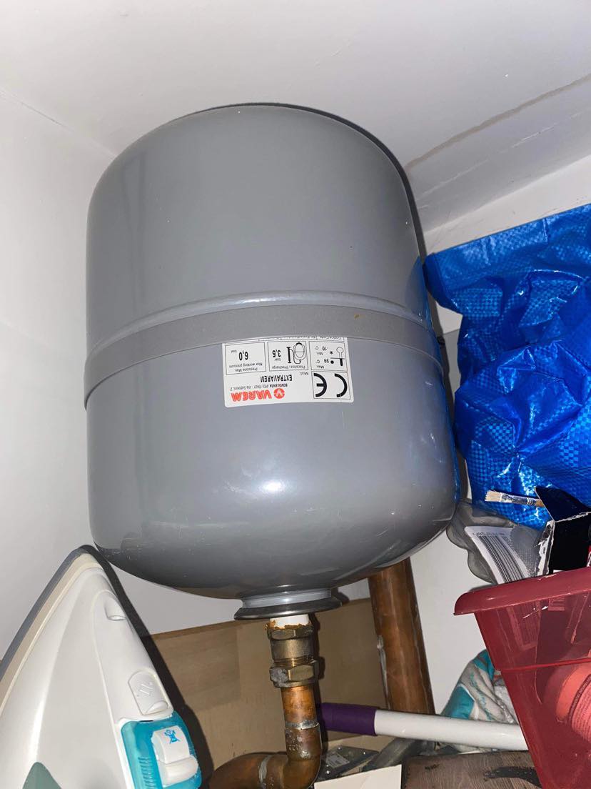

Expansion vessel for the Central heating , the heating is pressurised and this vessel compensates for changes in pressure when heating hot/cold
Just one problem... the block doesn't have central heating :ROFLMAO:
Yes it does, 1 switch does normal and 1 is the storage, looks like they have lights on them, you may find 1 lights 24 hour and the other only during off peak, that would need to be on for the storage heaters to charge overnight.
If she looks under the gap between heater and floor she should see 2 flexes into it, if its a dual unit.
Then again without seeing more of the heater it could well be just a convector heater with the storage switch not connected at all
