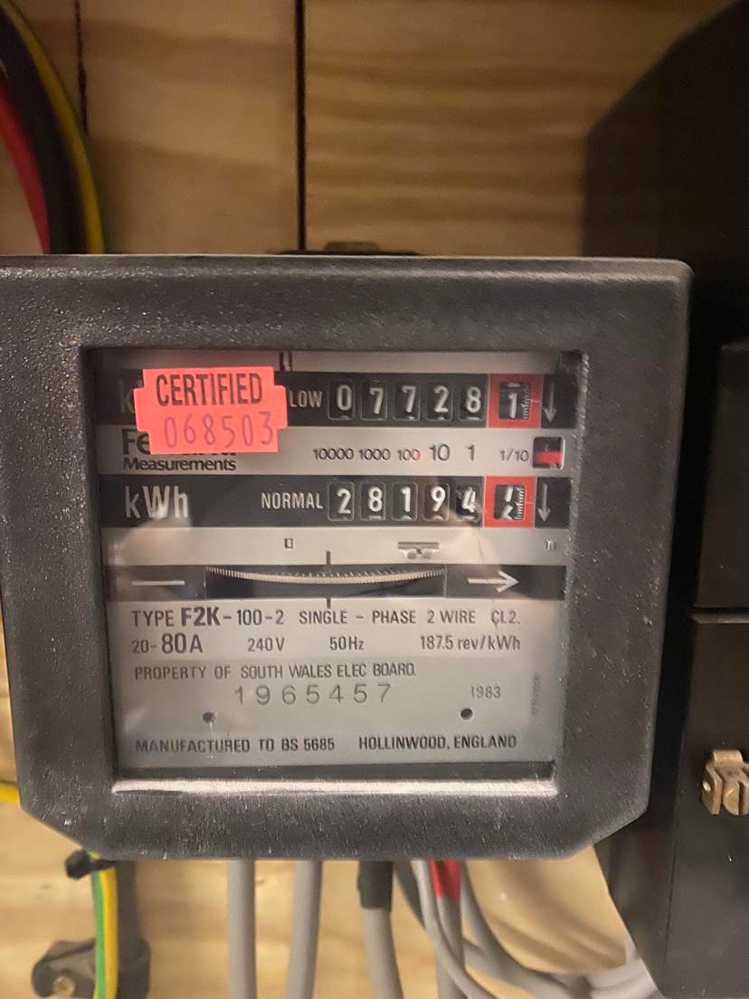

Given that SWALEC have told her the heavy consumption is at night (yes, she has two meters/dual tariff), and the storage heaters are never switched on, I can’t see what it might be except the immersion heater…anybody think different?

Here's a picture of the meter... is it possible to tell when the switchover takes place?
I suppose she could switch one of the storage heaters on, and watch for when the switch lights up...?
you may have a clock in the same cupboard, we had , also i have seen a clock on digital meters - which switches over to the Storage heater consumer unit.
Which you may have
But there are radio controlled switch over units
The immersion heater may have 2 elements , 1 is controlled by that CU , and a 2nd which is at the top of tank for a boost
you should see the small disc spinning
If you turn off the Storage heater CU, that may slow right down , depending on time of day and whats on
just boil a kettle and you will see it spin a lot
1983? I thought they had to be changed every 20 years? I do not know the meter, however returning to main question is what tariff is she on? Just because it is a duel tariff meter it does not mean she is on a duel tariff.
I would turn off the CU with the 4 x 16 amp MCB's then middle of night say 2 am, check if electric meter is turning, then turn on the CU and recheck. I think output of heaters may be off, but input is still on?
I will guess she is not on a duel tariff which would explain high cost of electric.
That appears to be a Sangamo Teleswitch to the right. There is a small red lever behind the glass which shows the on/off state of the off peak. Also the red indicator near the 1/10th indicator on the meter shows which set of dials are active at the time.
