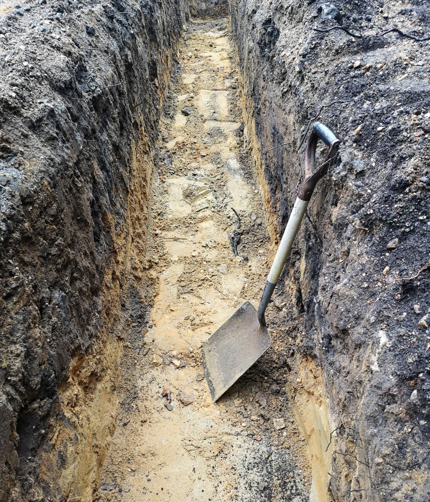

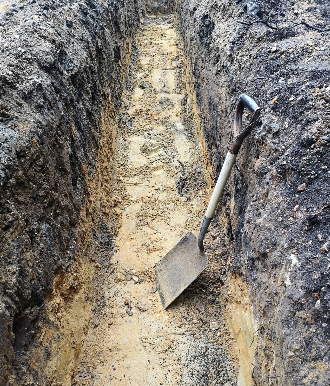

was out there today for a bit, well another 3+hours, managed to cut / release that cranked steel beam..........9 x cutting discs and a monkey wrench and a 4ft of tube. broke the rest of the pond inhalf with a breaker ready for mr diggerman to pull out tomorrow and hide it in another pond im filling in. Building inspector here tomorrow to have a look at the digging for footings ....fingers crossed

Yeah hopefully get going. Looks like and sounds like you've had some serious grafter to do on that. Have a think about the future before filling in that pond. I buried those yorkstine flags and tarmac then later tried to put anchours in for a swing/slide thing. What a nightmare.

ALL doug out sleeper foundations removed concrete ordered being delivered Fri

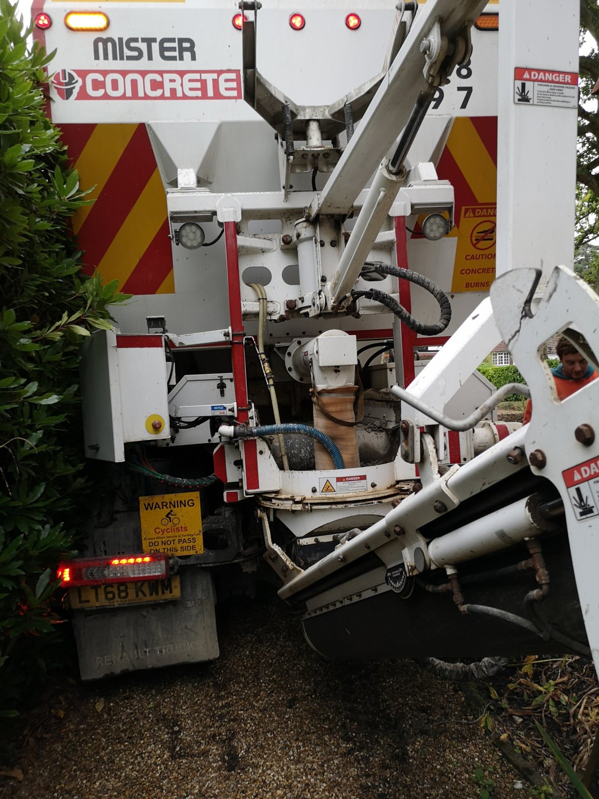

It's concrete day.

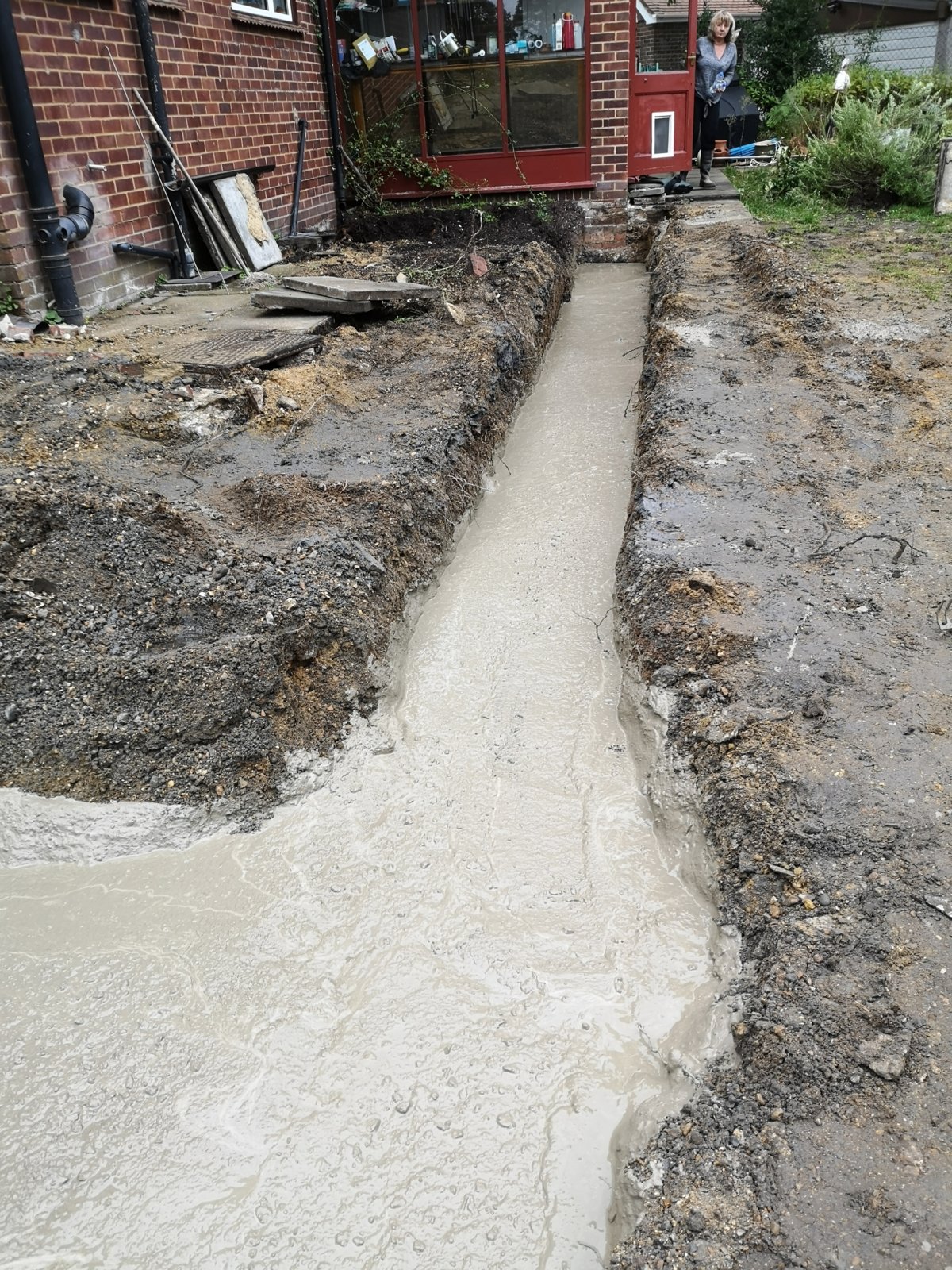

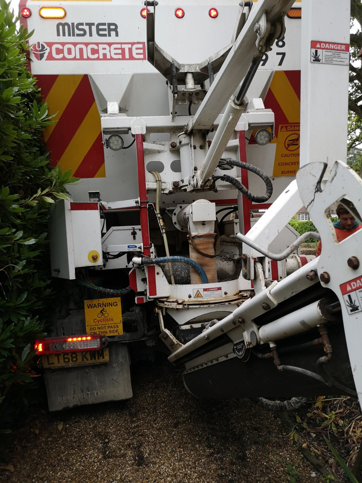

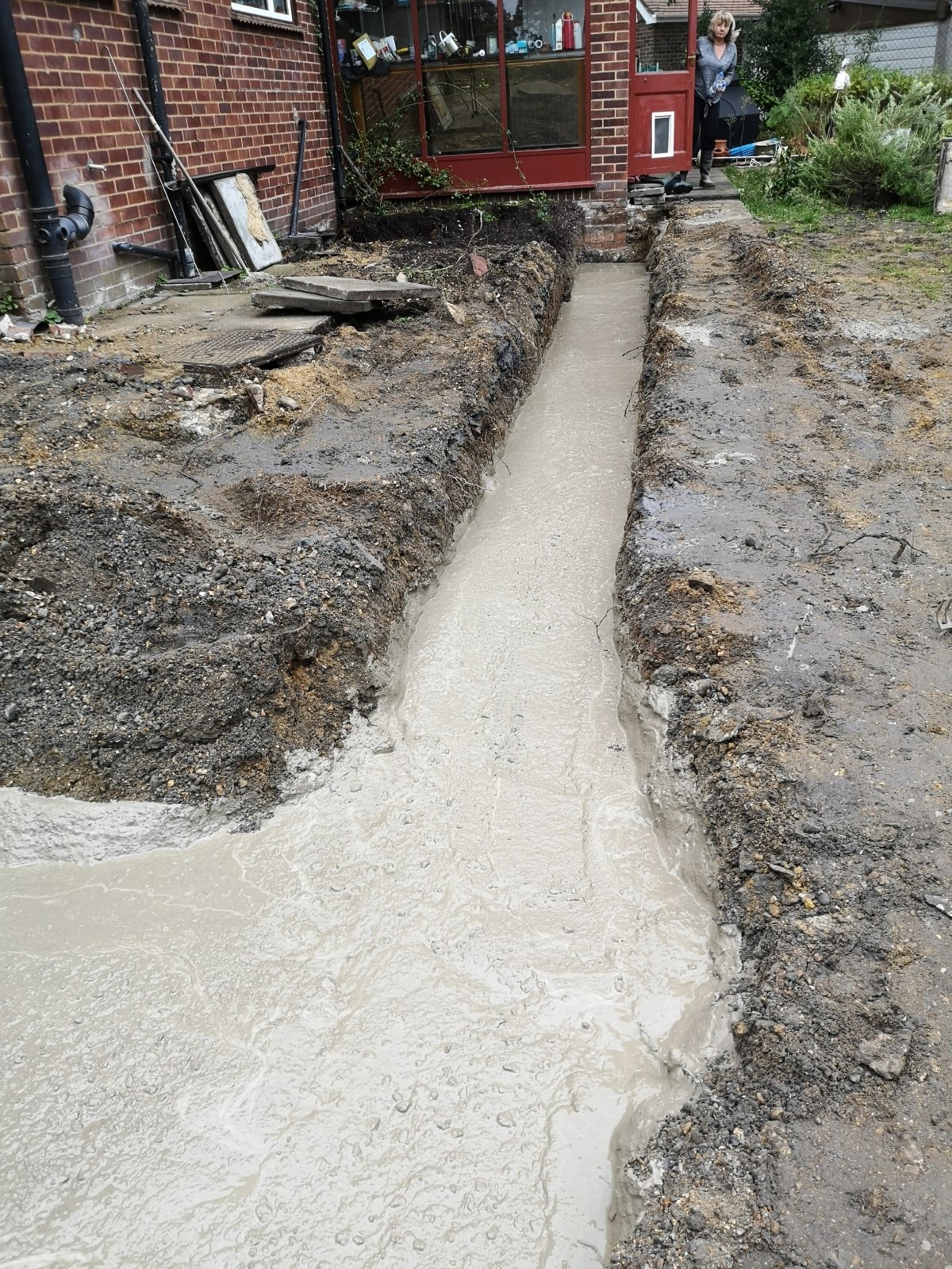

The lorry turned up after 3pm and sorta managed to get near the dug footings, he had a 4m shoot, shame as I'd hoped it'll be nearer 5.5m as they said on the phone when I ordered. Still a bit of ply and 2 battens an we had another 2.4m on its reach.
Incidently the cost of concrete....... I was quoted £130 plus vat per meter cubed by one supplier and got it for £88 plus vat per meter cubed, pays to ring about.
He dropped it in the short 4.5m return and I had to pull it down the 10m run...... Not easy, in fact it was a f%@#ing nightmare. The lorry driver was a Saint and helped out. We barrowed the last half a cube in by hand. Boy did I feel it after that..... Some painkillers and a beer.
It's taking shape, what shape I've no idea but now I don't have a hole to lose me dogs in or reinact the trench warfare of the first world War.

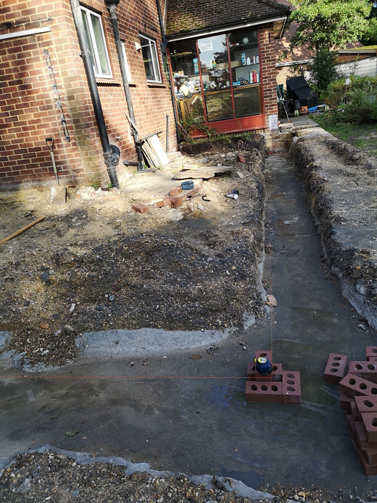

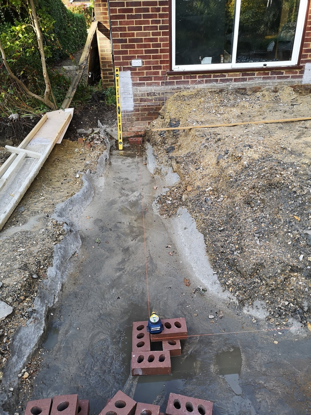

I've set up a string line 300mm in from the outside wall this will give me the inside wall face, 100mm brick 100mm cavity 100mm block as per the plans. I waited till dark and popped a laser level on it and its straight.
Now the bricks where is the best place to start laying them, from the corner and work back to the house or house to corner and then 90degrees to house again
Also, I need to go up about 10 courses in engineering brick to take the block and beem floor, would it be better to do that in foundation blocks (440mm x 300mm x 215mm) I'm not worried how it'll look where the ground is low as I'll be building a deck outside.
Cracking on i see. Just looked at my extension. Builder has done row of foundation blocks then engineering bricks before damp proof course. With the blocks being bigger i'd say you'll get a nice flat level squared frame to work off.
By the way. You cutting into the house brickwork or using wall starter ?
I would lay them all out dry first to ensure the bond is correct and then i'd start from the corners and work back to the house. You may need to adjust the perp joints slightly or even put a cut or two in.
