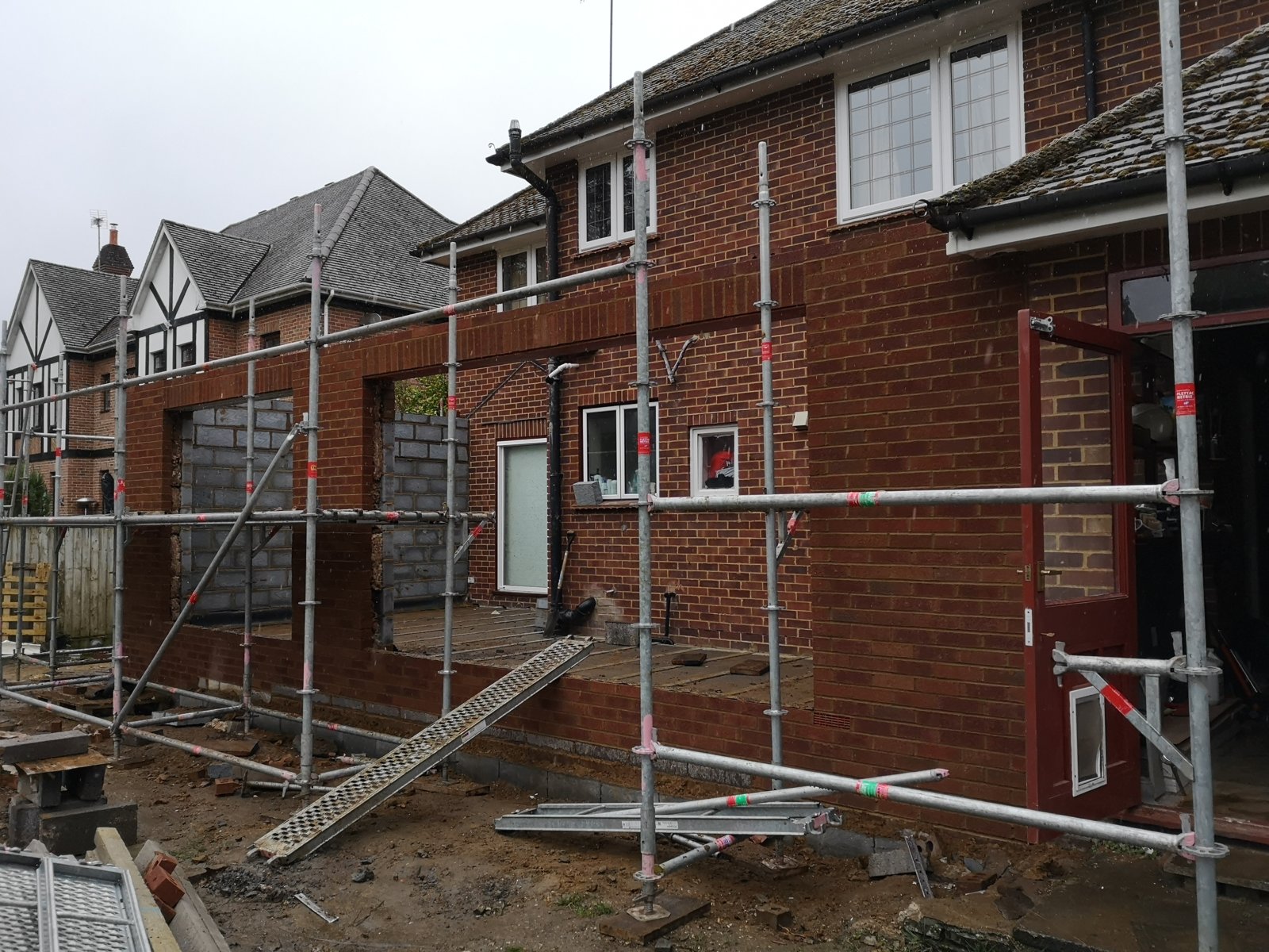

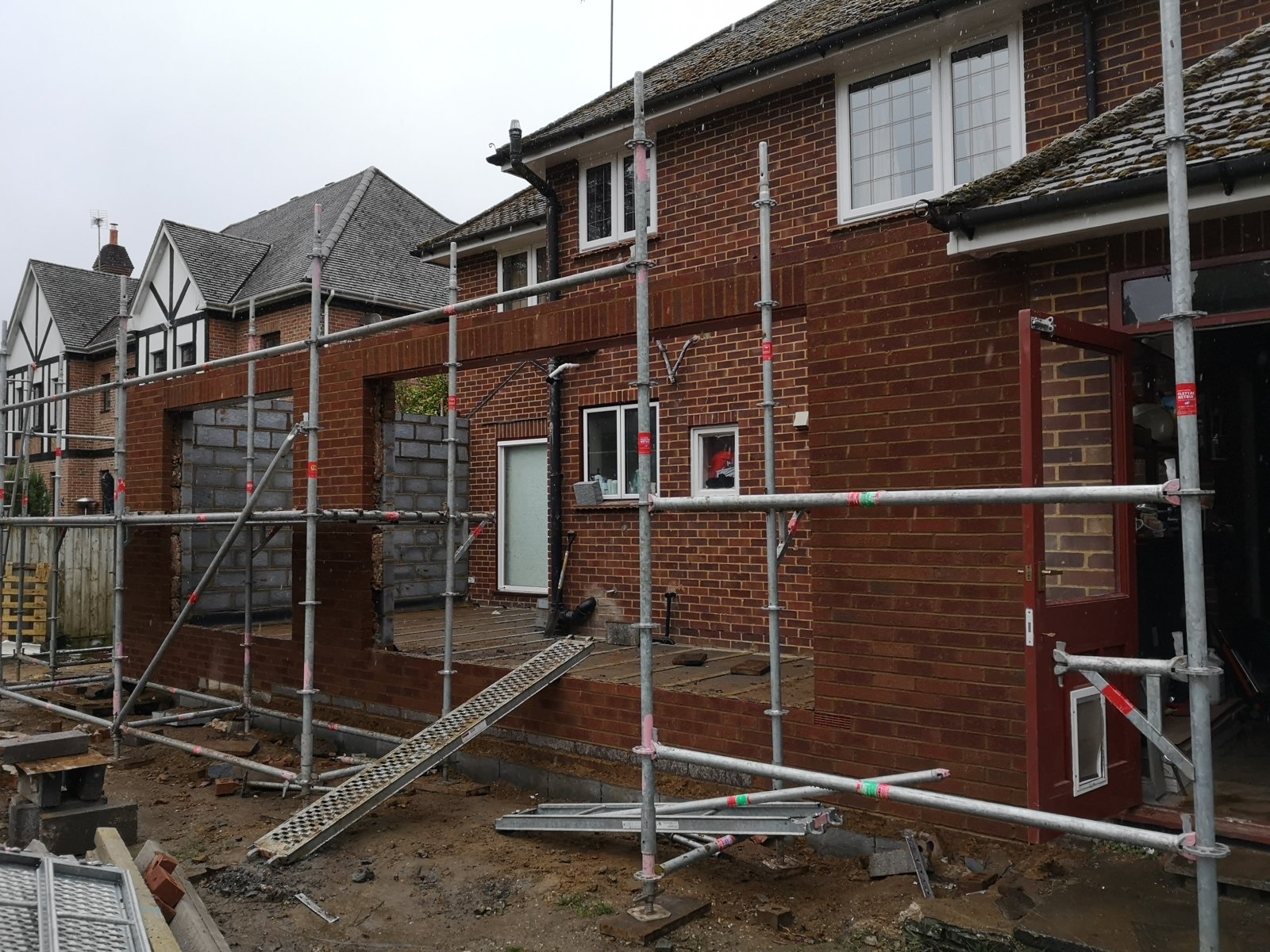

Today I have been mainly taking scaffold down and putting up again.
Brickies done well, as its all done, steels are in
Showed them the sack barrow trick to move the steels..... Impressed, one nearly stopped moaning....... I said nearly.

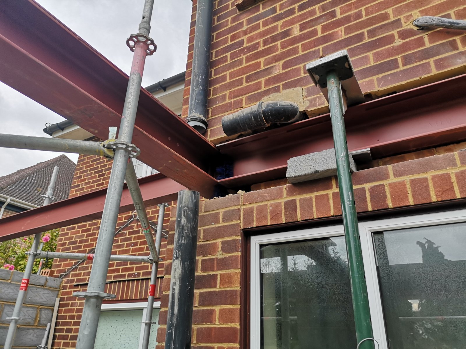

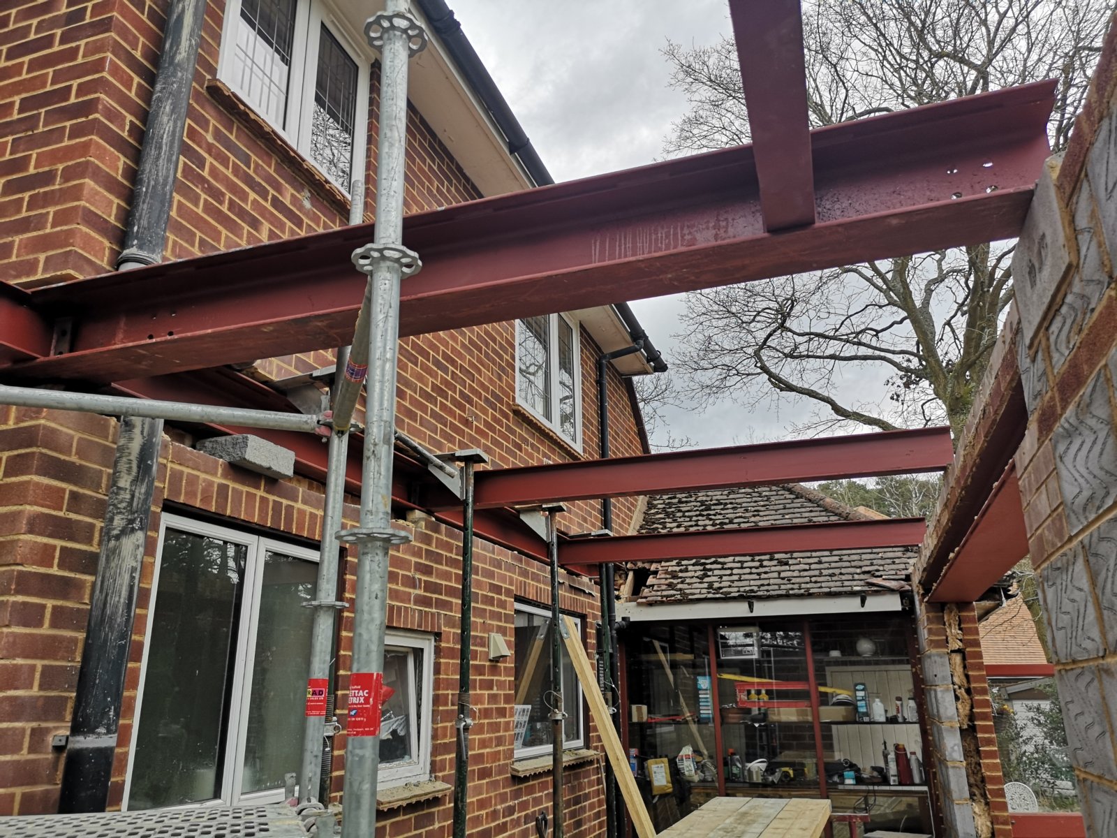

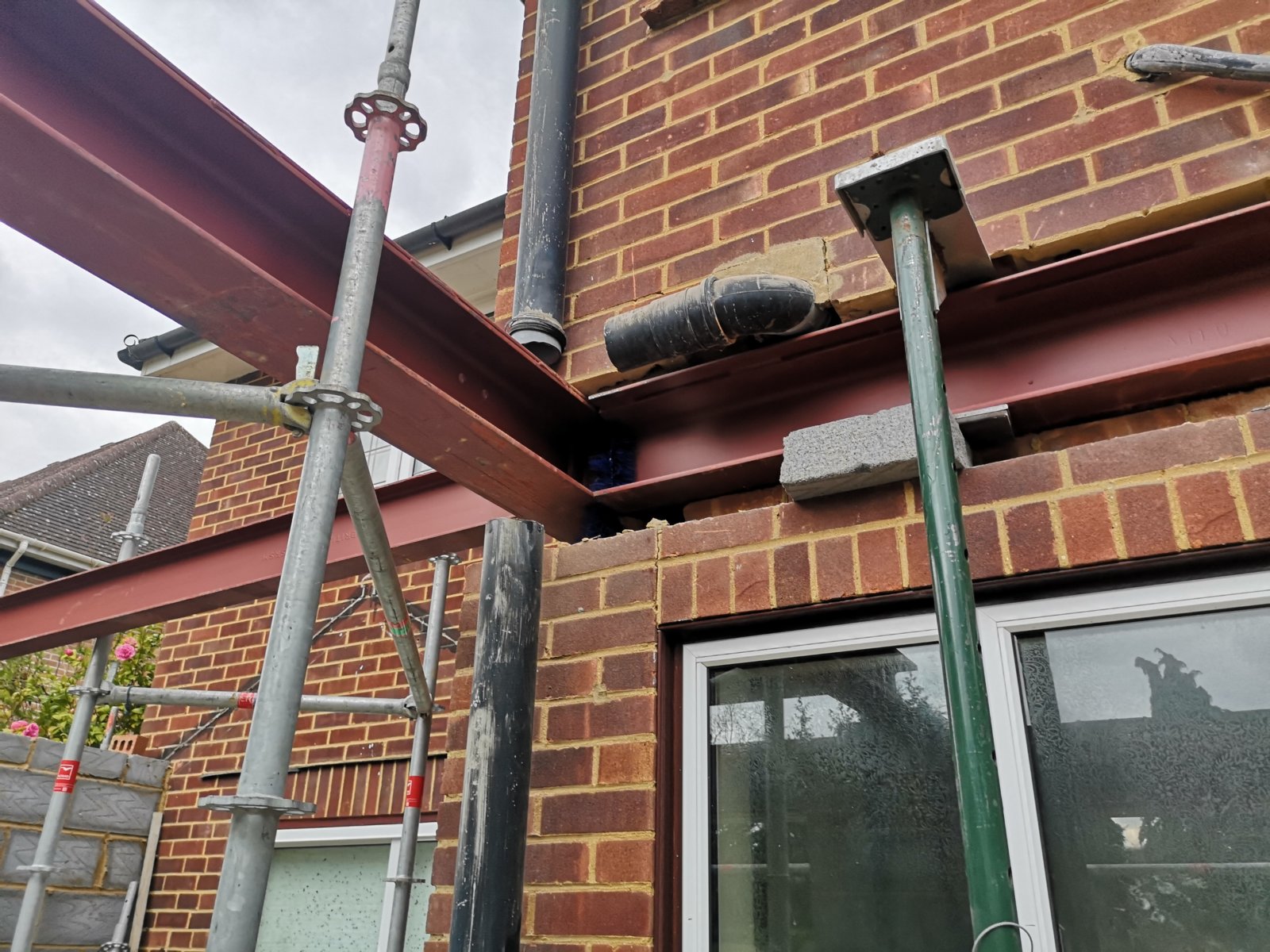

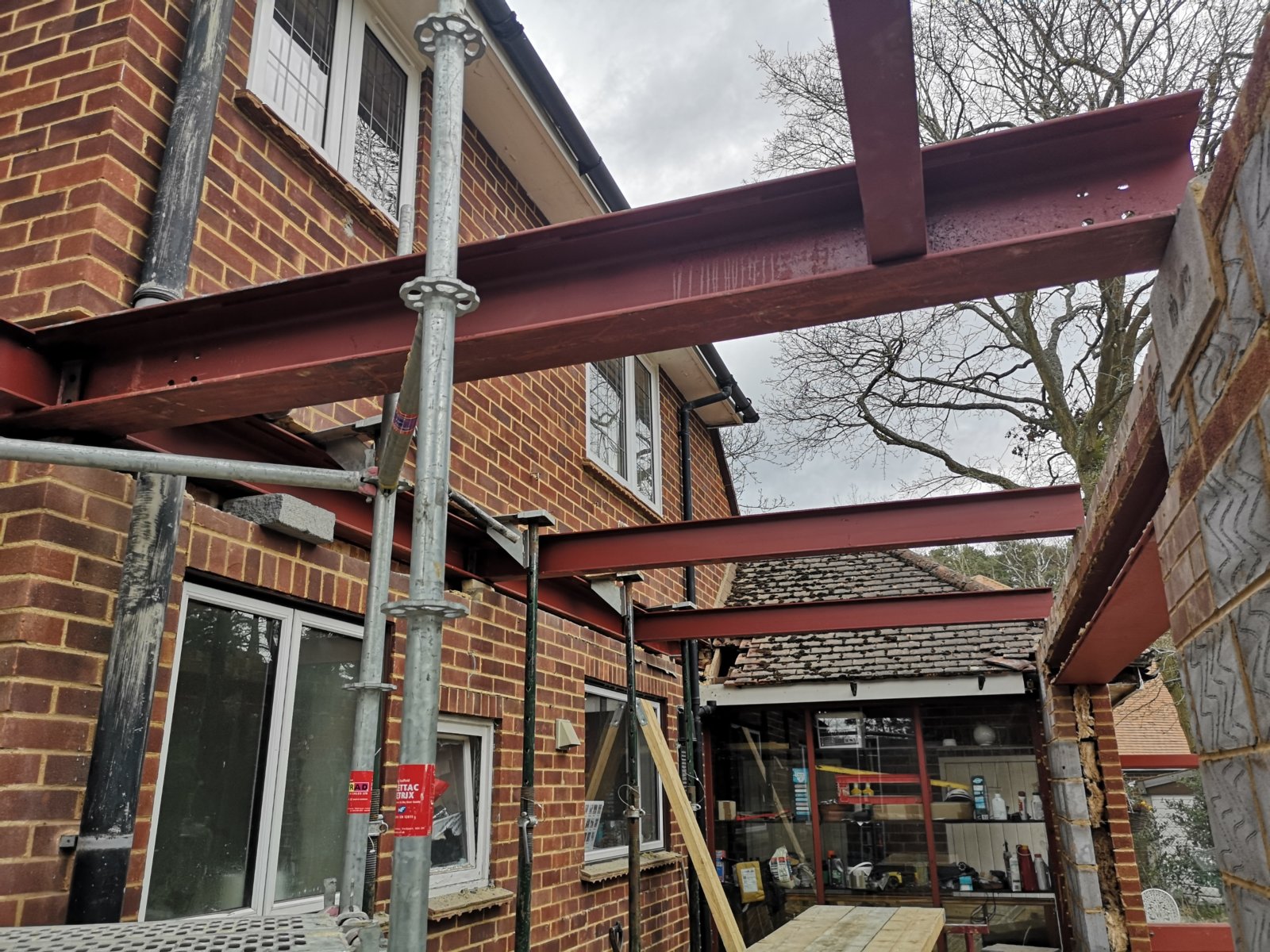

Steels are in.
Was a big job, glad I got someone else to do the supports and making ready.

Looking great - I have been watching this thread with great interest.
Out of curiosity how long is the span of the steel that is holding up the existing upper floor. I have a similar detail on my extension and have had a few queries how to get the steel (circa 10m) in around the temporary works. Did you sit the steel between the house and the strong boys before propping? If so was it a drama lifting the steel between the 2? or did you come in from the side.
The span is just under 6m the steel is 203x203x53UC. There's another at 4.8m that picks that up to form a T.
We came in from the side for the 6m one
Cheers. so an 11m span over 2 steels? We don't have side access which seems to be causing the issues.
