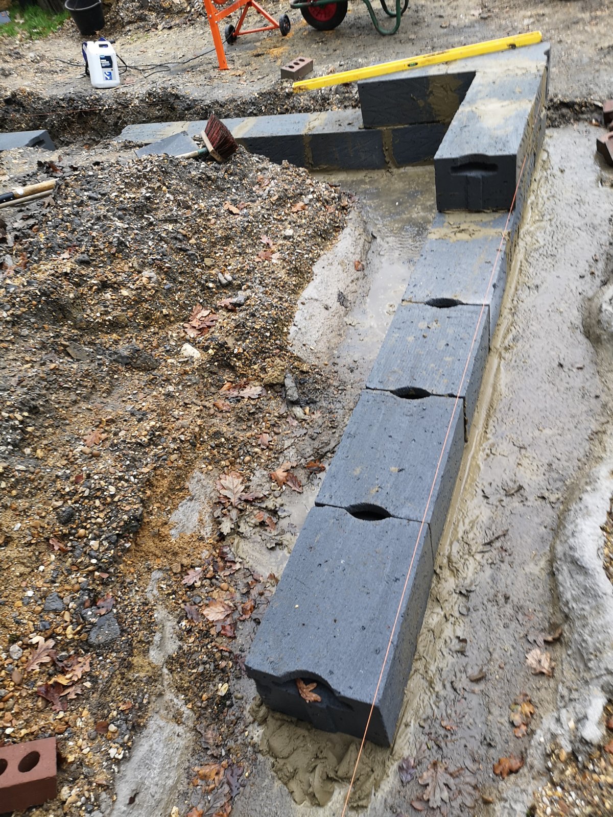

Well today was the only day the weather was clear, and temp was 8 or 9 degrees, so I thought time to get them Trench blocks set in and finally get above ground. My wife was out with my eldest for a few hours so I thought who's gonna know.......
I bought a cement mixer from ebay its only a 63ltr one but for under £100 delivered so I thought it'll be great for what I need down the road, here's the rub.... You can't get a barrow under it to tip the muck out...... Chinese cement rovers 1 scaff argyle 0
So the Trench was flooded by 4inch of water, pretty std with the rain of late, I had an episode where the drain had blocked, the manhole had backfilled and overflowed into the Trench about 4 weeks ago. It was just dirt blocking the pipe and the drain rods at full 6mtrs just got it.... I was like a one armed man at a shuffleboard contest. Back to today I Emptied the Trench, dustpan into bucket bucket down garden, about 40plus buckets and it was in a position to get goin.

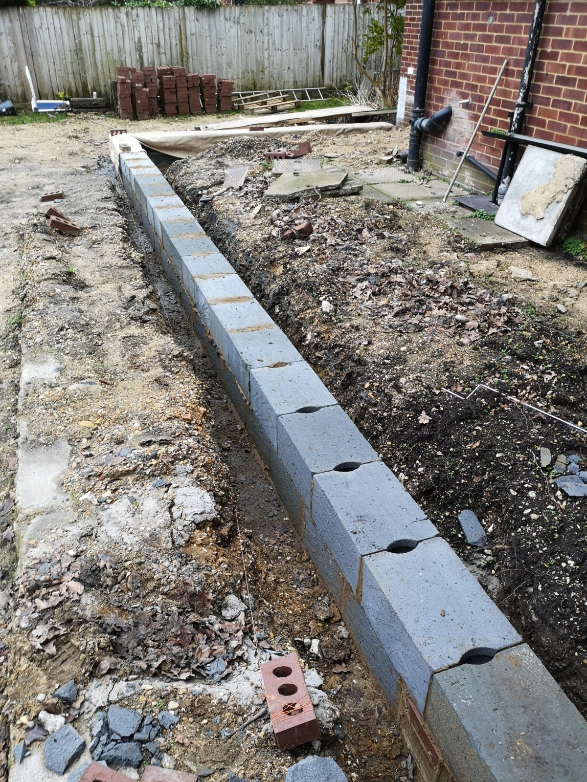

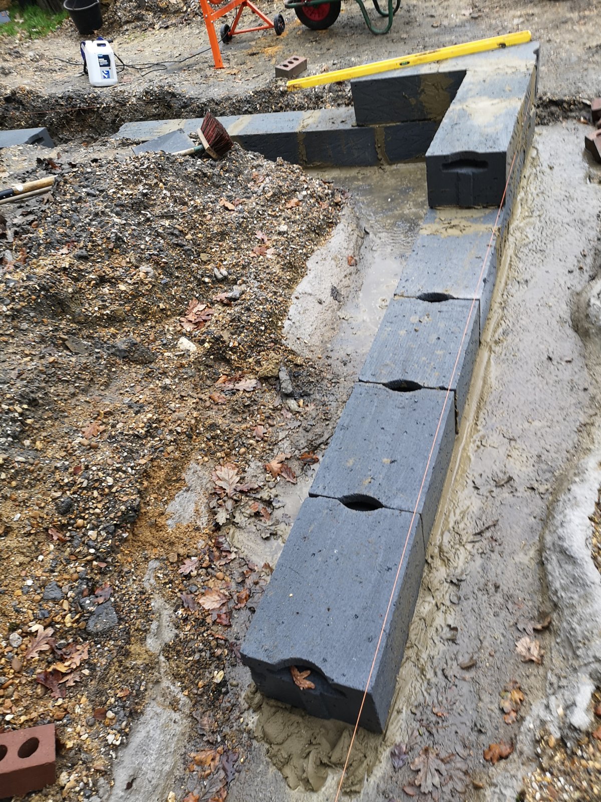

The Trench blocks were previously laid out, and wet, they weighed 23kg dry, wet was more than 24kg..........somewhat more, and with one hand fekin absolute dogs to move.
I got 15 of the 60 Trench blocks needed relaid and cemented in place inside 3hrs. So depending on what maths you use that's either 25% done or about 2 weeks of *******ing from the wife on her return.
I will say to all the brickwork maestros out there yes they Prob look rough as a badgers bellend, yes I could have been cleaner on the joints but as a one (left) handed newbie on the last diy moped to oblivion I think it's OK, and it's level, considering the footings we're not.
Anyway, all clothes in the wash, hose out cement mixer and clean up, tools back in their beds, bath and a beer just as they got home and she's hasn't sussed as yet. If I get away with this I may need to consider a job in the secret service.

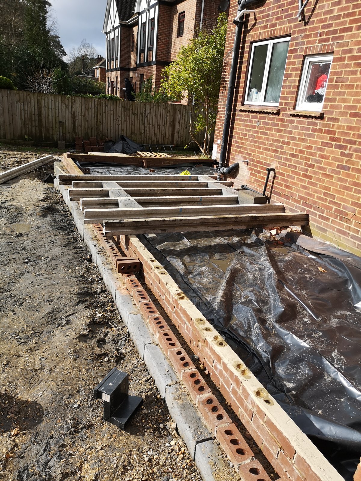

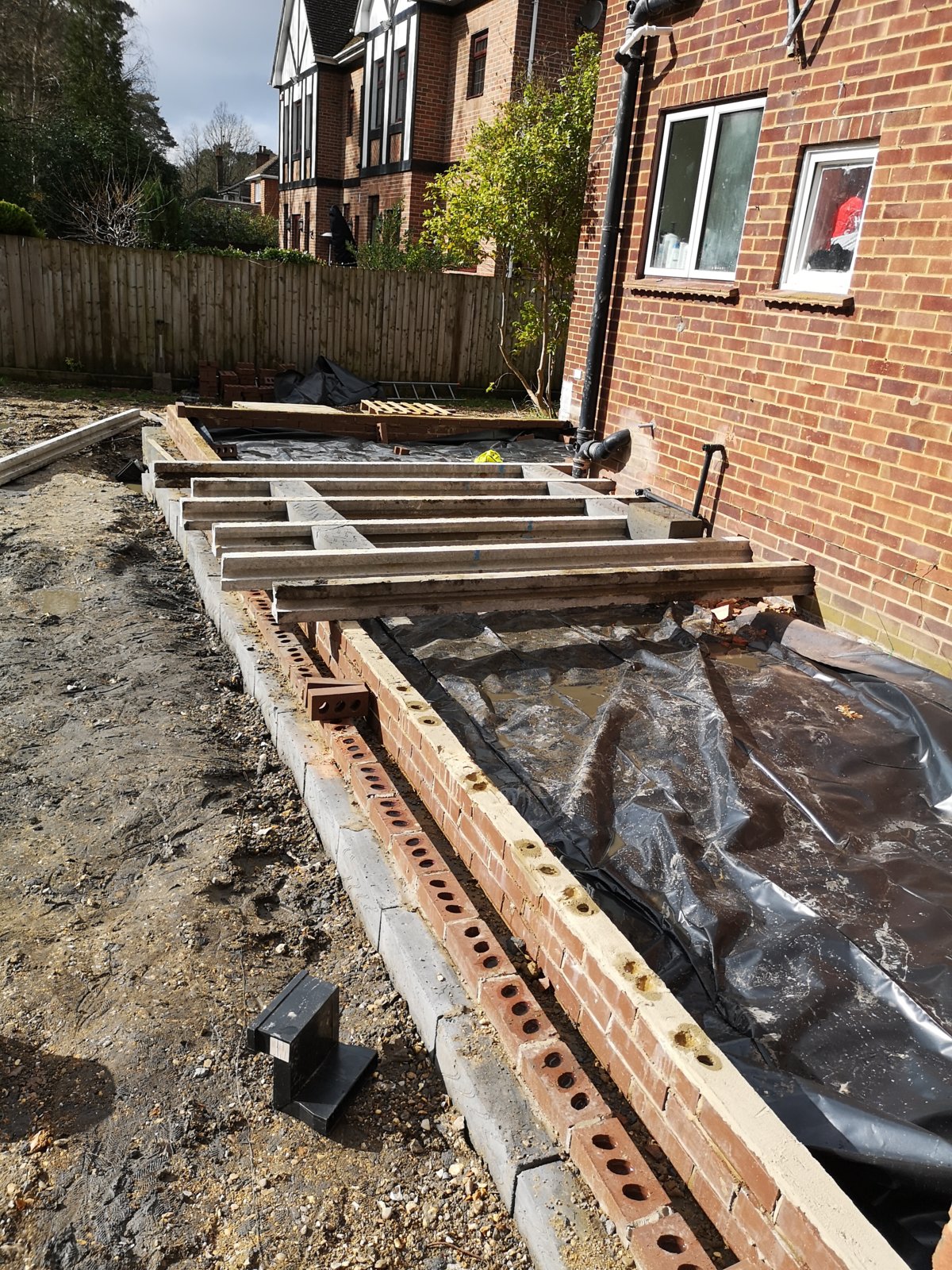

Just finished 2 days working on the extension, all Trench / foundation blocks laid, and I got 2 x courses of engineering bricks laid. One more course and I'll be the right height for the block n beam floor.
Need to get a wiggle on from now on as we want it up before Easter.

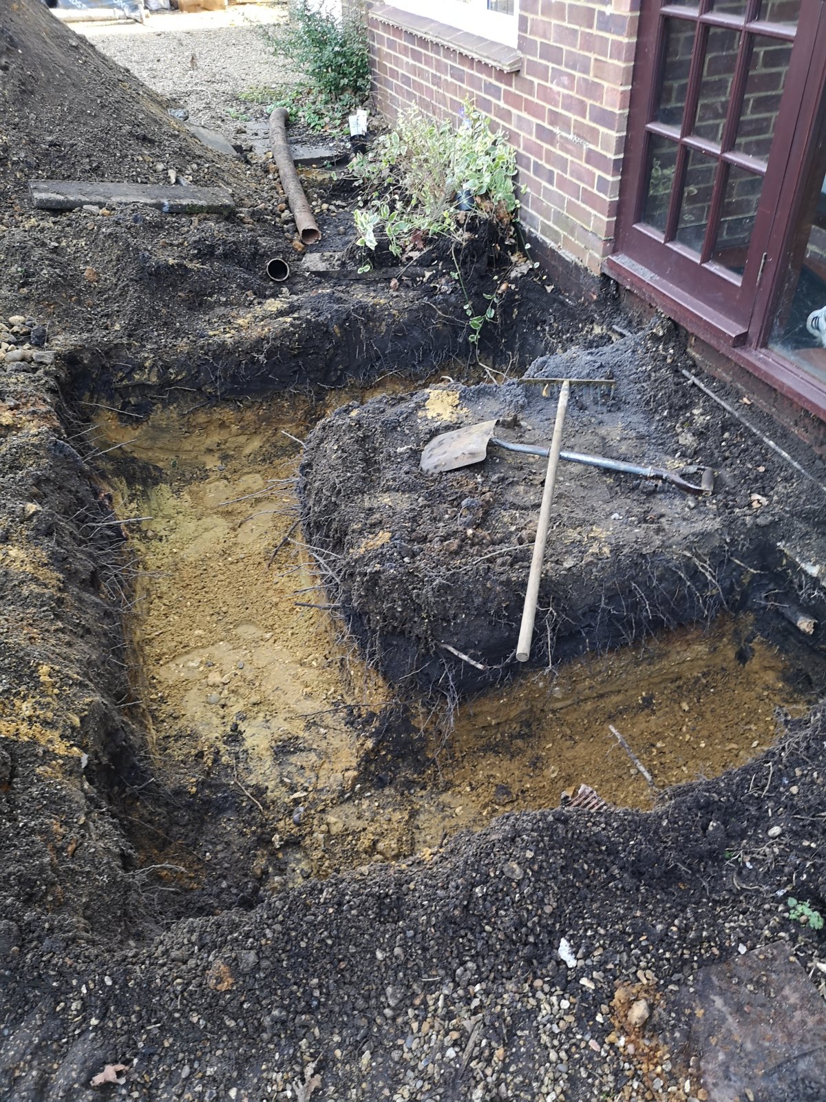

Well for a change I thought I ruin the front of the house today.
Dug the footings for the porch earlier, going for a half brick and oak job with new front door.
Size is 1.8m x 2.3m x 1.8m
No dramas other than a 15mm copper pipe with the gas feed for the lounge under the ground.
Concrete pour tomorrow.

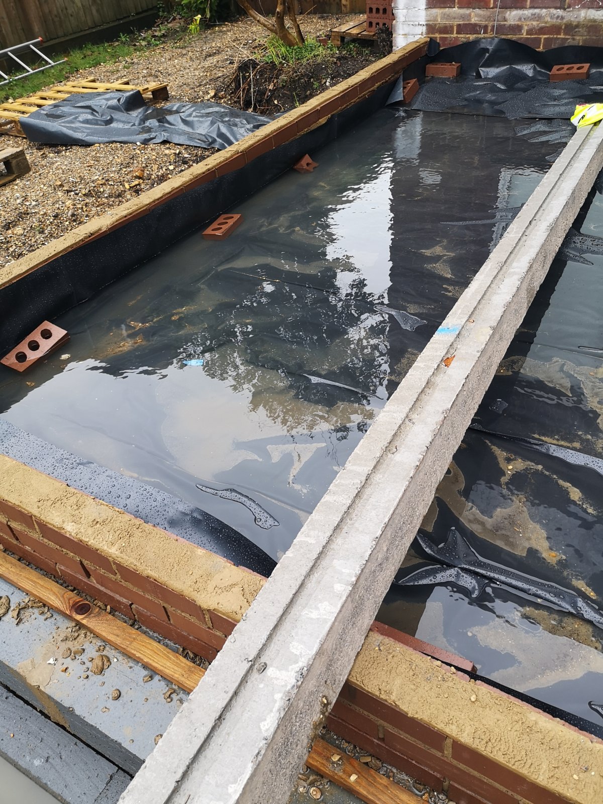

So, with fracture in hand and the bread knife I set about it today.
9am it was full of rain water, due to the constant rain here for weeks on end.
By 1pm we had 6 beams in, cut into the house, its a mix of 3m and 4.8m beams..... They are heavy....... 3m 105kg and 4.8m 170kg each. When there's 2 of you it's a bit of a challenge. Then it rained again........

What you been up to now. You been walking under ladders and smashing mirrors. Take it easy. Pop to scrap yard or tyre place and get a battered old wheel rim for rolling them along on just make sure it wide enough to slot in the tyre wall. Not brill but take some of the weight moving them about.
I did something similar last time I was moving 150kg steel beams: rolled them on 12 inch offcuts of scaffold pole, on top of scaffold board as a smooth surface. You could pretty much move them with one hand.
That's a good idea, the only problem I have is the hound is so soft and uneven from the digger churning it up right where I need to move these beams. So it looks like it's by hand only.
Or helicopter.
So if anyone's got a big chopper not up to much...........
Scaff
Only other way i can think of is a ratchet strap. In the middle of it tie a loop just big enough to fit over the end of a beam then straddle the beam making a loop to go over your head on to your shoulders with your knees bent. Tie the strap at one side so the knot not on your neck or shoulders. Slide it over the beam by about a foot or so and when you stand you lift and drag it along.
