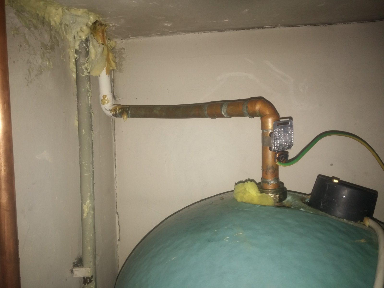

Is the feed to the taps above the level of the top of the cylinder? Usually the air would find the easiest path and travel straight up the vent and with the HW feeds tee'ing off that vertical pipe then air wouldn't usually be drawn in. Have you altered any of the hot feed pipework, away from that pic?

I thought the outlet pipe from the top of hw cylinder was supposed to be a straight piece of pipe with a slight rise in it to aid the dispersal of any trapped air? Then a tee to vent above and hot water downwards?

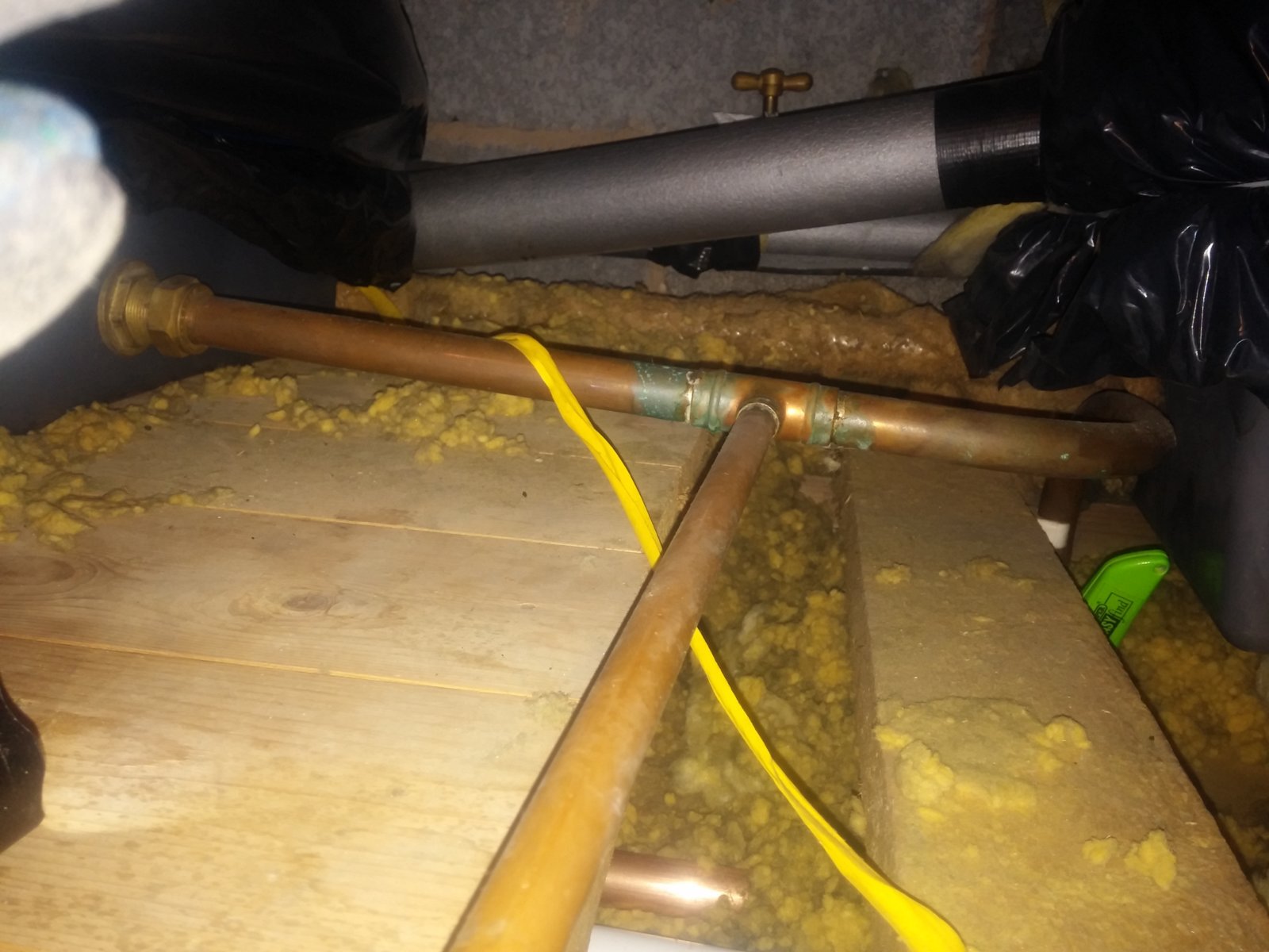

Would be interesting to see how it's piped in loft where the dogleg hw outlet goes through ceiling.

No not altered it too much, slightly yes as seen in the other pic earlier.
I'll get a pic up later, in work at the moment but basically it goes straight up then left via a elbow.
I have slightly altered the pipe above the hw cylinder as can be seen in the pics I posted earlier.
I did want to elbow of the cold water feed opposite the Flange but couldnt cut the pipe with my cutter as its too near the wall.
Altered

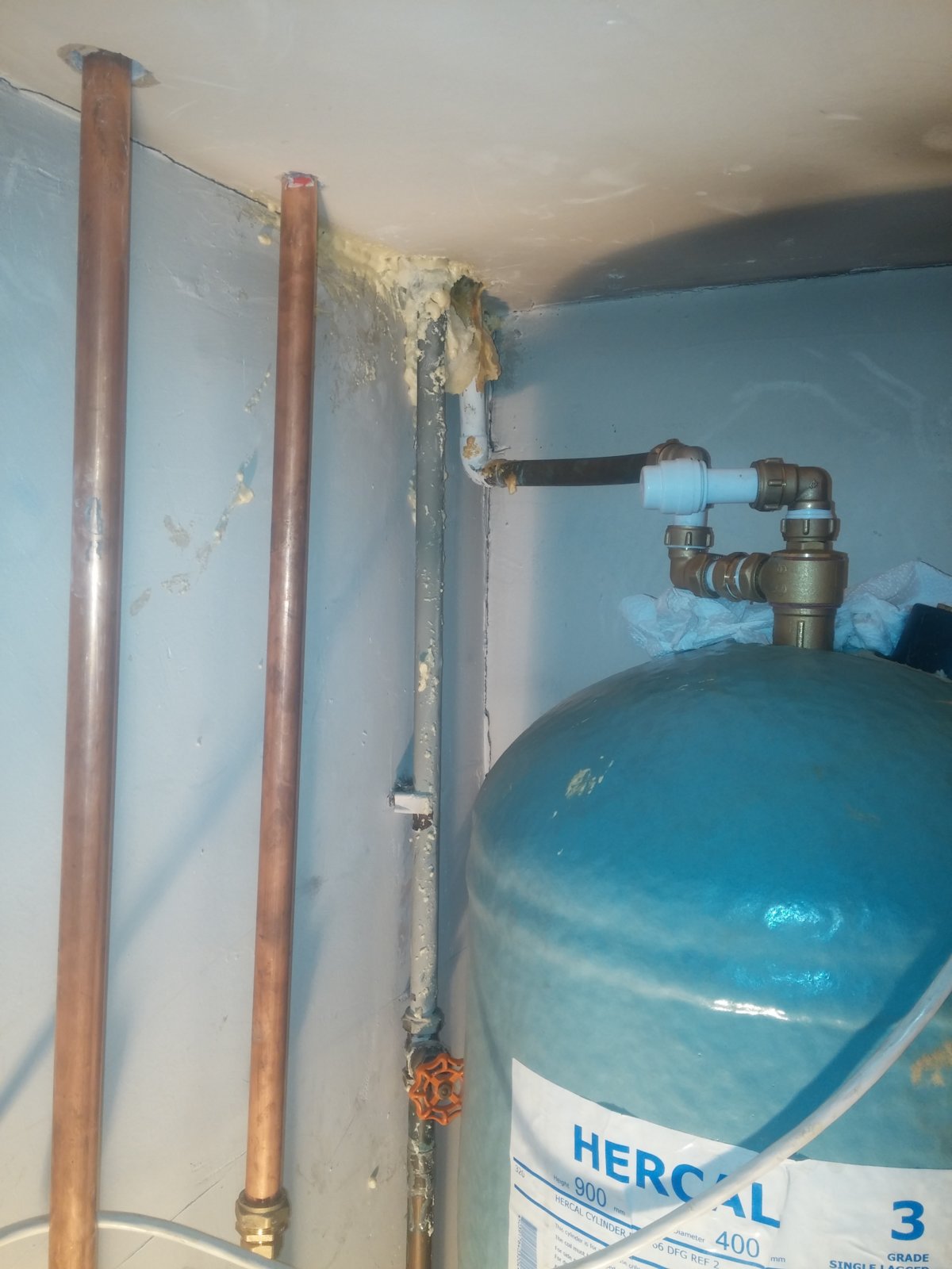

20180213_191819.jpg Original
Loft pic
All pipes elbow to the left like I mentioned earlier.
