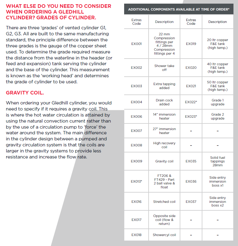

The other option might be to get a bespoke cylinder made to fit your situation. I know this one is almost brand new, so probably not something you want to do. But have it made with a gravity coil and have the flow go into the right hand side so you avoid having the loop over. Keep the return on the left. That would presumably be more like the original one you needed to replace. Obviously, get professional advice first!!

The original cylinder probably had an annulus inside it ( love that word) The large opposite tappings give it away. So a new one would need at least a 28mm coil inside. Possibly controlled by a Cyltrol valve on the return - if they even still make them.

I had no idea! So had to Google. Is there anything inside the annulus (apart from the system water!) or is it just an empty cylinder?
This is exactly what I advised back in April last year original cylinder was a cross flow I advised purpose made cylinder.
However op decided butcher in an off the shelf solution and 10 month later job still in a mess.

If we are talking about a gravity hot water system, if you do not wish to adapt to fully pumped, than you will need to have a cylinder specially made.

Your one pipe system obviously does use a pump, but it is not "fully pumped" in the sense that heating engineers would use that phrase. Neither is it a "gravity" system in the sense that phrase is used.

I think your system is quite unusual and it might be difficult to know what to search for.
The following bit is nothing to do with it being a one-pipe system. It is just an explanation of "gravity" and "fully pumped" systems
In the old days, two separate flow pipes would come out of the boiler. One flow pipe was pumped through all the radiators, before eventually returning to the boiler, in the central heating return pipe. The other flow pipe went up to heat the cylinder, but it wasn't pumped. The hot water would rise up to the cylinder by convection and then, when it had cooled after passing through the cylinder, it would fall back down to the boiler in the hot water return pipe. So, this setup was called a "gravity" system. And there were four pipes in total at the boiler, two flows and two returns.
Then in the 1980s, I think, we moved to a different set up. Only one flow pipe would come out of the boiler. It would pass through a pump and then would immediately be split by a zone valve (or valves) into two circuits. One circuit would be pumped to the radiators as before. The other circuit would be pumped through the cylinder. So that system is called "fully pumped" because both heating and hot water circuits are pumped. There is just one flow and one return pipe at the boiler.
Your system is different. Only one flow pipe comes out of the boiler and then, halfway around the main circuit, it tees off on a loop which passes through the cylinder before rejoining the main circuit. The cylinder effectively seems to being treated as if it was another radiator. I have no idea how common your type of system used to be. I know you are wondering why the water is not being "pumped" through the cylinder and that is tricky I think to understand and explain. I think the answer is that the cylinder loop is rejoining the exact same pipe very close to where it left it. So, there is no pressure difference between where it tees off and where it rejoins so there is nothing to force the water through the cylinder.
