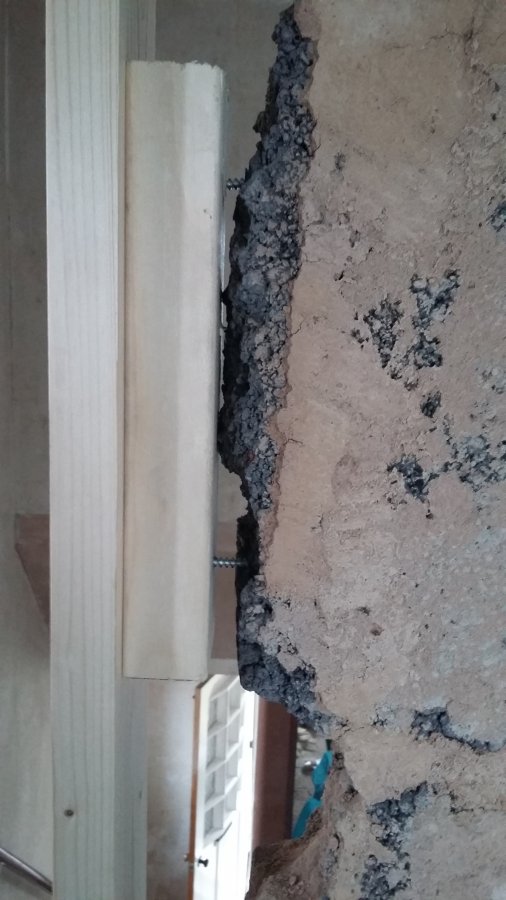

The more we look at the plaster the more we think it's gonna have to come off. In a lot of places it simply isn't stuck too the brick anymore.

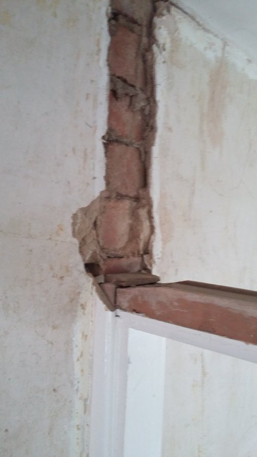

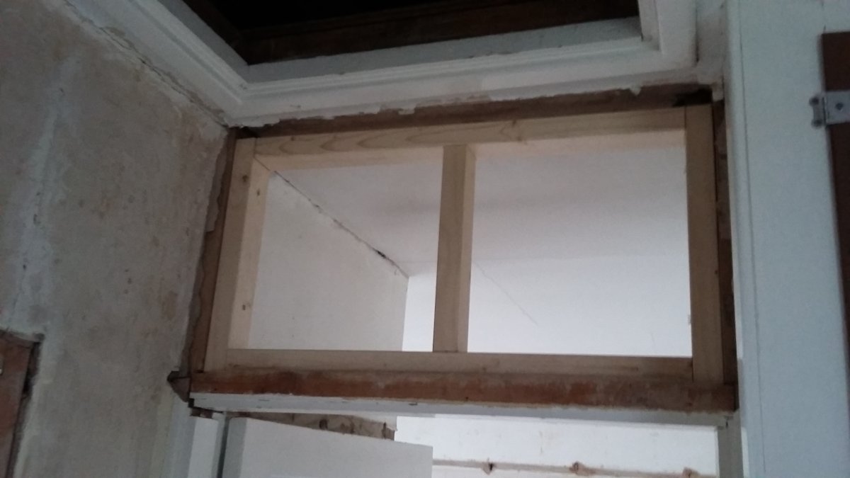

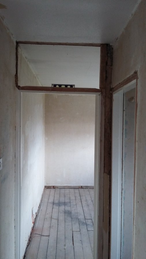

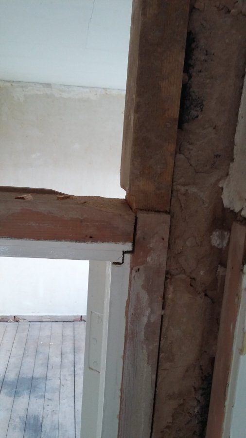

Regarding the door linings we also had a joiner friend in to look at them. I think if we leave the linings as they are it will always bug me. So I'm going to remove the bits of wall above the two affected bedroom doors and adjust the headers. Those walls aren't supporting. I'm also going to bite the bullet with the bathroom door and make it a standard size. I'll chuck up an acro or a bit of timber structure to support the ceiling while I do that as the bathroom wall above the door appears to give some support to the ceiling above. It'll all come out then rebuild in chunky stud wall.

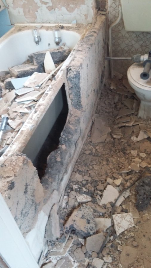

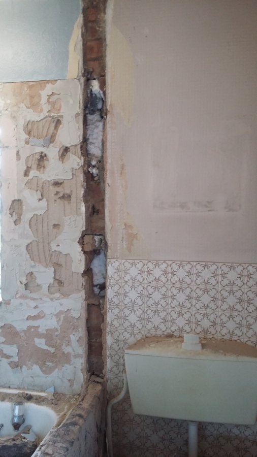

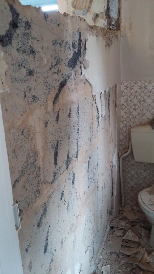

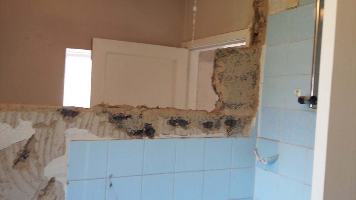

So the wall came down today. Between the bathroom and wc. Not nice when i had to do it from the confined space of the wc.
20160907_103949.jpg first course
20160907_111355.jpg getting there.
20160907_111411.jpg other side
20160907_111402.jpg the tiles just fell off with the sds.
20160907_114942.jpg back of the steel bath exposed
20160907_114948.jpg it was keyed into the outside wall. You can see the cavity foam.

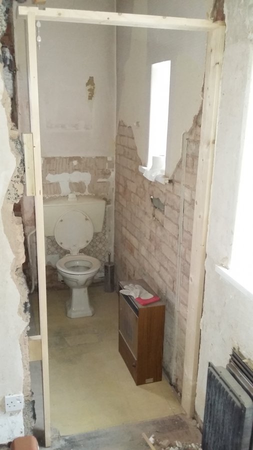

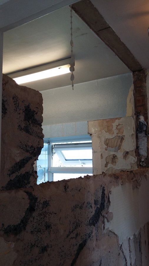

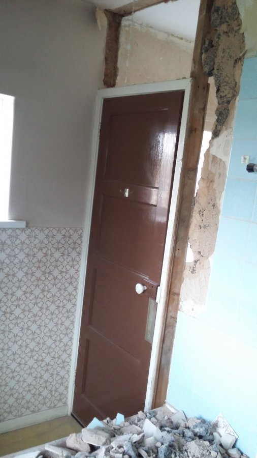

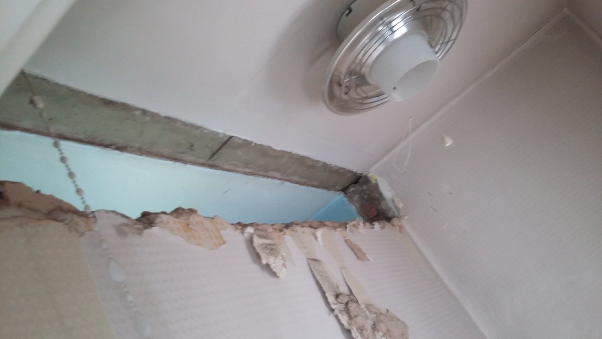

20160907_131253.jpg took the bit of wall out above the toilet door to remove the door lining.
20160907_135124.jpg also removed the blocks down the side of the door lining so we can fit a full size door.
20160907_155503.jpg the door still shuts, though it affords little privacy. The bath is full of rubble until we get some rubble bags.

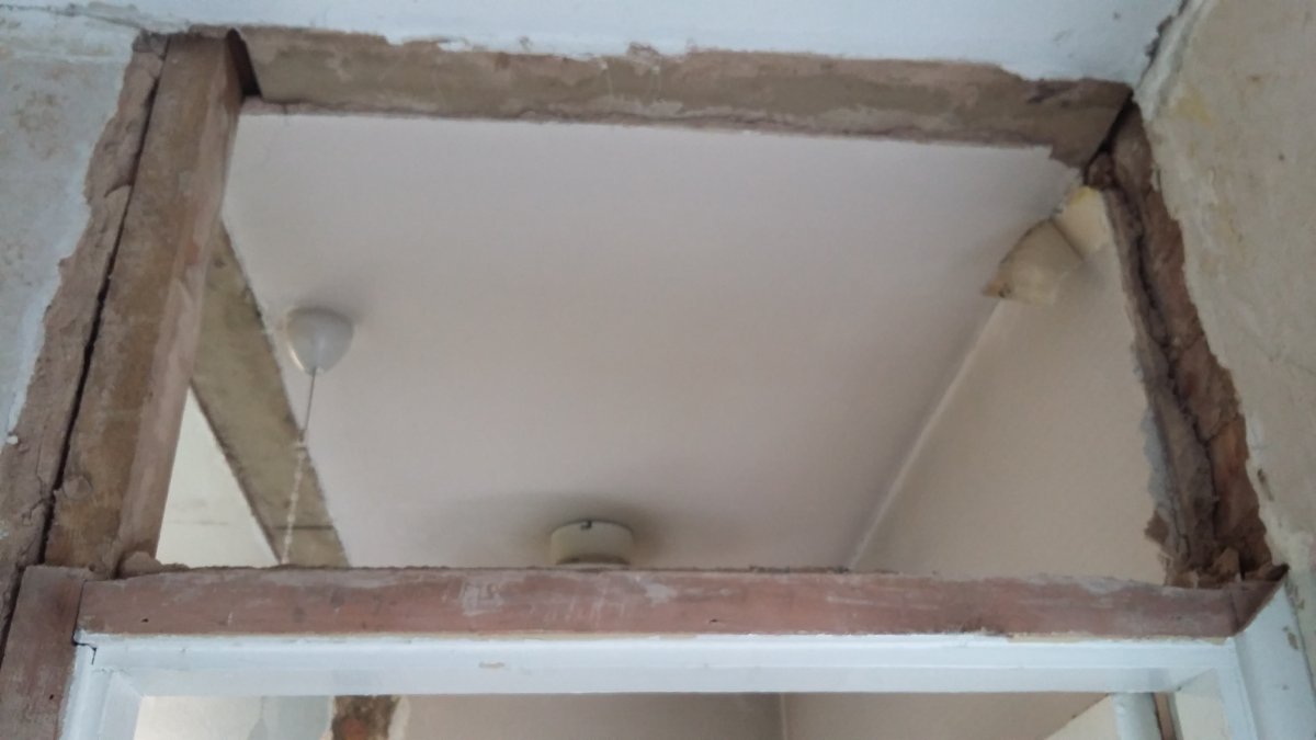

20160907_155254.jpg we removed two other door head walls. Easy as the door linings extend to the ceiling, encasing this section of slim blockwork.

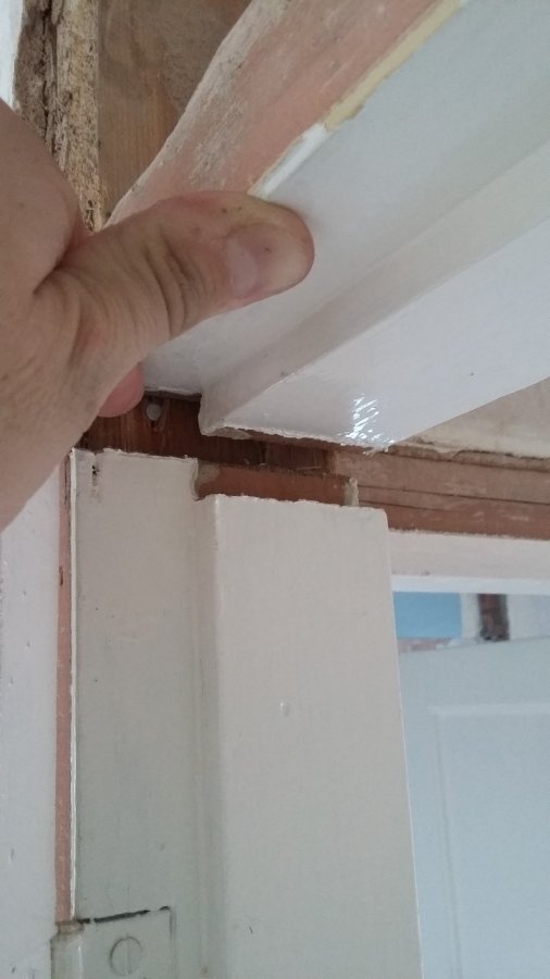

20160907_155245.jpgthis is why we did it. The two door linings are not level due to wall settlement.
20160907_155601.jpg i cut through the nails with a hacksaw and nudged the lining up. I will put some framework above to support this in the right place.
20160907_155542.jpg other one.

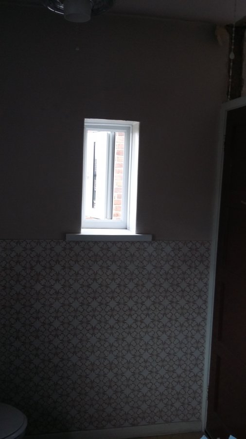

20160907_155454.jpg pointless little window in the bathroom, though having two openers in a bathroom can only be a good thing i guess.

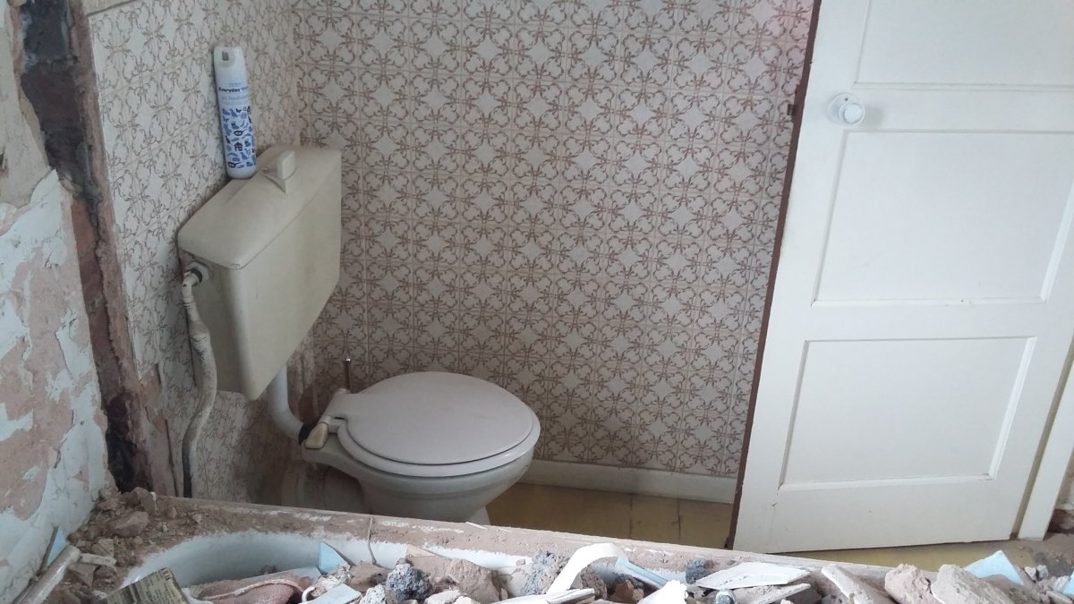

20160907_155409.jpg nobodys ever seen the toilet from this angle.

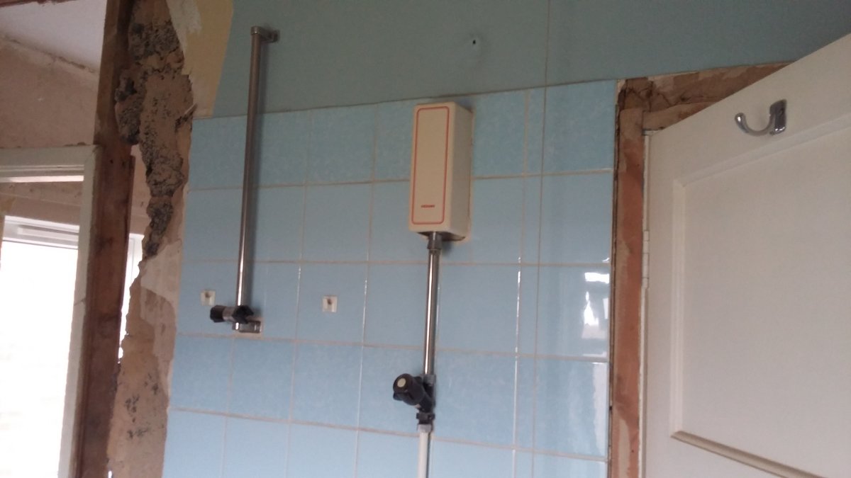

20160907_155401.jpg ancient electric shower. The door on the right here is being framed out and plastered over.

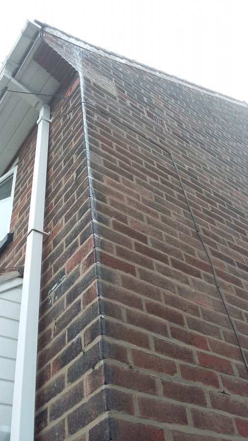

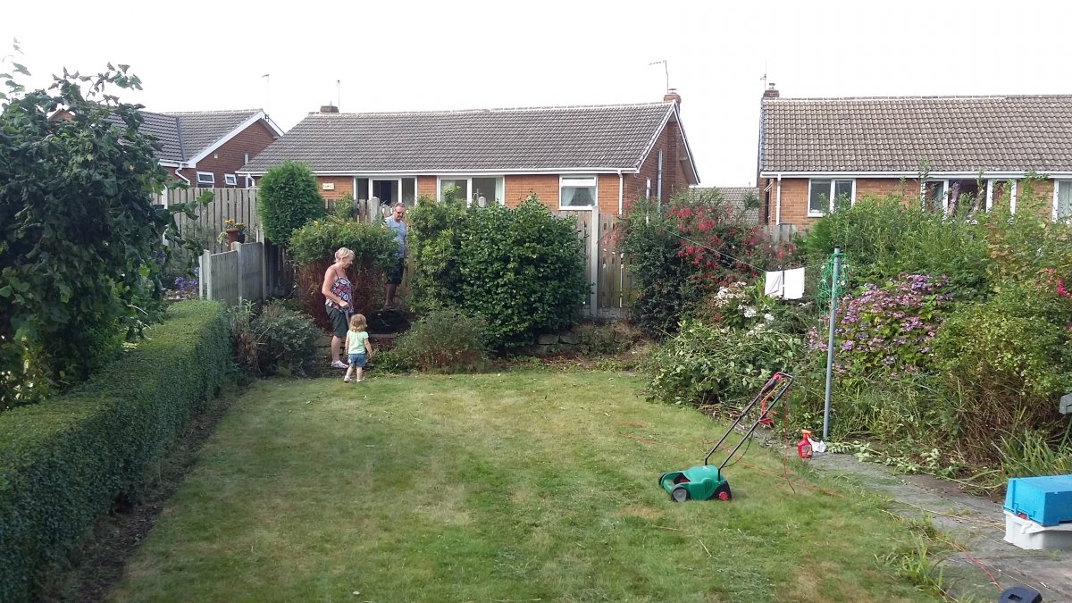

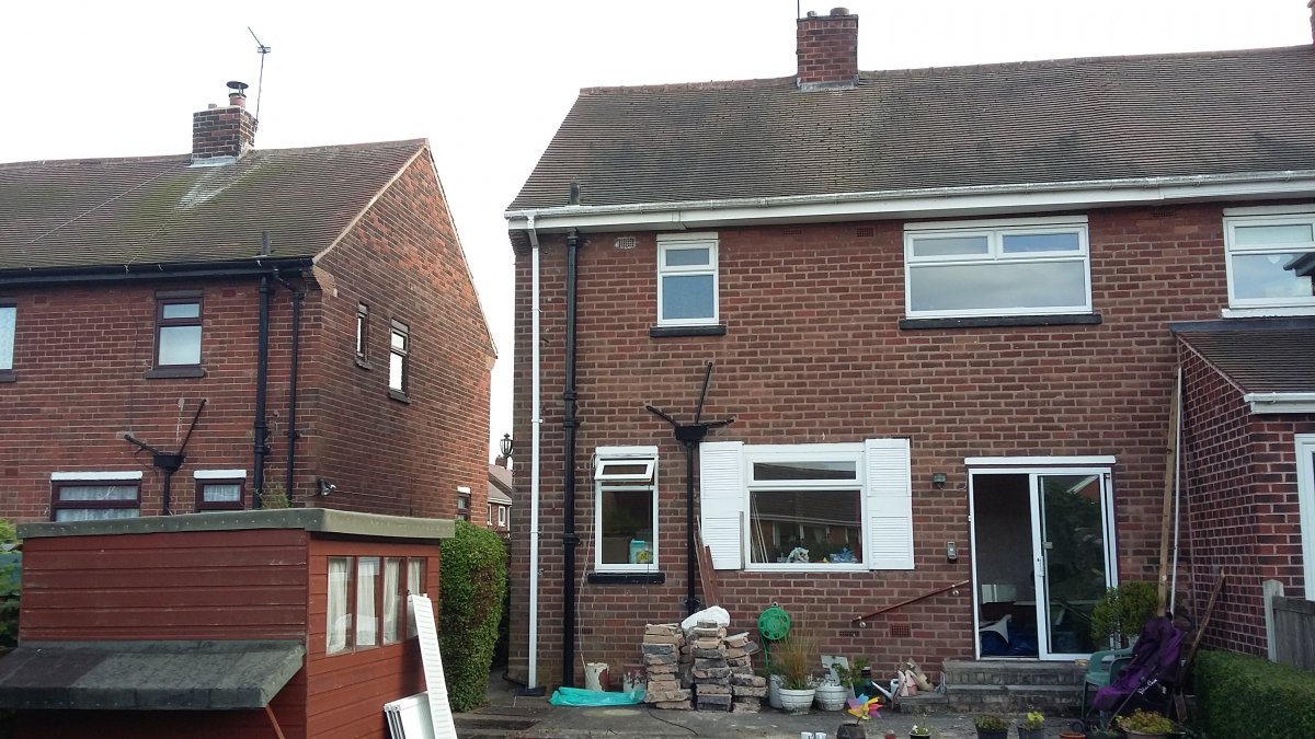

20160907_161645.jpg realised earlier i havent put up and external photos. Heres the back garden. An ideal size.
20160907_161712.jpg the back of the house.

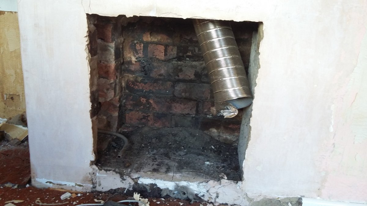

Today was a few odd jobs. My dad fetched his lawnmower which actually did a good job of the front and back lawns. He also took the skirting and architrave off downstairs. I pulled out all the floor level pipework from the old heating system, and also managed to get the back boiler out. It weighs a ton!

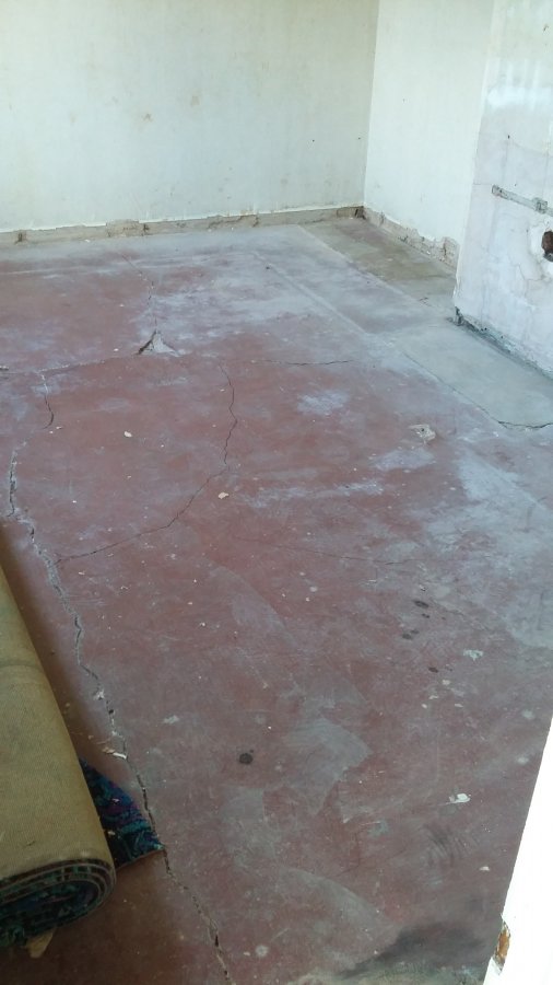

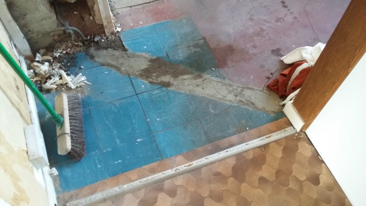

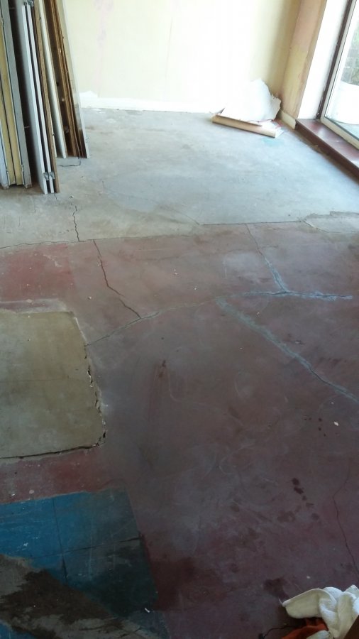

20160908_165311.jpg yet to decide what to do with this floor. The more i think about it, the more i want to dig the whole floor up and relay it.

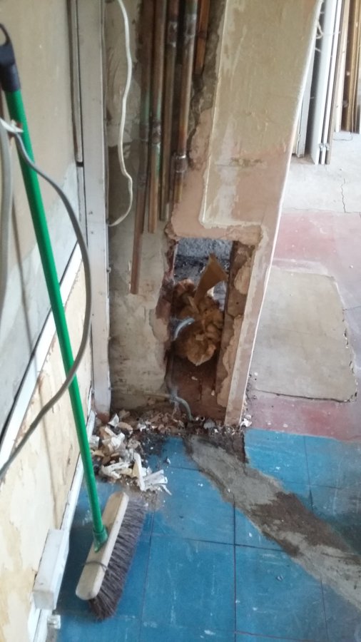

20160908_165303.jpg hideous big hole where they had the heating pipes going into the fireplace. Needs bricking up.

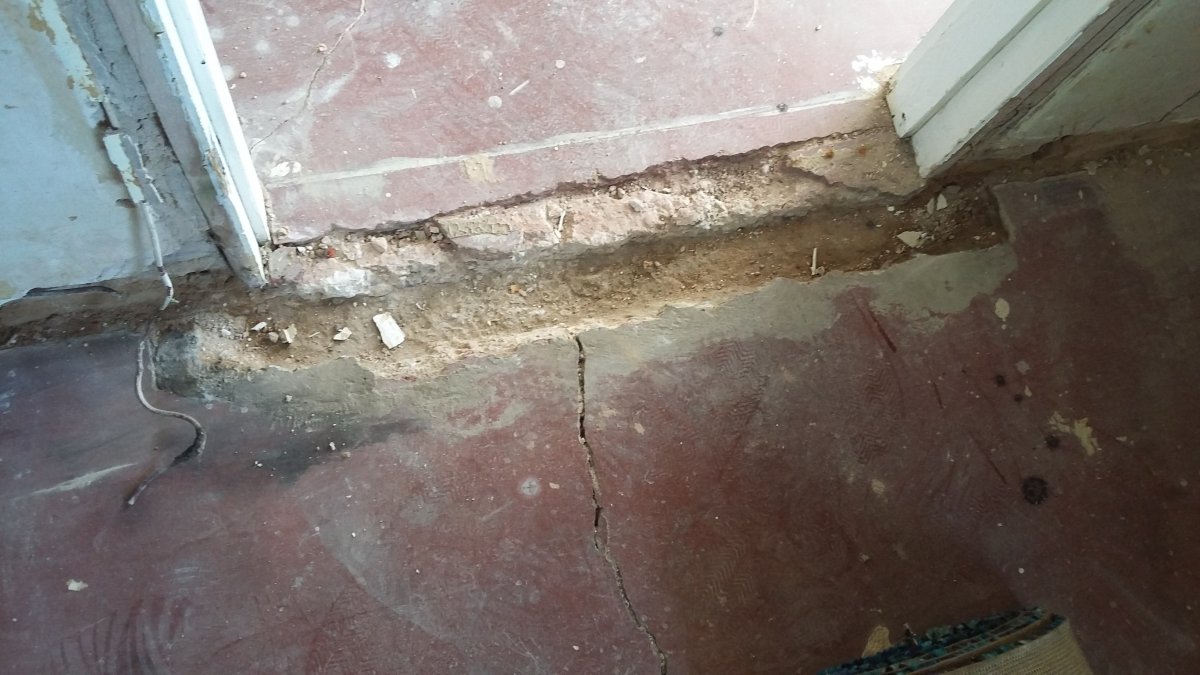

20160908_165247.jpg dining room floor. Part of it was relayed in 1973, less than 20 years after the house was built. One wonders why. Surely the magnesite wasn't failing even then. . .

20160908_163514.jpg corner of the living room showing detail of the magnesite covering.

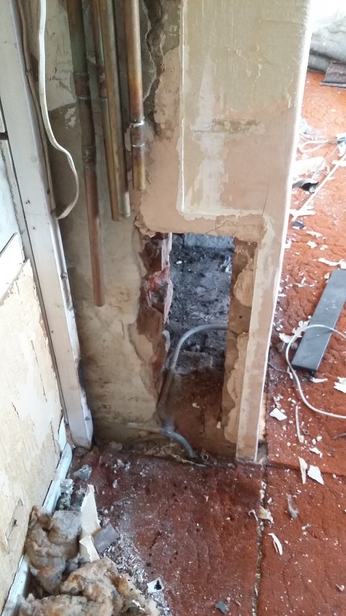

20160908_145708.jpg back boiler cavity. Empty. It was a Glow Worm majorca 246.

Looks like fun demolishing it, enjoy. Is the gas supply capped to that BBU at the meter or something cos that's looks like an open end?
Meter has been removed and the valve capped.

Losing sleep over that floor to be honest. Right now I'm thinking leave it in situ. Nobody else in the area has had it replaced, and if it is sulphate attack its one of the less severe cases. I'll make good by banging out the high points and filling with self levelling. The missus wants laminate in the living room so its got to be reasonably flat, and I'll put down a thick underlay.
A bodge, but at the moment i cant afford £15k for a new floor, especially still having two mortgages. Progress on the sale of our old house is painfully slow. We'll get the kitchen diner floor done with the exension. At that point we may decide to get the whole ground floor done, and seal off upstairs (which will be complete) from dust.
Worth pointing out that the boiler and two fires were supplied by one 15mm pipe. I'm guessing it wouldn't be done that way today! Also all the copper that had been buried in concrete, whilst having been wrapped in some kind of plastic tube, was all badly corroded.

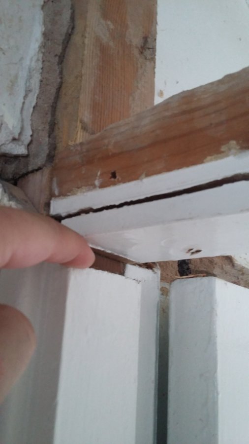

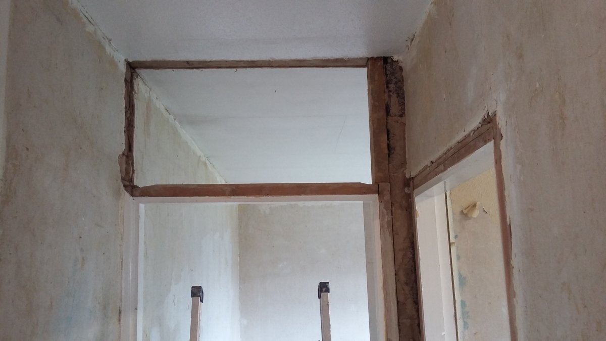

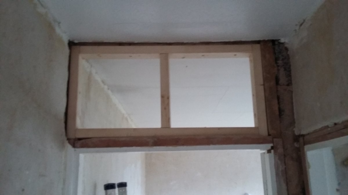

Not much done recently due to work commitments. Today we had to have a blitz because the electrician is starting at the weekend, plumber on monday and plasterer starts wednesday! Yesterday I managed to get the new bathroom door lining in, though it aint pretty! And there's now zero privacy! I also framed out the door tops and levelled the linings where I took out the blockwork.

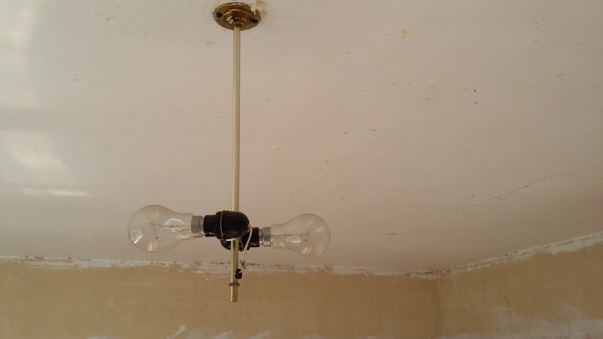

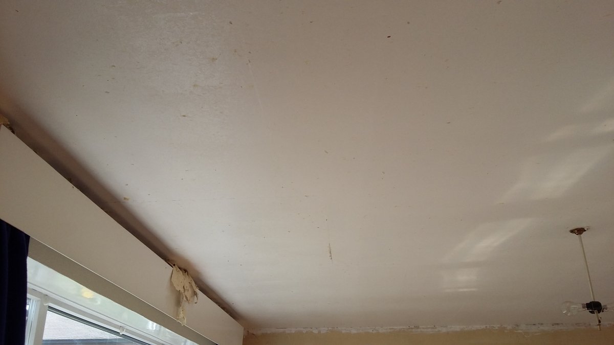

Today I finished clearing the way for the trades downstairs. Demolished a cupboard in the dining room which put up a serious fight and fetched some ceiling down with it too. Also stripped all the woodchip on the living room ceiling. Wasn't too hard as it had been painted with silk paint prior to papering. Jackpot. Plasterer says he'll try to plaster over the woodchip in the hallway as that is stuck seriously well.

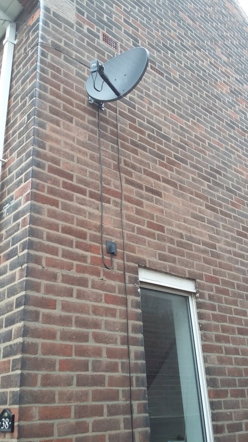

20160915_125106.jpg sky man been too. He ran his cable through the floor upstairs and out the side of the house. So no cables on the front. Woop.
20160915_125056.jpg ugly light fitting. Removed the glass diffuser plate before i knocked it off with the steamer.
20160915_125047.jpg ceiling. Stripped.
20160915_103136.jpg sky dish. Nice and neat.

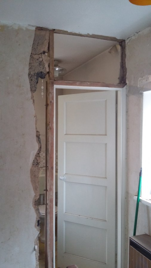

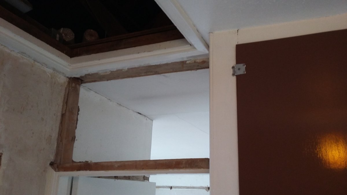

20160915_084704.jpg framework done. Door 1
20160915_084659.jpg door 2
20160915_084617.jpg bathroom door.
20160915_084635.jpg close up of my bodge on the door lining.

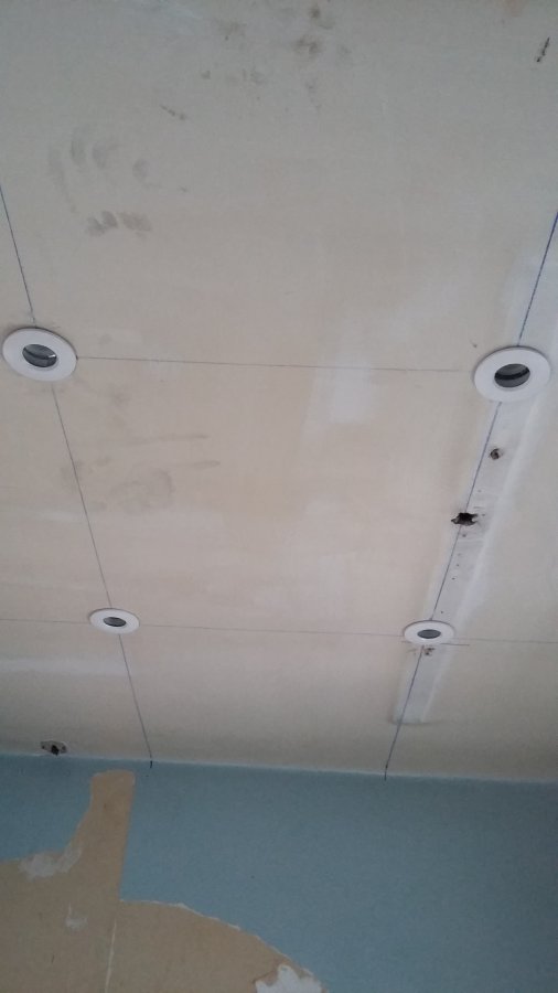

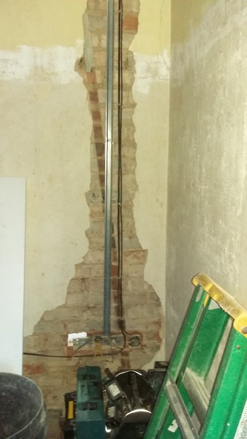

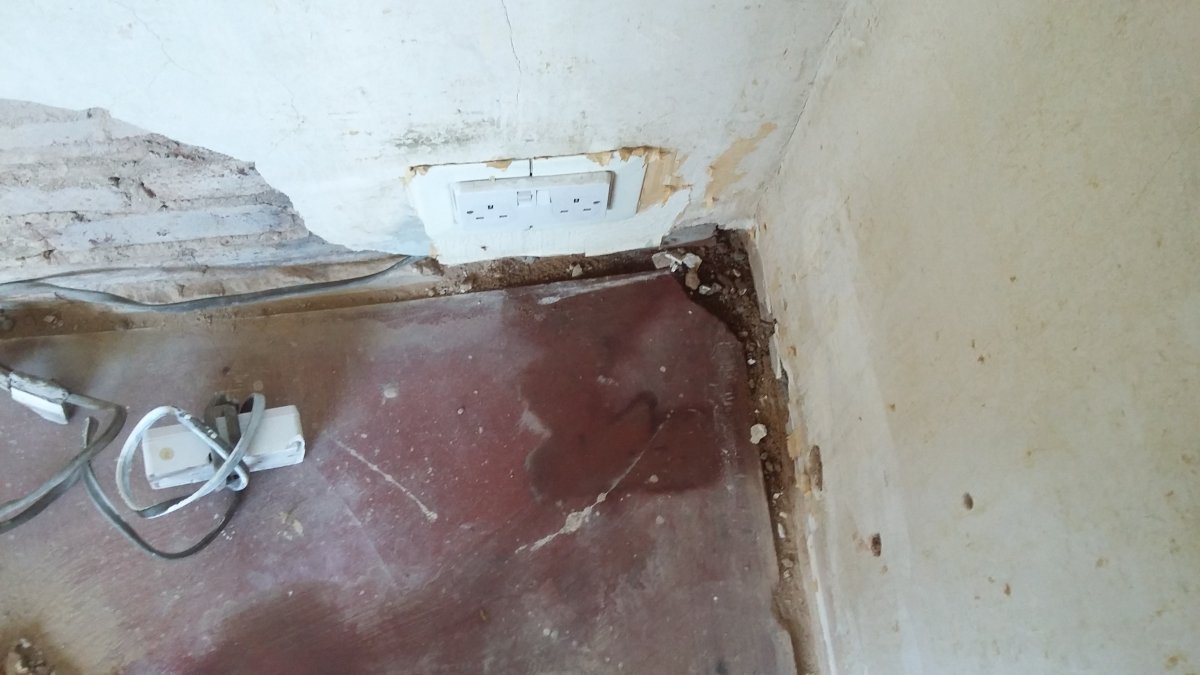

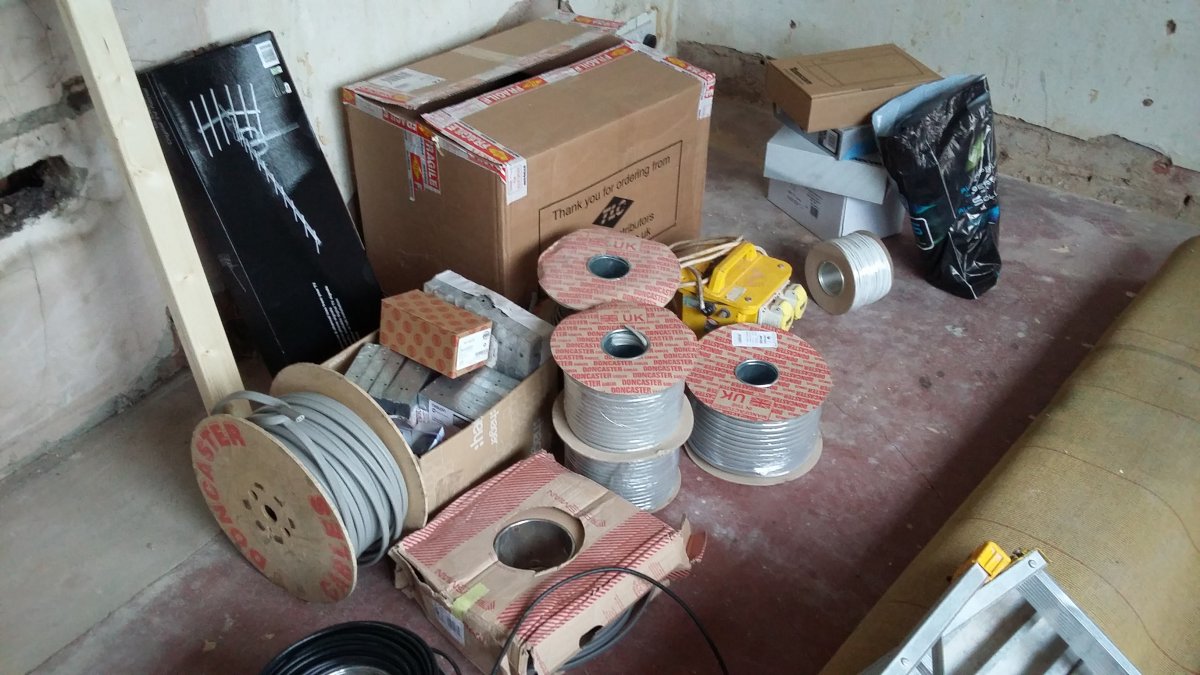

Electricians have been in today. Lots of chasing and mess.
20160917_174518.jpg downlights in bathroom. Im getting some big food bags for when the plasterer comes.

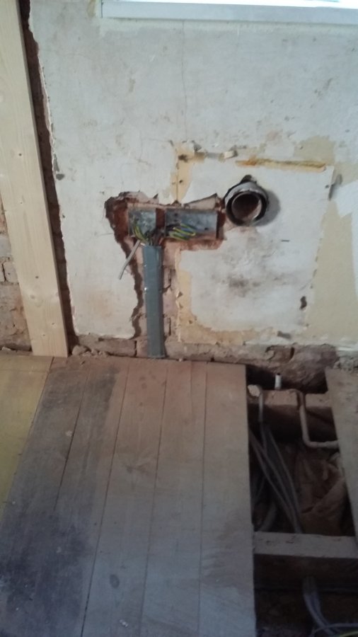

20160917_174544.jpg landing socket and towel rail spur

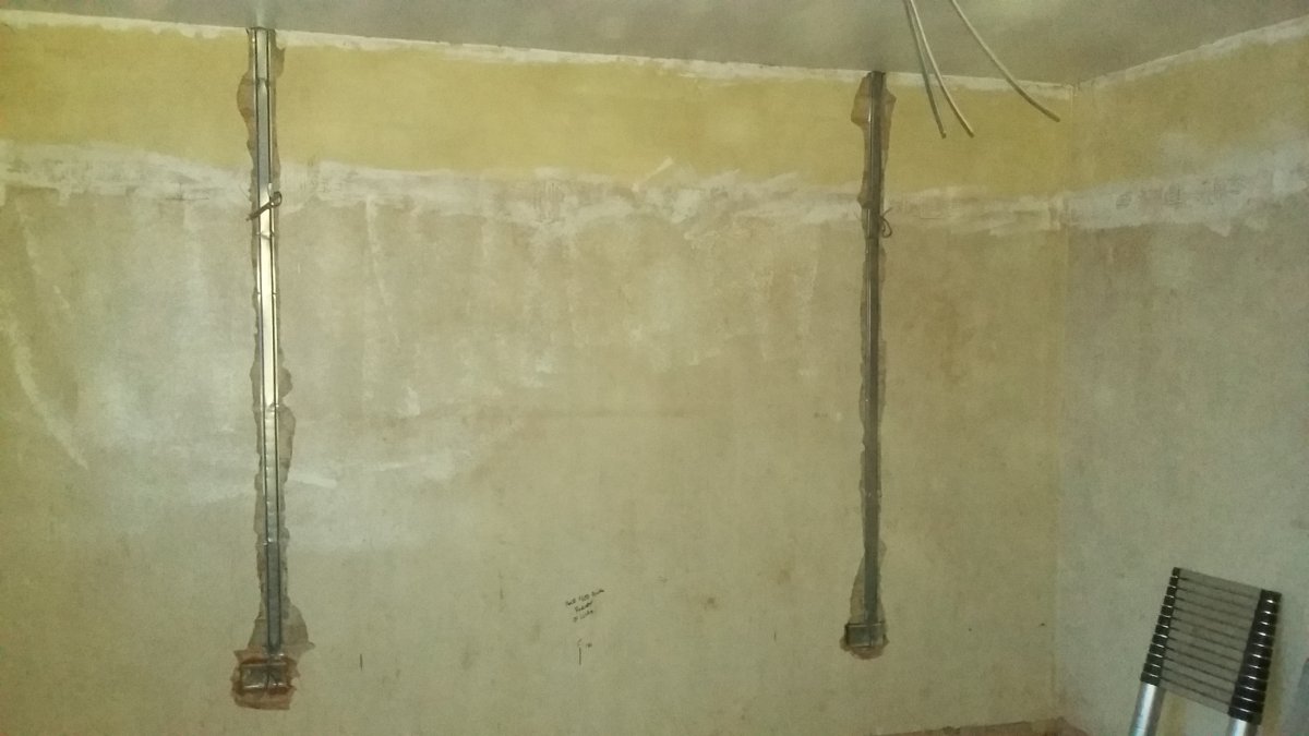

20160917_180330.jpg living room sockets and lights above
20160917_180410.jpg tv corner. Lots of plaster to come off this wall.
