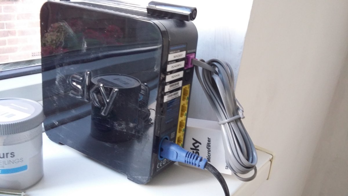

I also ran phone cables from the bt master to under the stairs, then to the tv point in the living room, then to roughly where the virgin media point may be located in the future. The idea is if we get virgin in future i can just drop the cable out of the bt socket.

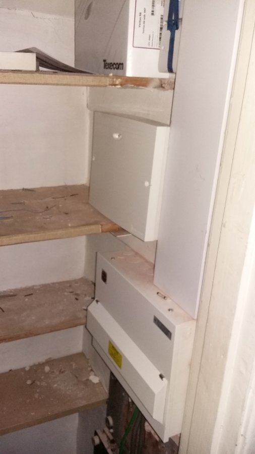

20160918_190451.jpg the electricians have all but finished. This is now the nerve centre for the electrics and the alarm. The electricians just have to finish the aerial system in the loft and the bathroom extractor, and the alarm sensors.

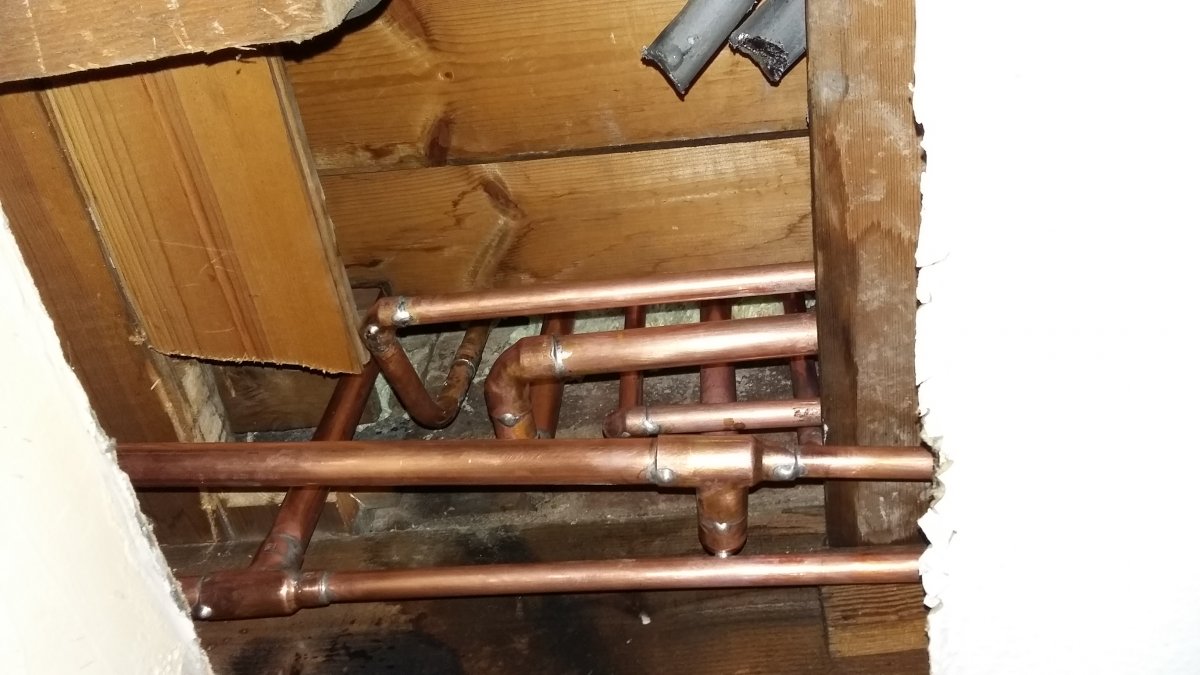

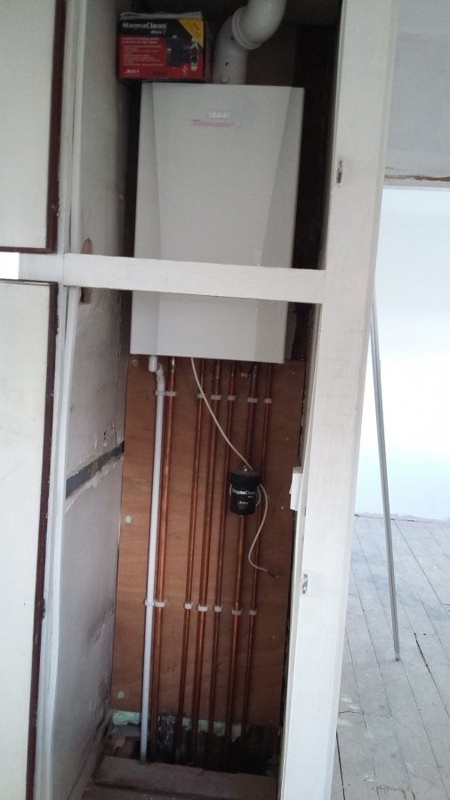

20160919_171750.jpg plumber has been in for 3 days and got the boiler in and the pipework finished. He's just got to come back tomorrow to do the flue and pressure test his pipework. Then return to fit the radiators once the plastering is done. This photo is from below the airing cupboard.

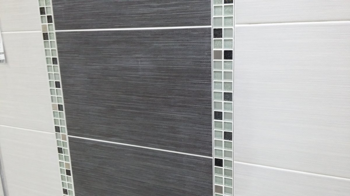

20160920_151639.jpg tiles we picked for the bathroom

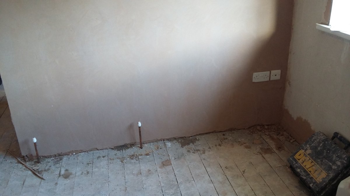

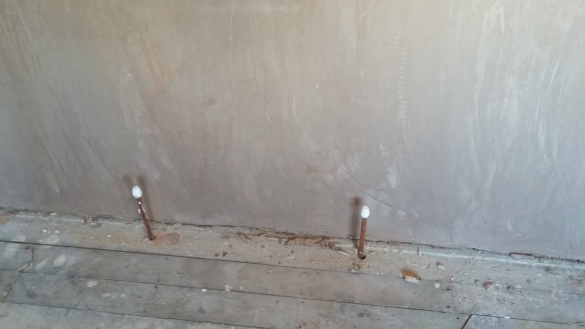

20160921_154536.jpg dining room radiator point

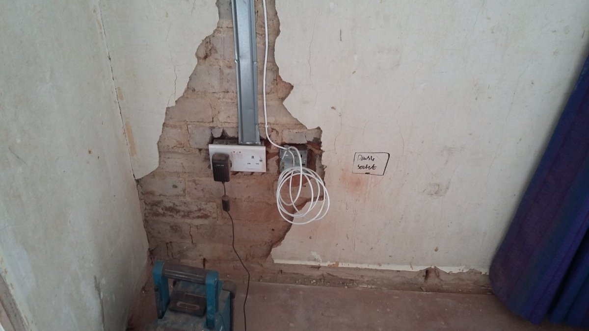

20160921_154604.jpg one of my phone outlets behind the tellybox. Also i put a box for the sky cable which for simplicity I'll just put through a flex outlet.

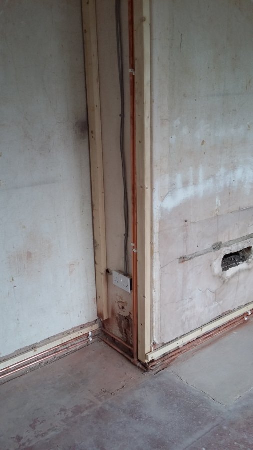

20160921_154618.jpg boxing in the radiator pipes
20160921_154640.jpg lots of plaster fell off when the electricians made their chases

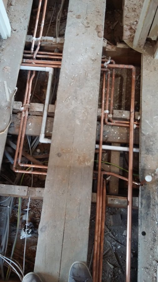

20160921_154707.jpg plumber has been hard at work!
20160921_154731.jpg more pipes.

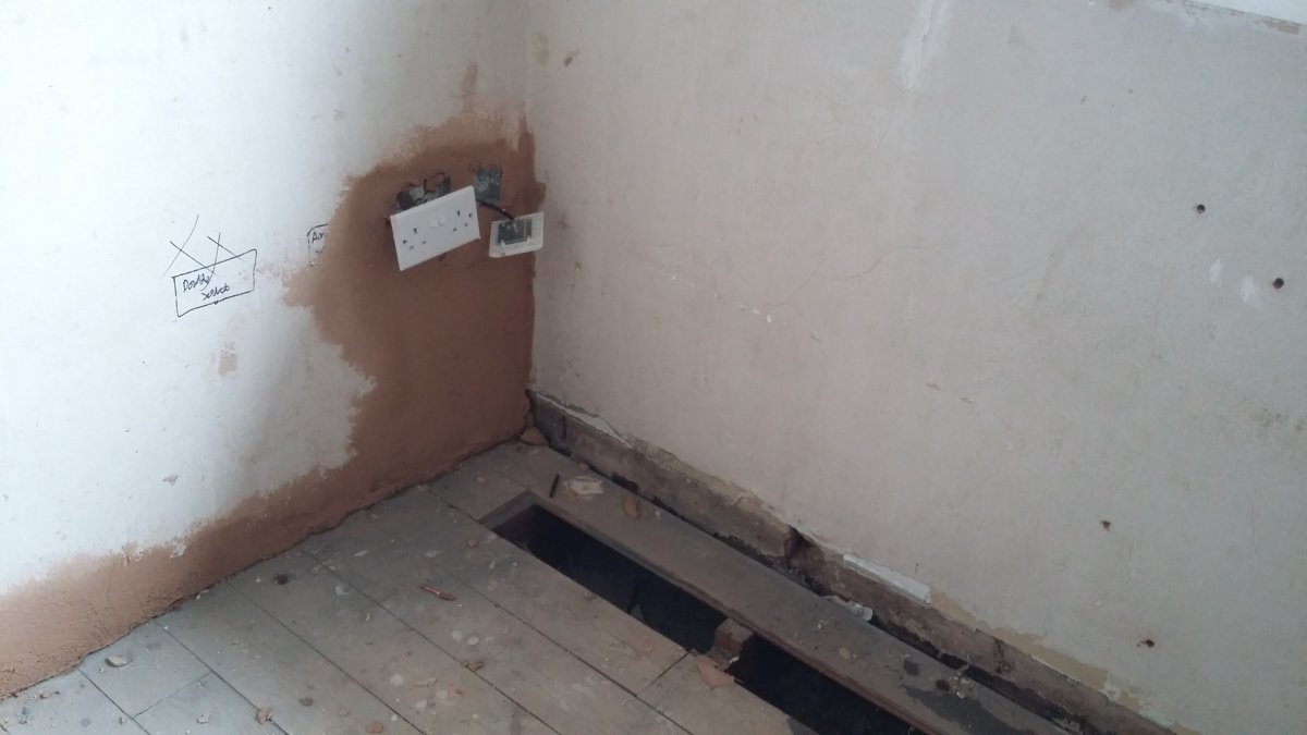

20160921_154631.jpg my final phone socket where the VM socket will go if we get that installed in future.
20160921_154716.jpg the main pipes that feed the downstairs rads

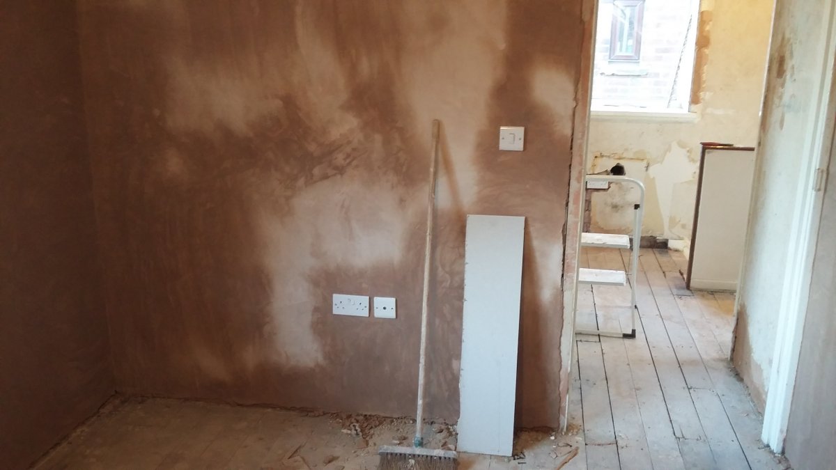

20160921_154841.jpg the master bedroom, plasterer started today.

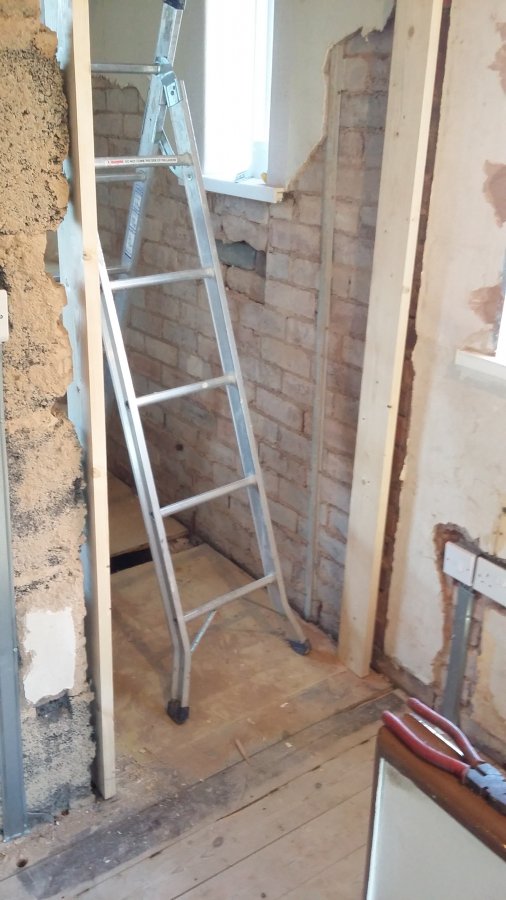

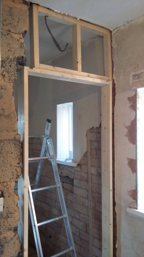

20160922_161242.jpg new doorway framed out. Not pretty, but it works. I have put a piece of 63x36 cls against the right wall to give the plasterer some leeway.
20160922_161244.jpg bottom.

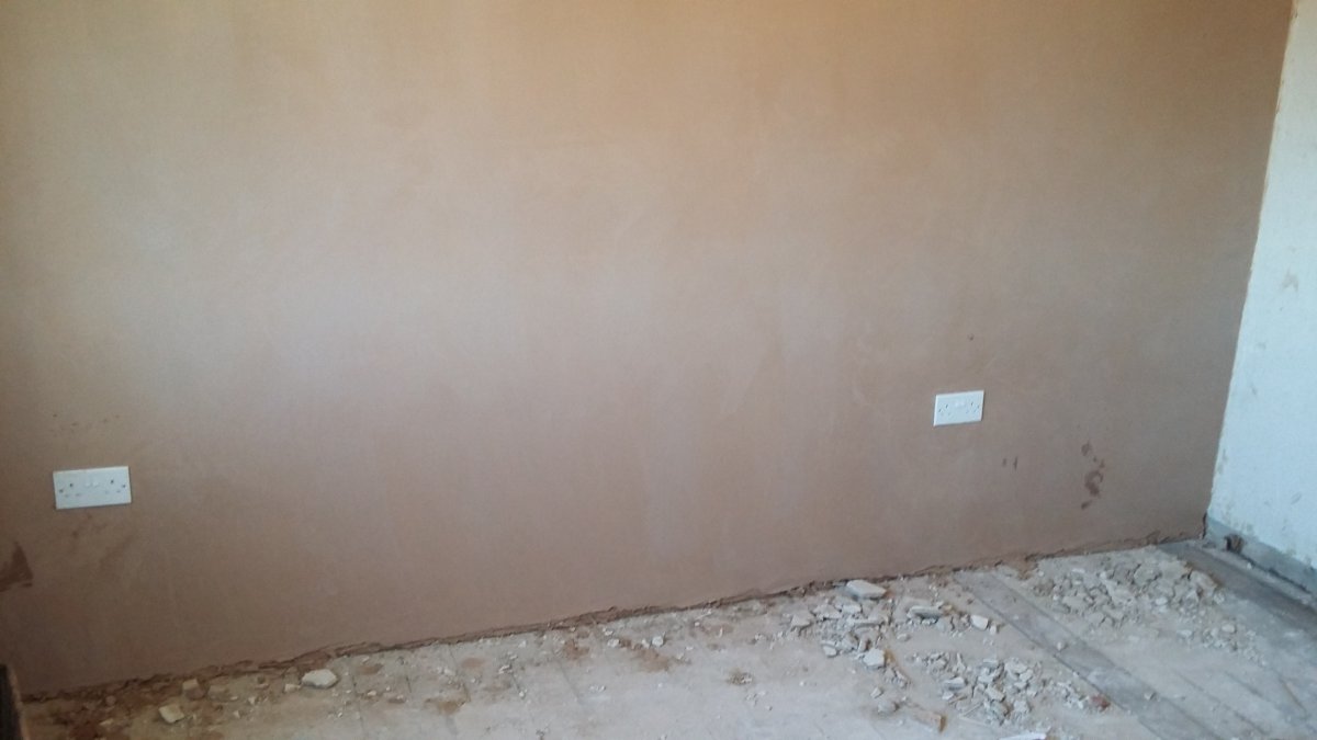

20160922_161258.jpg back bedroom plastered

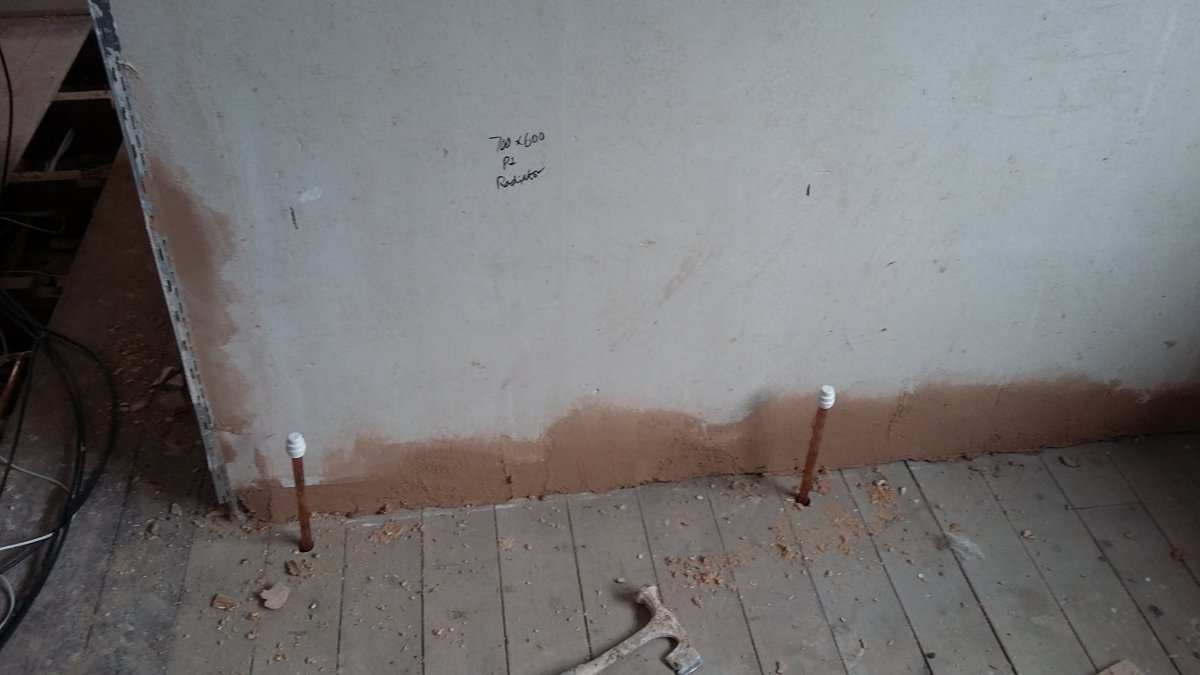

20160922_161306.jpg radiator position in back bedroom

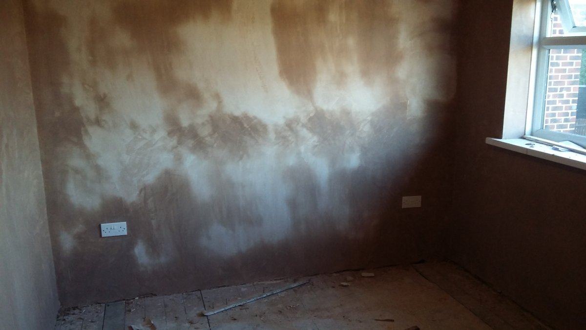

20160922_163016.jpg front bedroom partially plastered

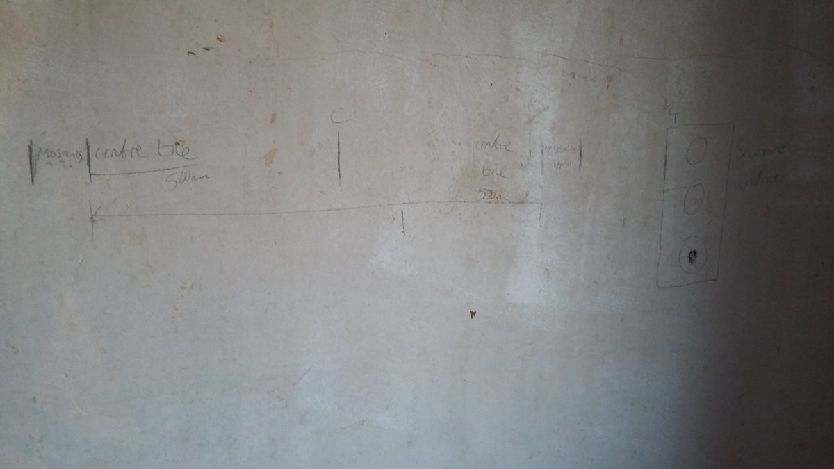

20160922_162922.jpg didnt mean to attach this lol, its my vague markings on the bathroom wall showing the centre column of tiles, and the location of the shower valve to avoid them.

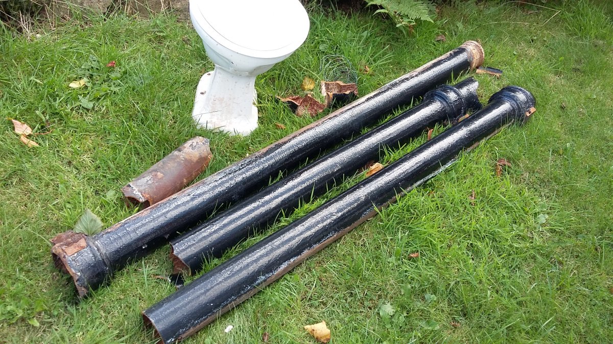

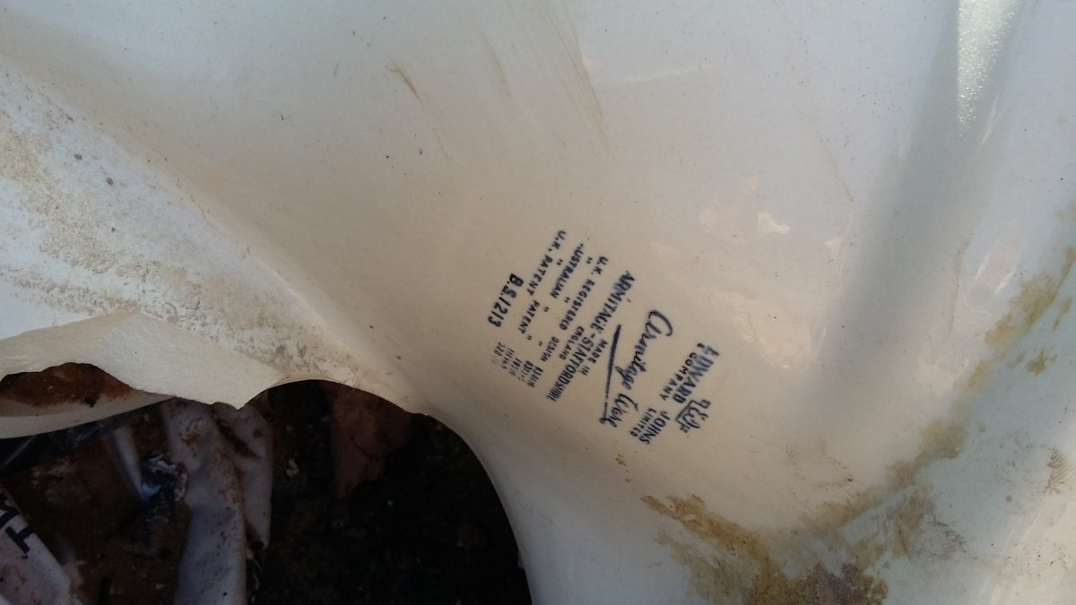

20160929_141013.jpgthe cast iron stack is gone.

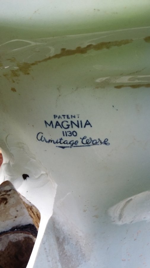

20160930_143859.jpg interesting markings on the old pot. 1950s origin.
20160929_140606.jpg stack gone!

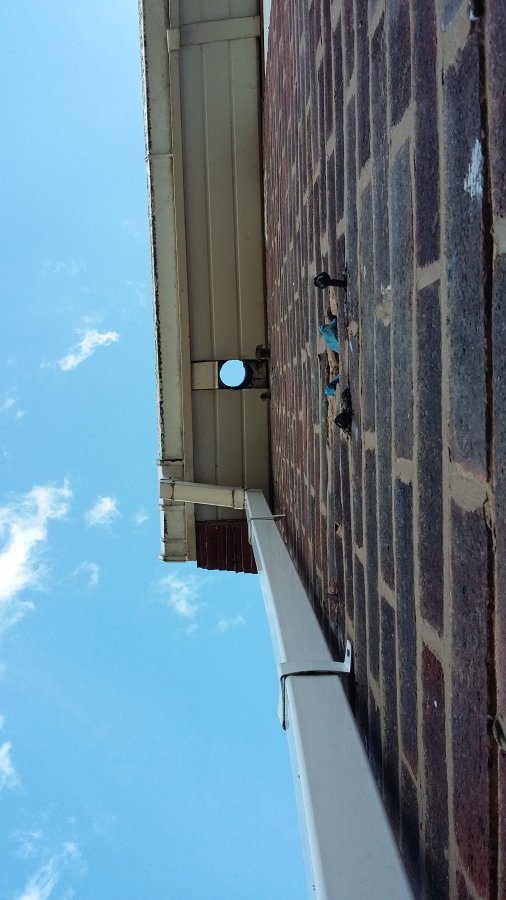

20160929_140639.jpg hmm. Not sure whether this is ok left like this? There is still a pipe sticking out of the roof, so i guess the stack goes up the middle of that pipe.

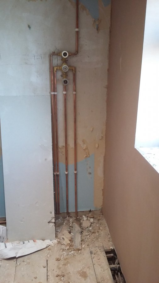

20160929_154236.jpg shower valve first fixed.

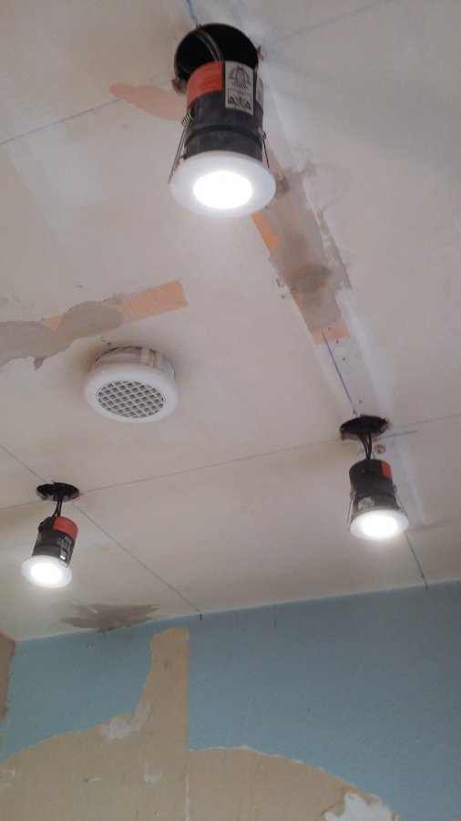

20160929_154247.jpg downlights in bathroom

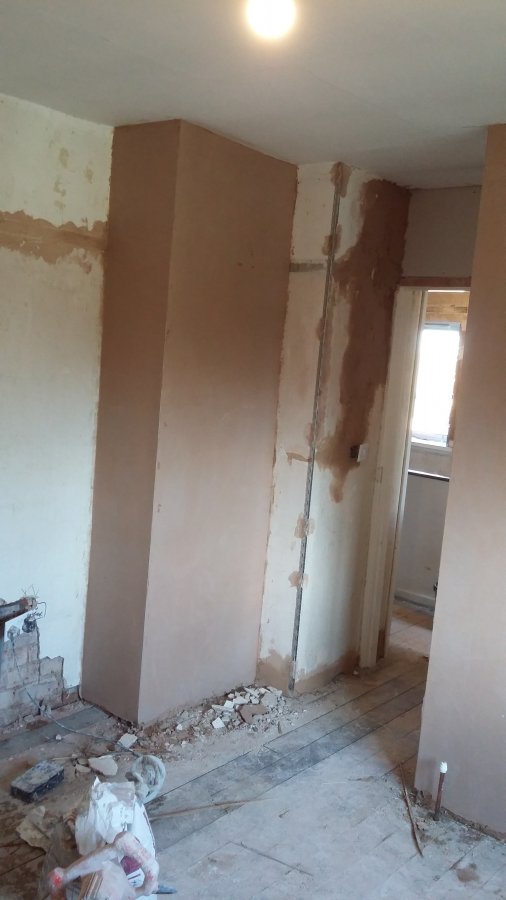

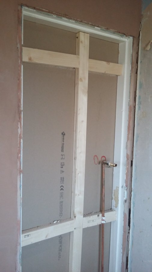

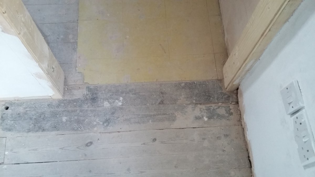

20160929_154300.jpg doorhole boarded and skimmed over.

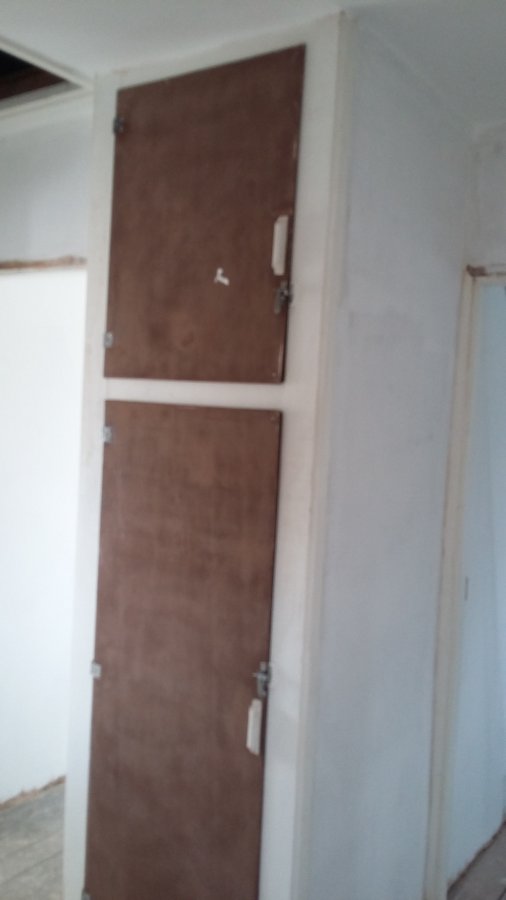

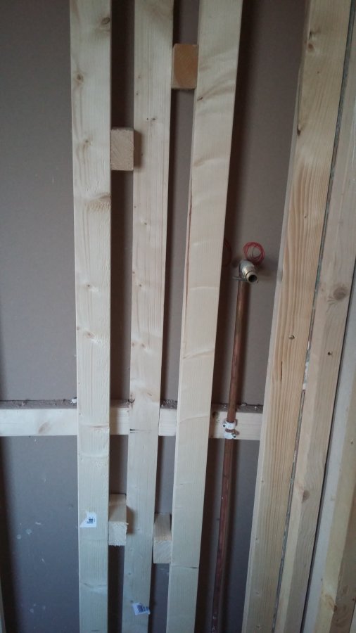

20161010_153653.jpg ive done some prep in the bathroom for the bath and boarding. This is the back side of the door that was boarded up. The plasterer did the framework so I've strengthened it by adding a second layer attached by noggins. Second layer is attached into the door recess, which just happens to be perfect for the no more ply boards.
20161006_142009.jpg wider view. I have framed out the back wall too for the shower valve.
20161010_153401.jpg boiler cupboard

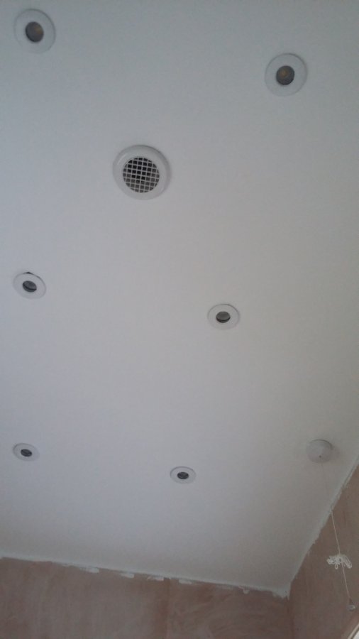

20161010_153505.jpg downlights in bathroom

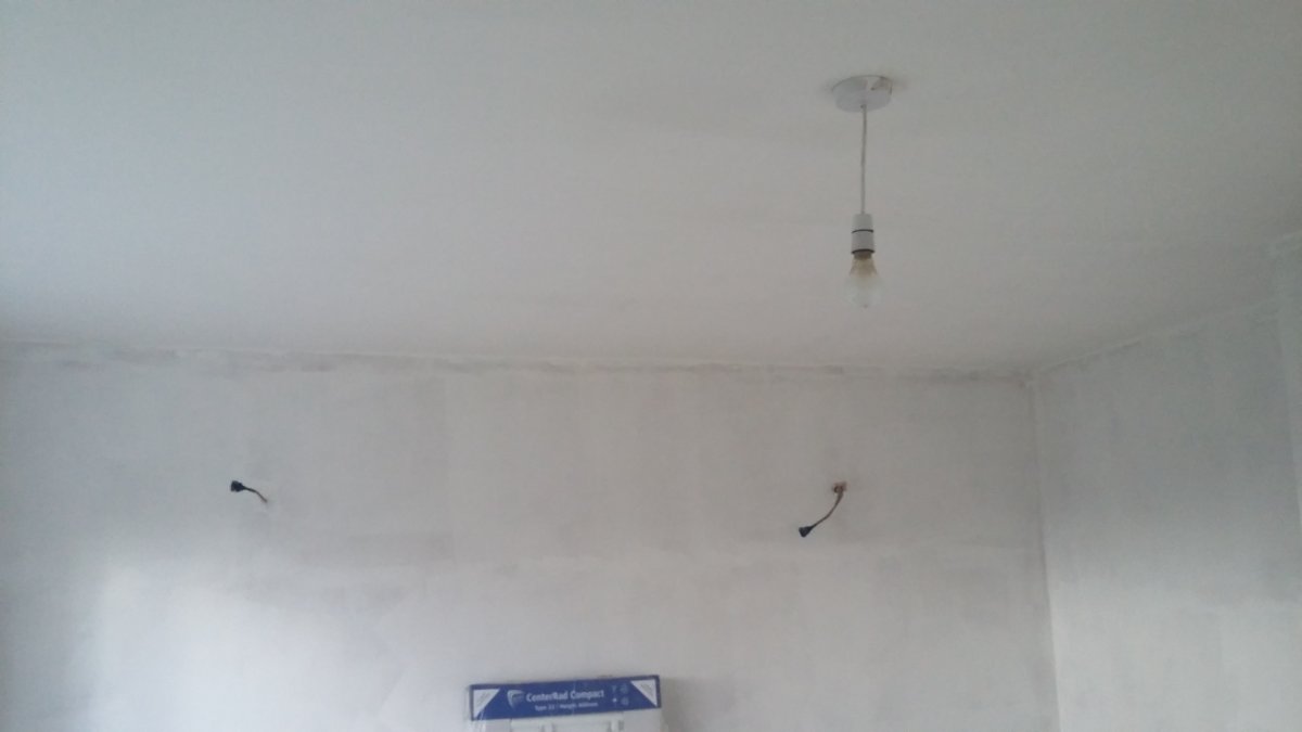

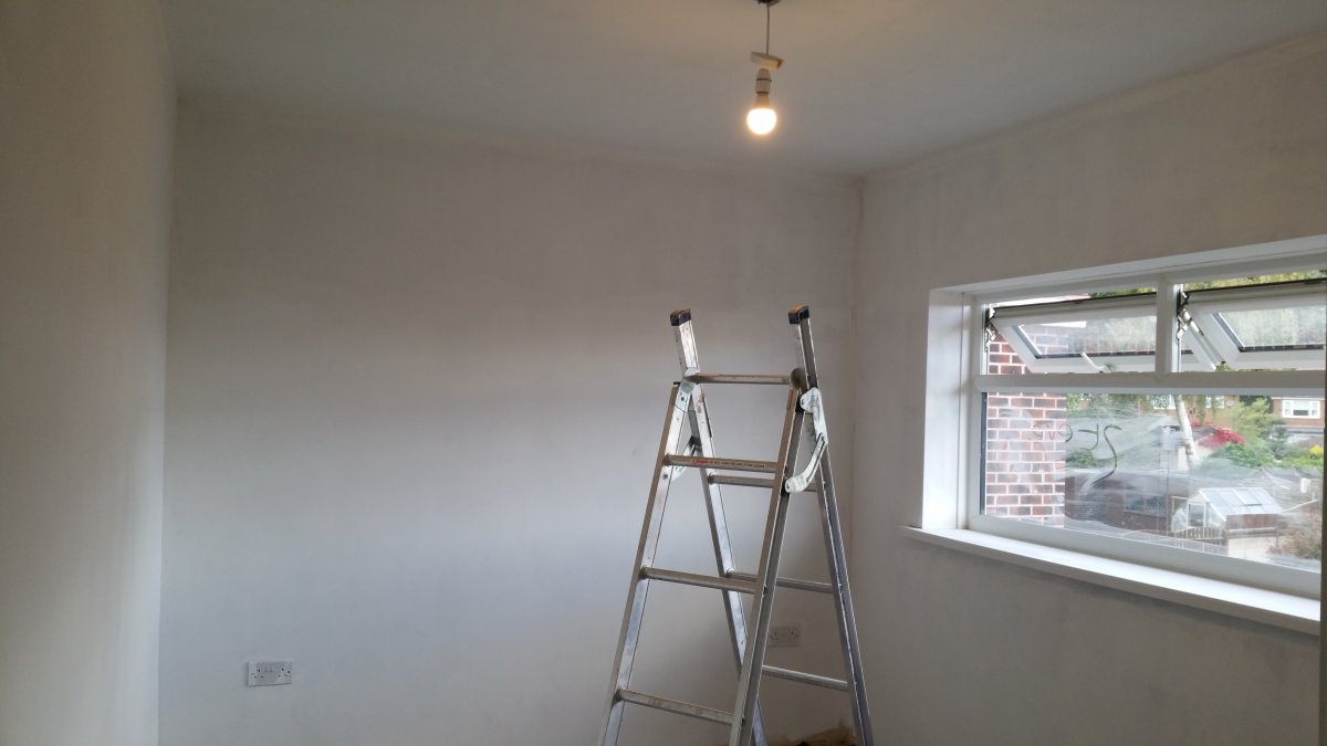

20161010_153835.jpg nicely painted ceiling.

Will you put some insulation in that boarded up old bathroom door? With a shower on the other side, sounds may transmit into the hallway. Some Rockwool should do the trick :)
Oooh you know, i never thought of that. I will put some in there, and along the adjoining wall too, as the room next door there is my daughters room and it'll be nice to stop as much noise as possible getting through from showering.
If you really want to reduce the noise you should look to proper acoustic insulation. But I found Rockwool was good enough when I rebuilt the bathroom walls at my last place, and that was a 3" thick stud wall.

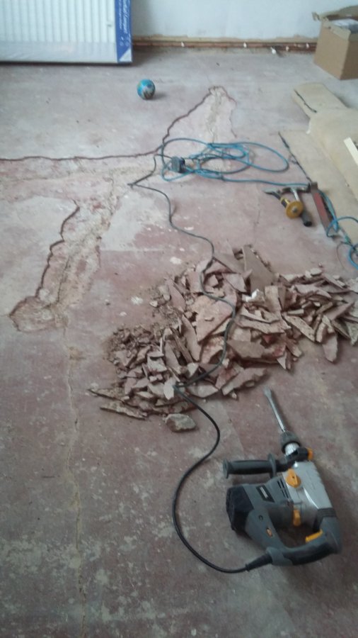

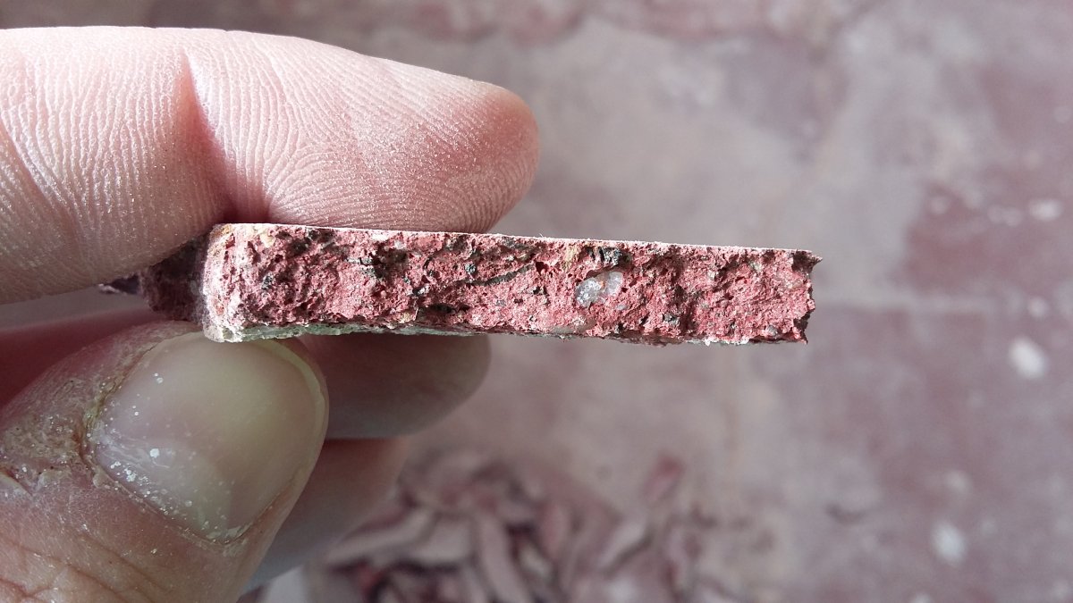

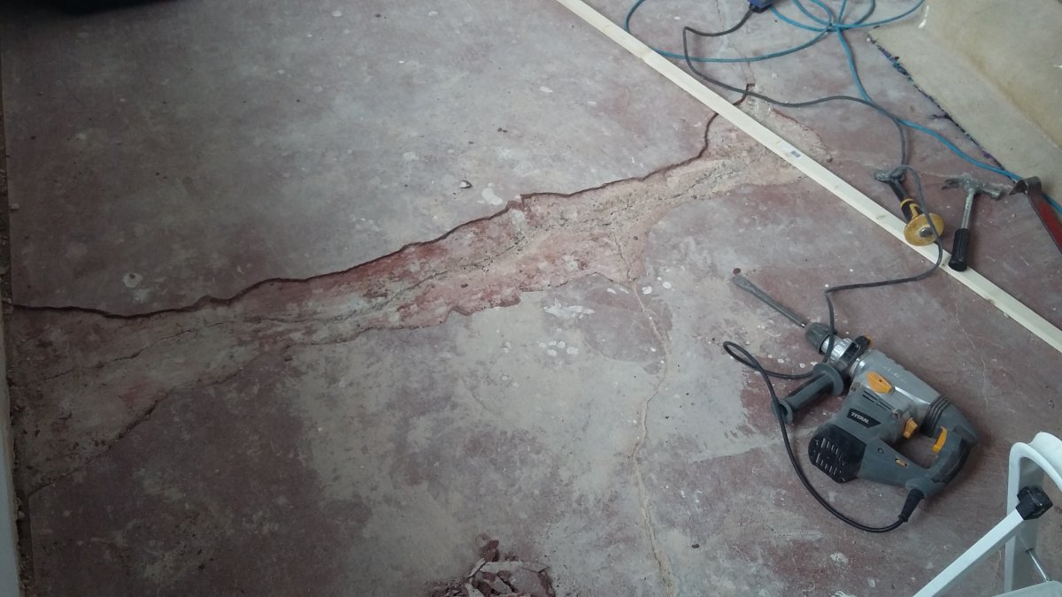

Been at the house this morning and started chipping the magnesite off the floor in the living room. I'm only taking off the high points then filling in with self levelling. Using a length of timber to find the high points and the sds drill to chip it off. Its coming off in big chunks mainly, though some areas are very well stuck down.

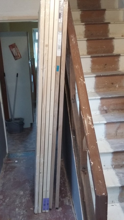

In other news, the doors have come. Just as the heavens opened! Luckily they were all wrapped in plastic.
20161012_115428.jpg 20161012_122131.jpg 20161012_115850.jpg 20161012_122126.jpg

Your probably already wise to this but don't leave them doors stood up like that, lay em flat. Progress looking good keep the updates coming !!
I have stood them up in their respective rooms as upright as possible.
