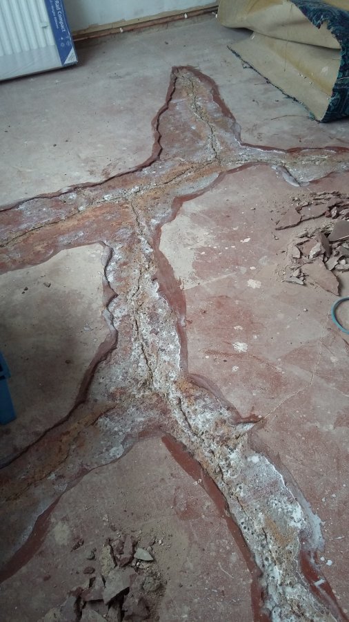

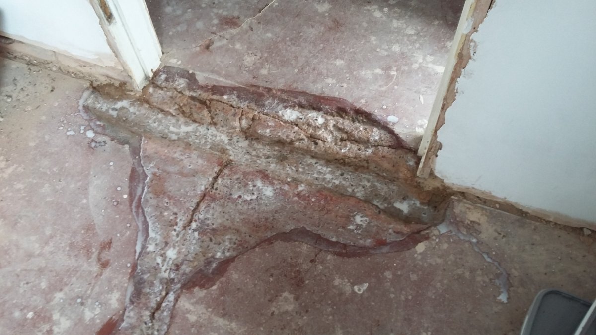

Today I finished digging chipping the living room floor magnesite off. I've only chipped the high points off, so I could make it somewhere near level. The hall has a couple of cracks in it but for the most part is level. The kitchen floor will probably get dug up when the extension is done.
20161014_132827.jpg first I swept and coated liberally with a watery pva.
20161014_132814.jpg strange shape i carved out. Some of the magnesite came off in sheets but some was stuck on very well.

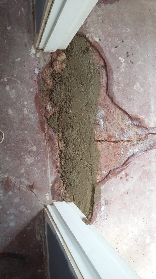

20161014_140545.jpg used a bit of concrete under the threshold where the heating pipes were previously buried.

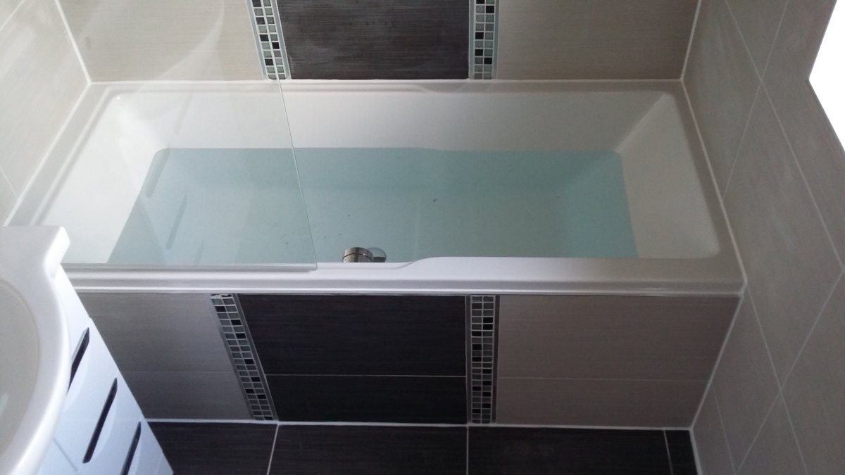

20161014_082701.jpg in other news, the bath is in and the wall boards too. Plumber unexpectedly turned up yesterday.

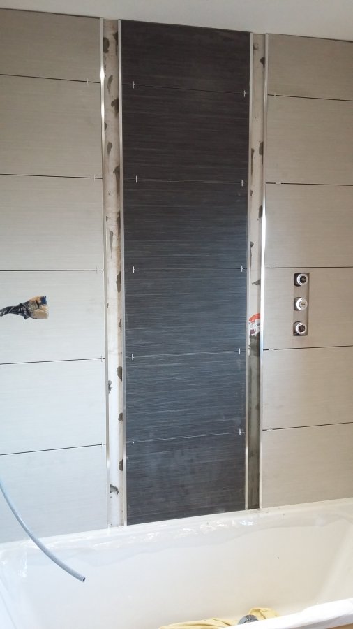

Today the plumber was fitting rads upstairs and his helper was tiling the bathroom. Starting to come together now. No pictures of the doors but heres a couple of the floor and the bathroom work in progress today.

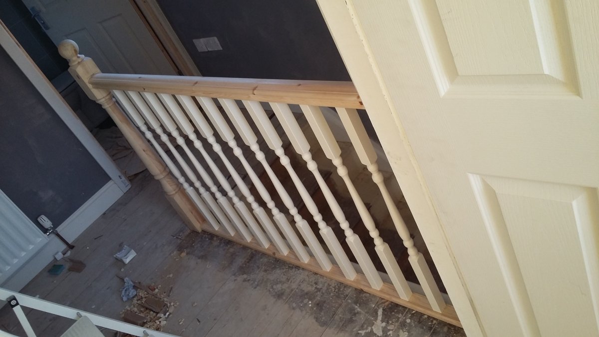

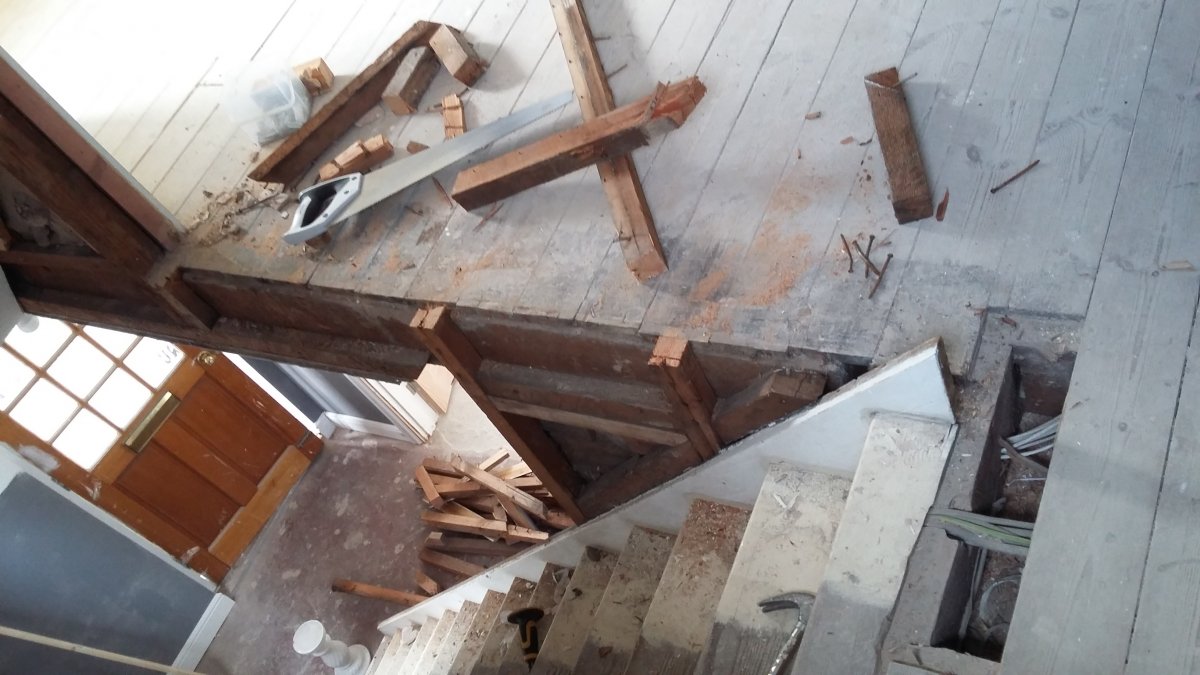

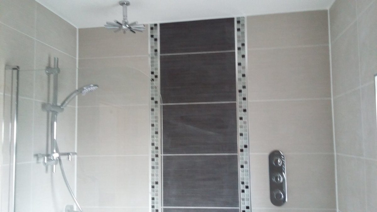

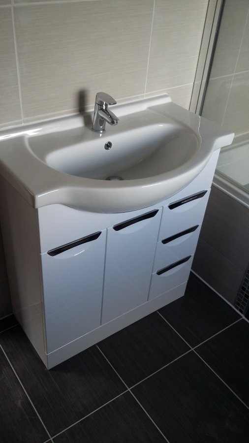

Sorry for the lack of pictures. Here goes. I've been to the house this morning to rip out the stair rail framework. Now I'm confused. Anyway heres some pretty pictures of bathroom and doors. . .
20161021_140308.jpg 20161021_140252.jpg 20161021_140401.jpg 20161021_140331.jpg 20161021_140454.jpg 20161021_140641.jpg

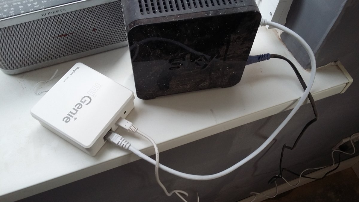

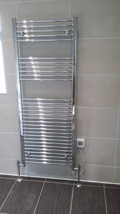

The heating system is fully functioning and can be controlled by my phone thanks to the drayton migenie. The bathroom is finished apart from the toilet.

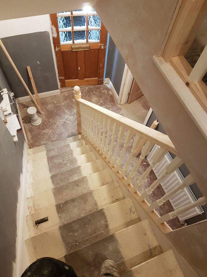

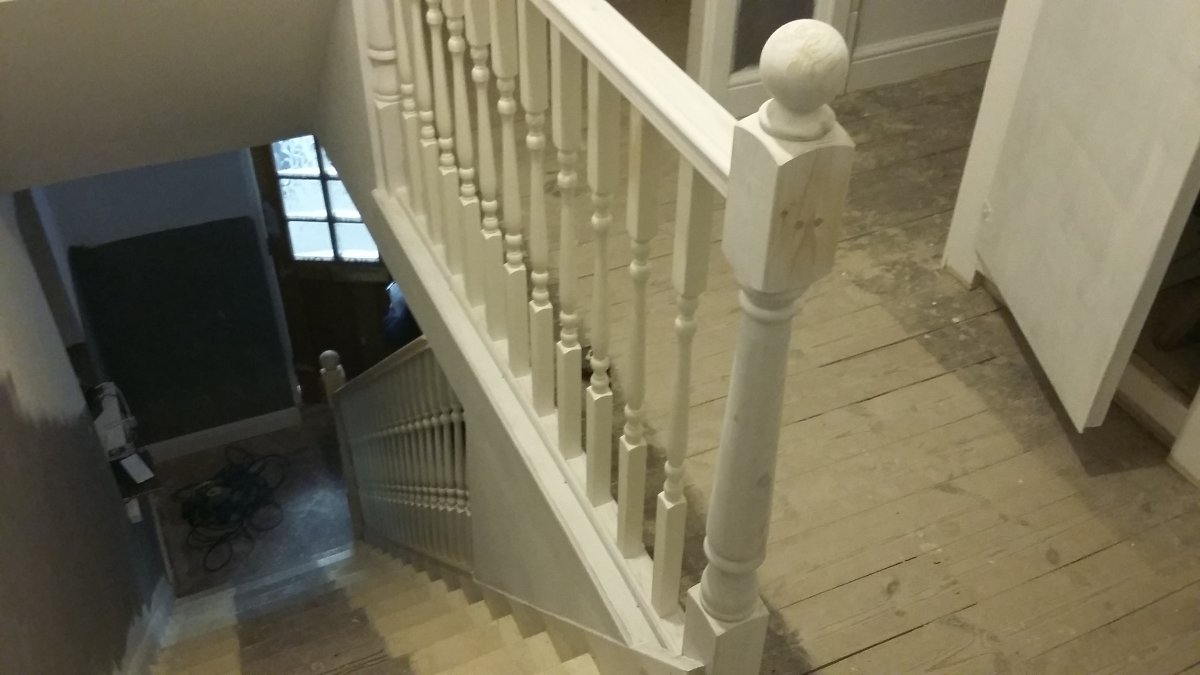

20161022_115552.jpg bottom of the stairs
20161022_115612.jpg looking up to the landing

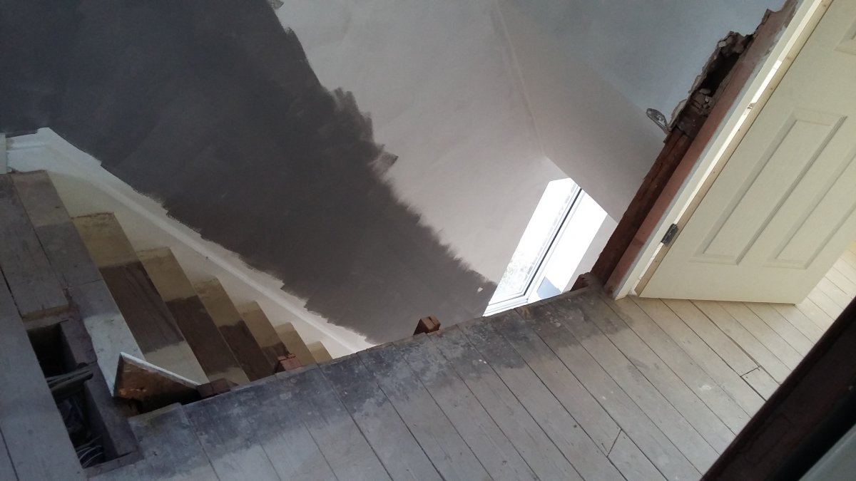

20161022_115629.jpg the landing

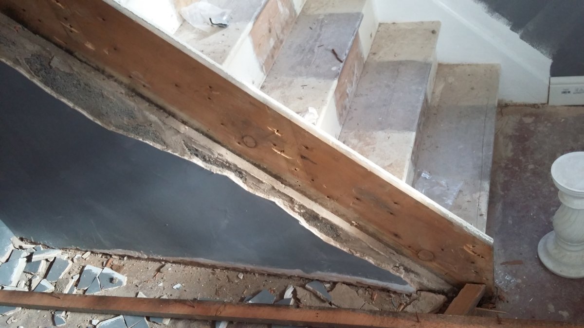

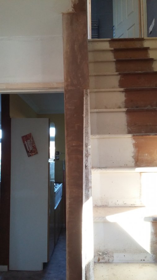

20161022_122216.jpg view of the string
20161022_122407.jpglooking up
20161022_122422.jpg looking down
20161022_122452.jpg missed a bathroom pic
20161022_122459.jpg another
20161022_122605.jpg another

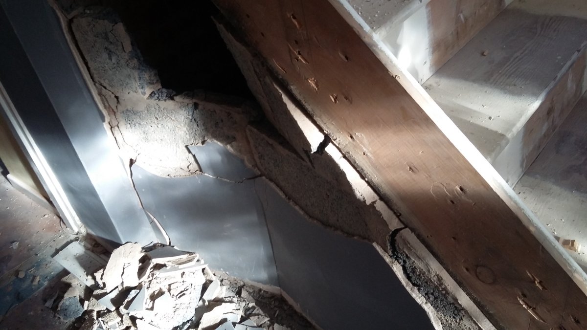

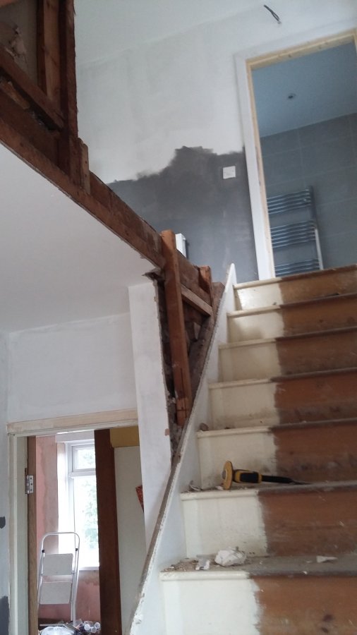

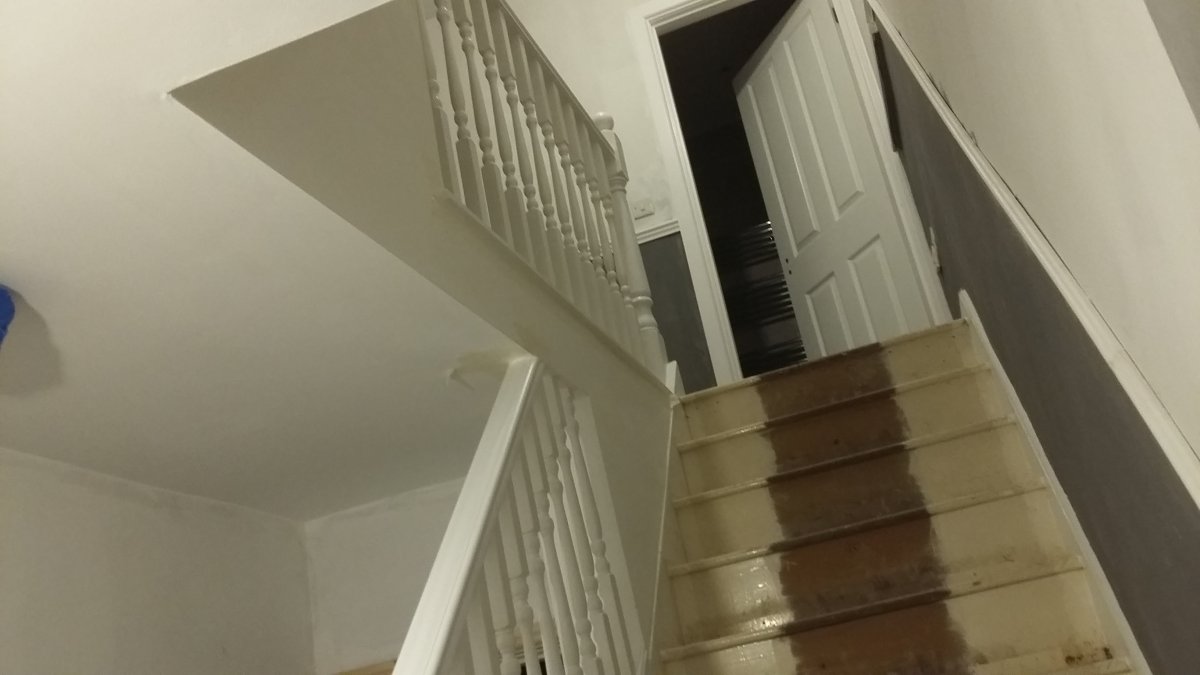

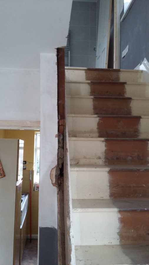

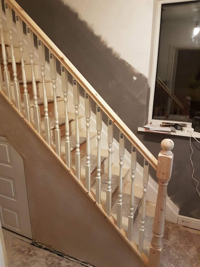

Ok my worry with the stairs is with the string. The wall below it protrudes by about an inch. The wall is unnecessary and the area behind is an inaccessible void. It would be a pain to make the transition between wall and string nice. I'm thinking of removing the wall and rebuilding in stud flush with the string with a little door in it, then plasterboarding up to the spindle base rail. Of course this throws up the fact that the understairs void will need plastering and the concrete floor finishing. Argh!
In other news cutting those 2x2s flush with the floor has blunted my saw. Nails everywhere!
Hells bells its been a while.
I decided to take out that wall. The joiner has fitted the newel posts and now we're waiting for the plasterer to come and refinish the whole stairwell and the new understairs opening. We will put doors on it and frame out an opening etc. Joiner has agreed to make us some triangle doors!

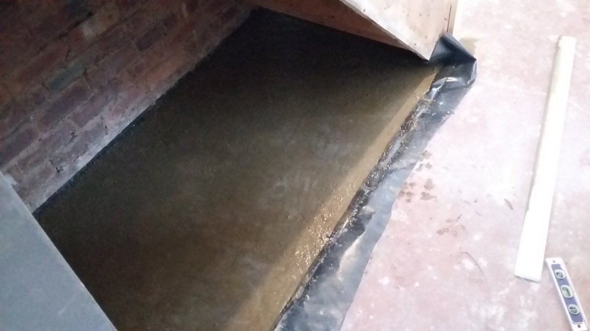

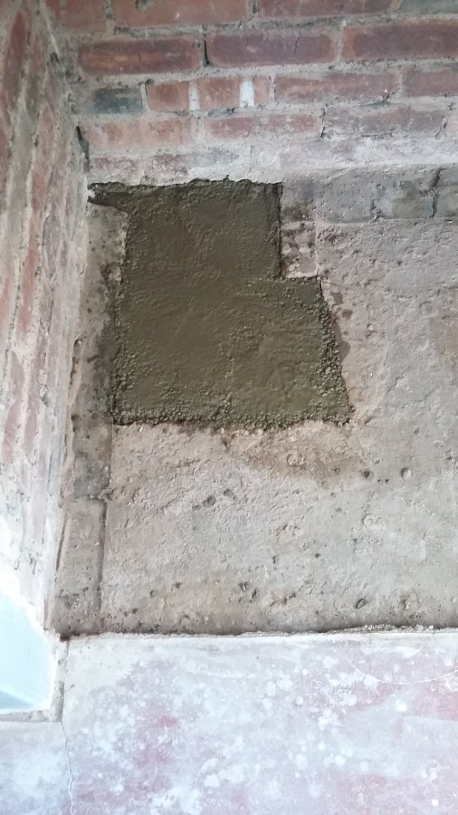

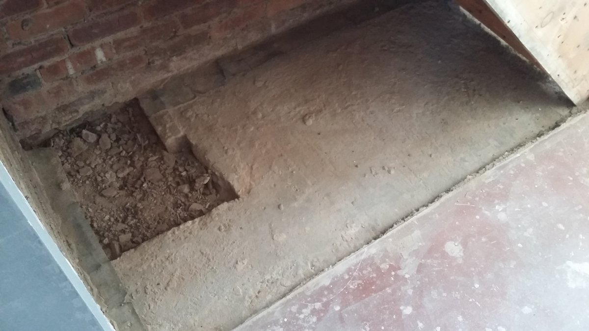

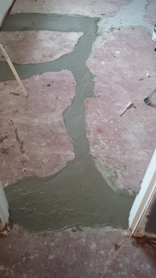

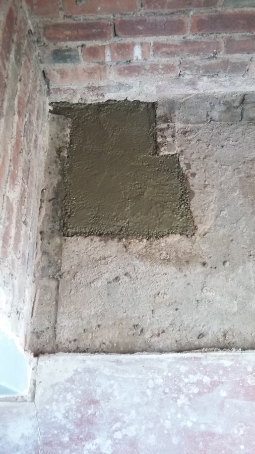

But before all that I need to level the floor. the floor in the understairs is the bottom layer of concrete, the rest of the house appears to have an inch of screed and half inch of magnesite over it, with a bitumen damp proof layer under the screed. So I've bought 8 bags of concrete to level it out, but b&q dont appear to sell any sort of dpm so I will have to source some elsewhere.

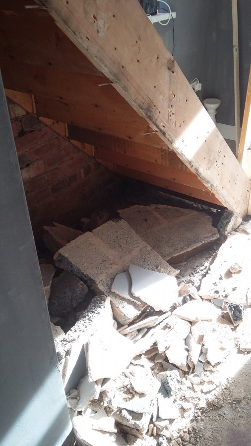

The big hole in the concrete - this was framed with bricks and I can only think its purpose has something to do with the electricity cables as they appear to curve in this direction as they leave the service fuse on the other side of the wall. I'm not digging for them though! And I'm not leaving access either - this hole has been inaccessible for 60 years and access hasn't been needed.

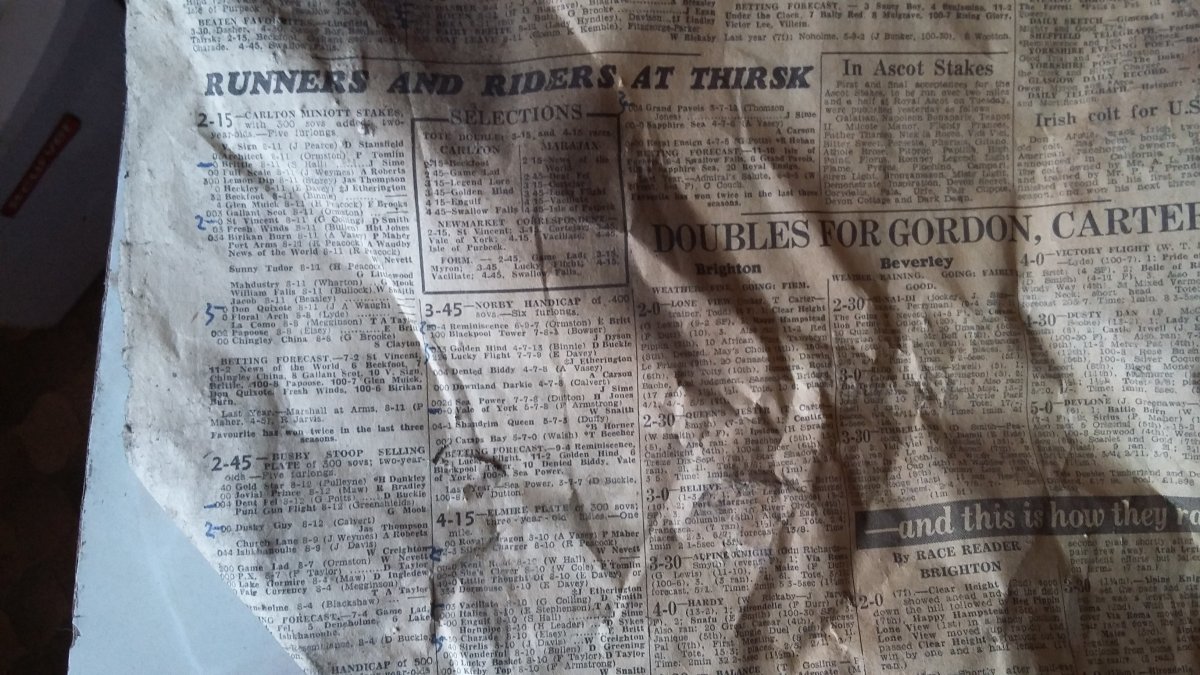

I found an empty woodbine packet and a page from a newspaper with markings on it showing what bets the builder was going to place on the horses at Thirsk! Sadly I cant find a year on it. The top of the page is missing.

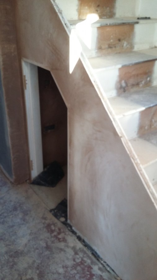

So since the last set of pictures, the joiner has finished the stairs and fitted a door under it. The plasterer has been and made all good. Electrician has first fixed under the stairs (light and socket) but not been to finish yet cos he had all his gear nicked out of his van.

20161105_092813.jpg 20161106_130013.jpg work I did to finish the concrete floor under the stairs.

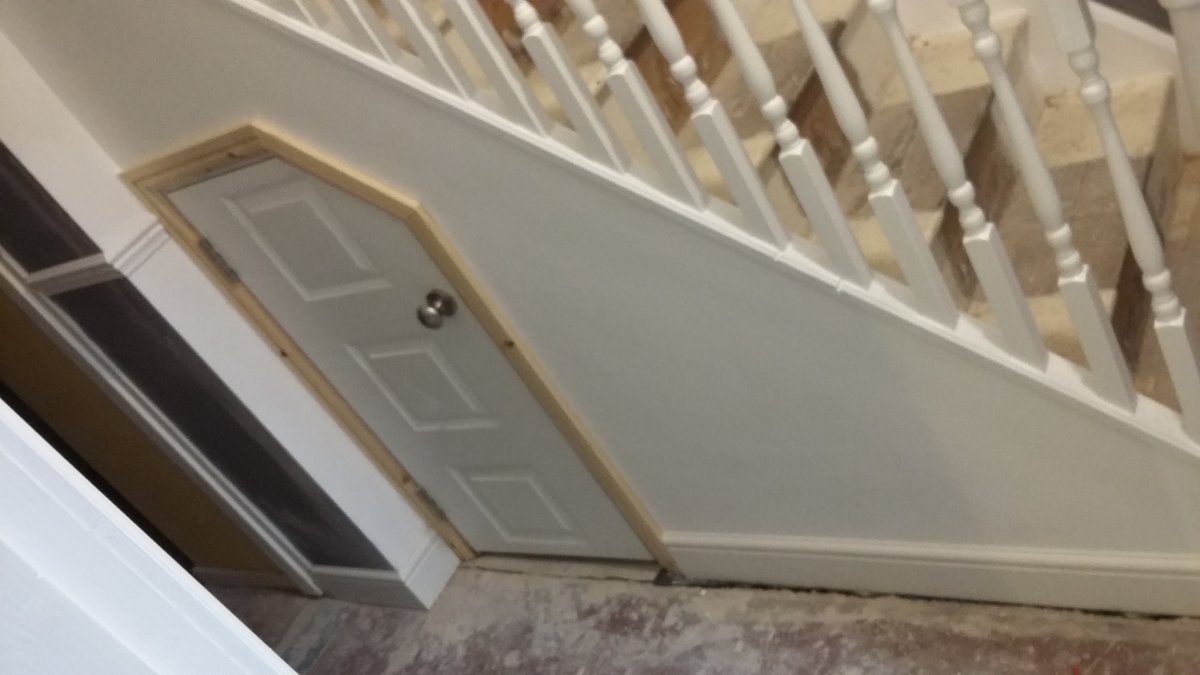

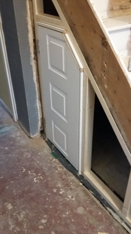

20161110_143408.jpg 20161120_152614.jpg 20161128_135945.jpg the new wall under the stairs, and the little elf door.
20161128_141309.jpg showing the plaster finished, and the wall built with a slant off to the left to fit the staircase in! Really!

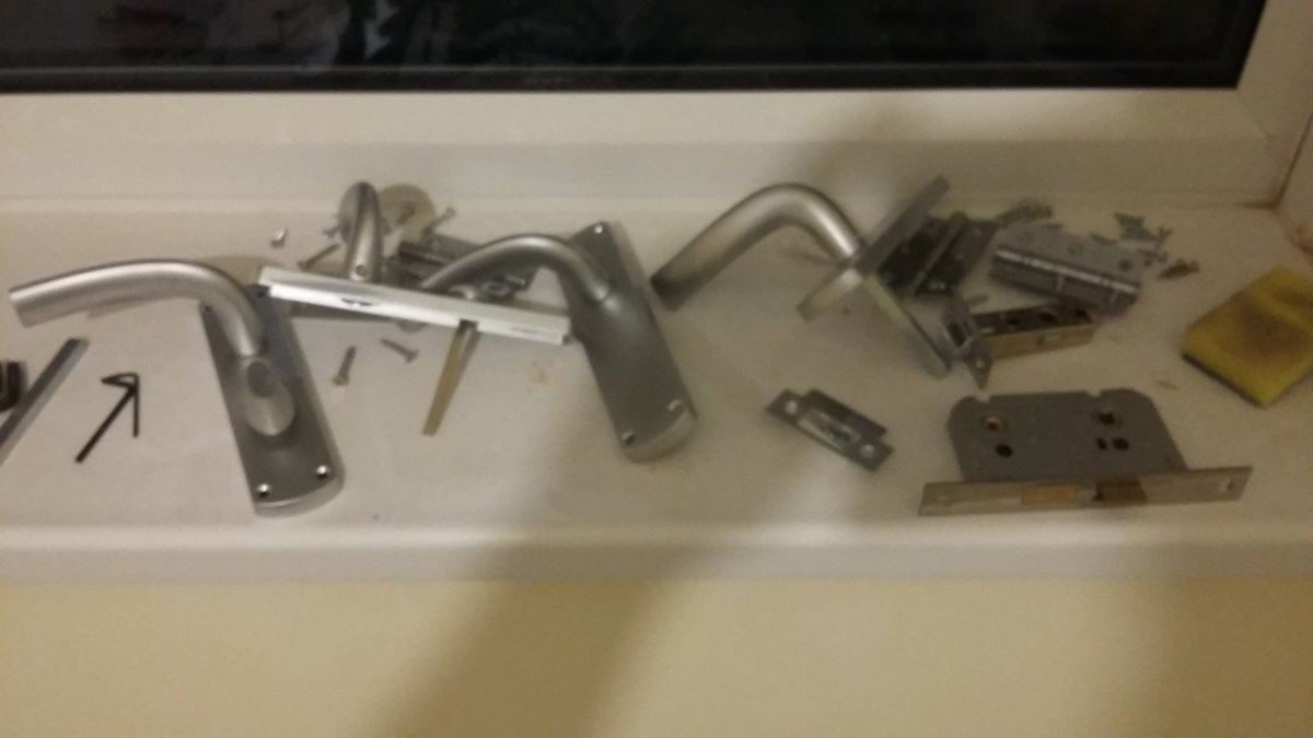

20161213_163831.jpg 20161213_163858.jpg Painting the doors, I've taken all the metalwork off to prevent them getting painted! I was surprised how dark the doors were to say they were meant to be primed white.

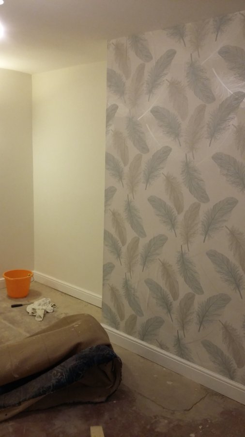

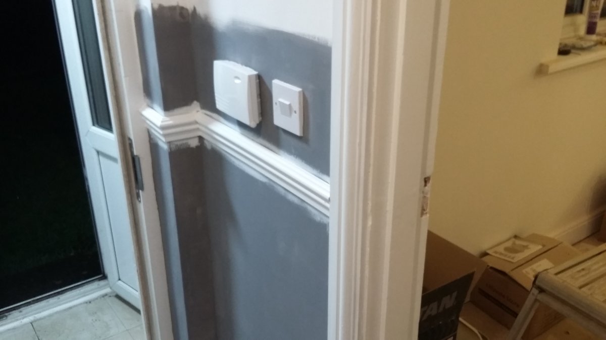

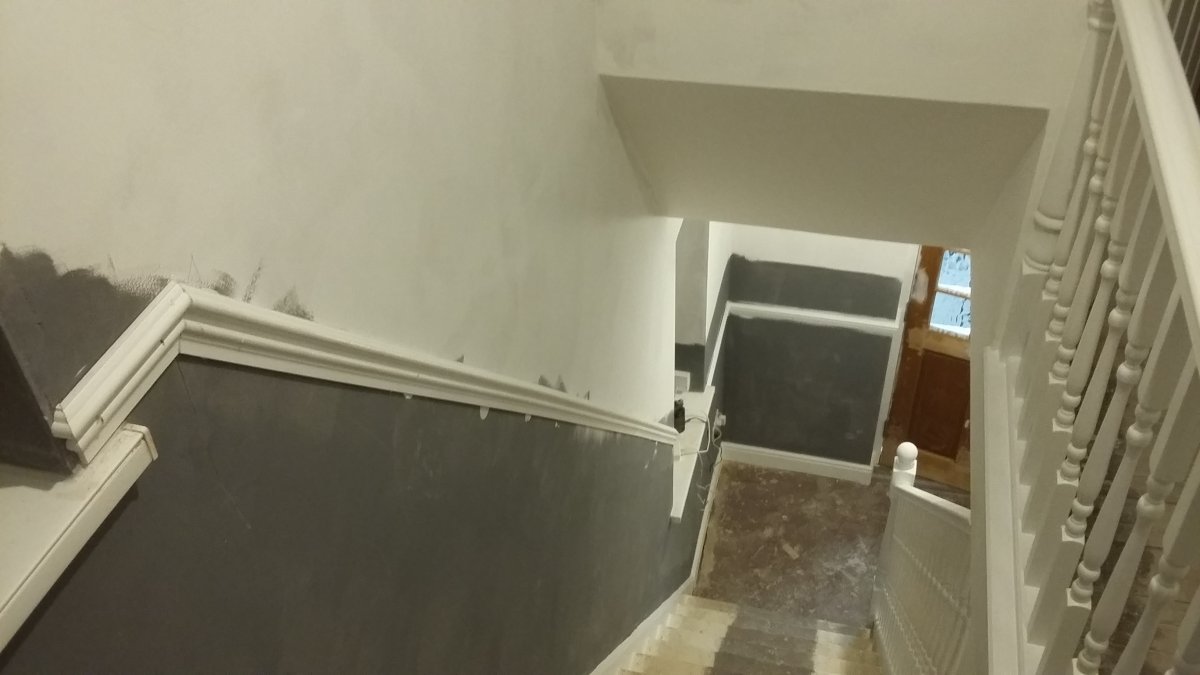

20170117_192437.jpg I've been busy painting the staircase. What a job.
20170117_192352.jpg Daughters bedroom.
20170117_192338.jpg Dado rail.
20170117_192322.jpg Living room.
20170117_192144.jpg Elf door under the stairs, all finished just needs painting. Daughter has taken a liking to this little room.

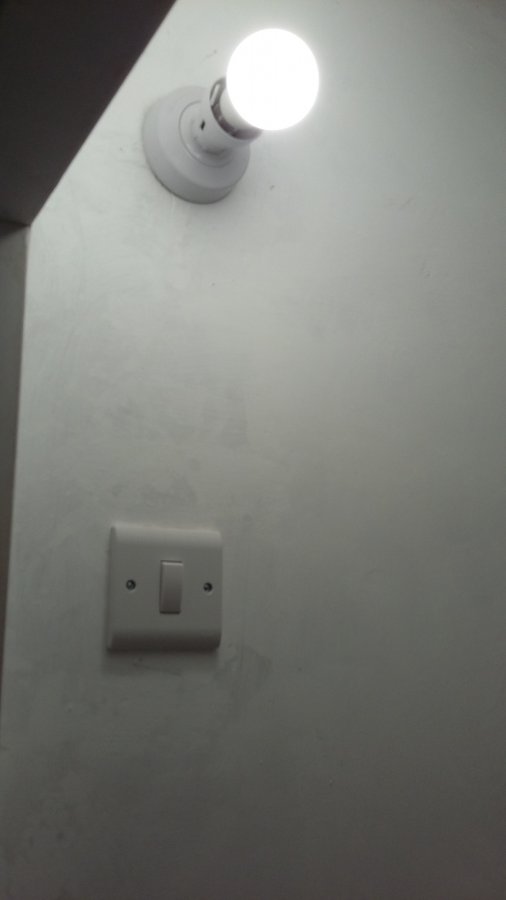

20170117_192208.jpg I stuck a 9 watt LED light in the little dwarf room, you could film a tv show in there now.
