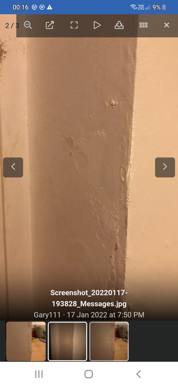

How can I stop damp coming through wall?
@noseall has the answer in post #48. It's salt contamination, which once in the bricks/plaster, draws moisture from the room. The answer is to isolate the salts from the room. The easiest way is to strip it back to brick, and fix plasterboard using foam adhesive (that the salts can't cross - if you use wet dabs the salts get drawn through to the surface of the PB as the water in the dabs evaporates). Reskim and job jobbied.
These guys suggest a membrane to isolate https://www.tracebasementsystems.co.uk/post/damp-chimney-breasts, but I've found using foam adhesive works well in my house.

OP,
As mentioned above in a couple of posts: what your pics show is hygroscopic chemicals that originate in the flue or flues in your chimney breast.
1. Open any blocked fireplace, & sweep the flue.
2. Also sweep any open fireplace flues.
3. IOW. sweep all your flues.
4. Your rear elevation pic shows soot penetrating the brickwork at the base of the stack - ie it shows unswept flues, & possibly unventilated flues.
5. Flues need through ventilation from fireplace to stack terminal.
6. Mentioned above is the possibility of water penetration at the abutment of the (failing?) extension roof & the rear elevation? Its a possibility?
7. From the affected chimney breast remove all plaster back to brickwork.
8. Render the chimney breast with a 3:1 mix of sand & NH lime - skim with a remedial finish such as Limelite.
9. Dont use any slurries or additives - slurries can cause condensation. So can a cement mix.
10. Any use of any kind of plasterboard can cause other difficulties.
