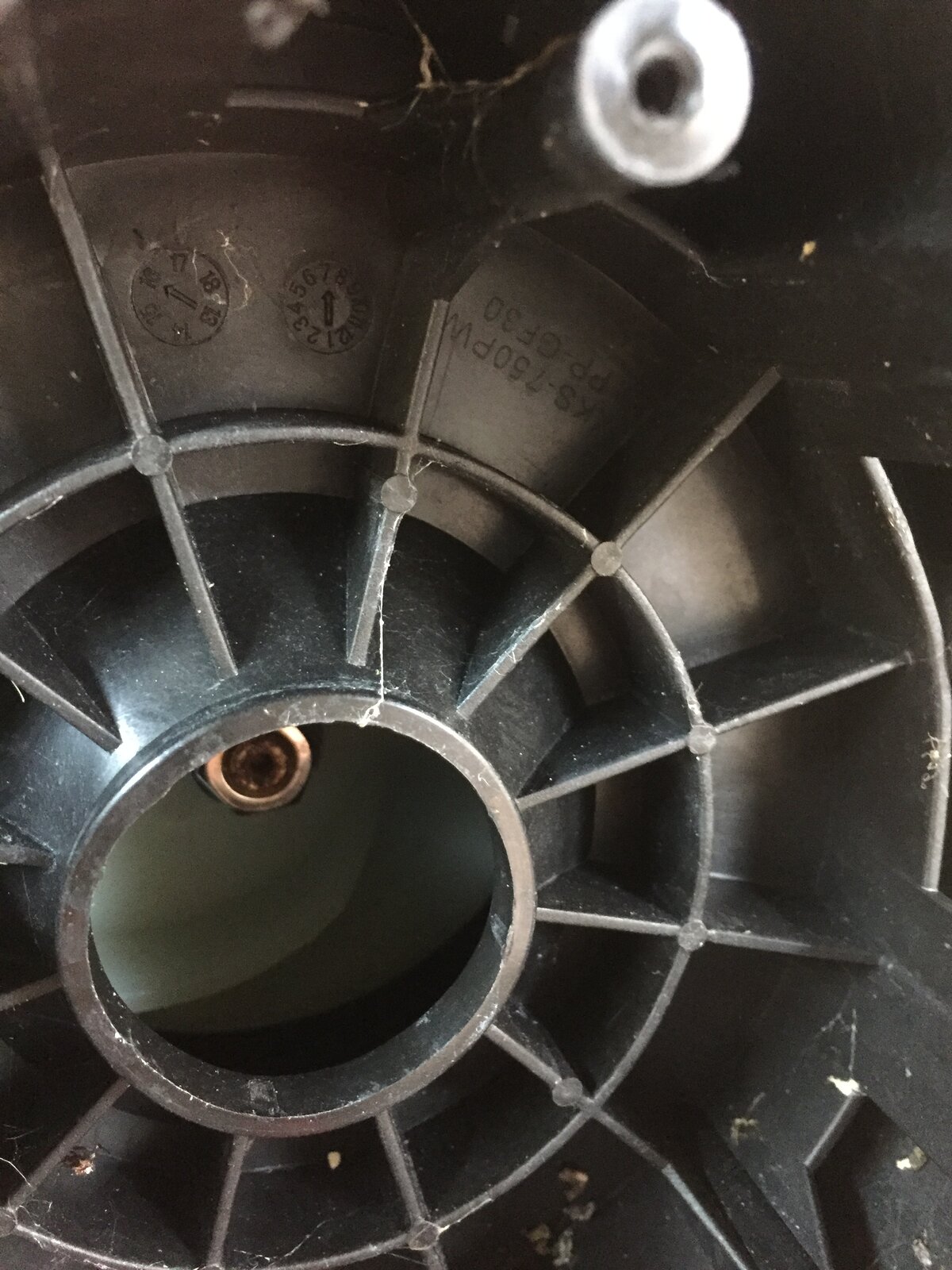

If that were the case, then I'd find it much easier to understand. However, the impeller vanes are actually about 50 mm above the plate containing the 'input hole' - in fact, close to the top of the output port

That height is so it gets a good flow of water and helps to stop too much dirt being dragged up from the floor of the container it is set in, however, where I have come across this in the past there is usually an insert plate quite close to the vanes to help create the drag of the water. My own subby is similar to the one in the earlier pictures and has such a plate which also helps stop prying fingers being caught, (though in my opinion anyone who sticks their fingers into a spinning pump/motor/fan deserves to injure them).

I've just had a quick look at mine, it's hard to see detail but the space between the vanes and the inlet plate looks to be 5 to 10mm.
For a domestic single phase that not bad. On industrial ones they are not much closer. On the flgyt pumps with a volute bowl they don't have that plate at all, just a few short stumpy protrusions to create a small gap between the bowl and the surface it stand on. Biggest I worked on was approximately 10', (3 metres), tall and had to be stood upright on the back of the wagon as the seal chamber was filled with coolant oil. This had to be done at the workshop even though there is/was a law against transporting equipment containing oil for fear of spillage. It was nerve wracking to be standing on a ladder propped against the pump, to check it fitted under the roller doors as the wagon pulled out of the workshop. Happy to say we had about 3" to spare.

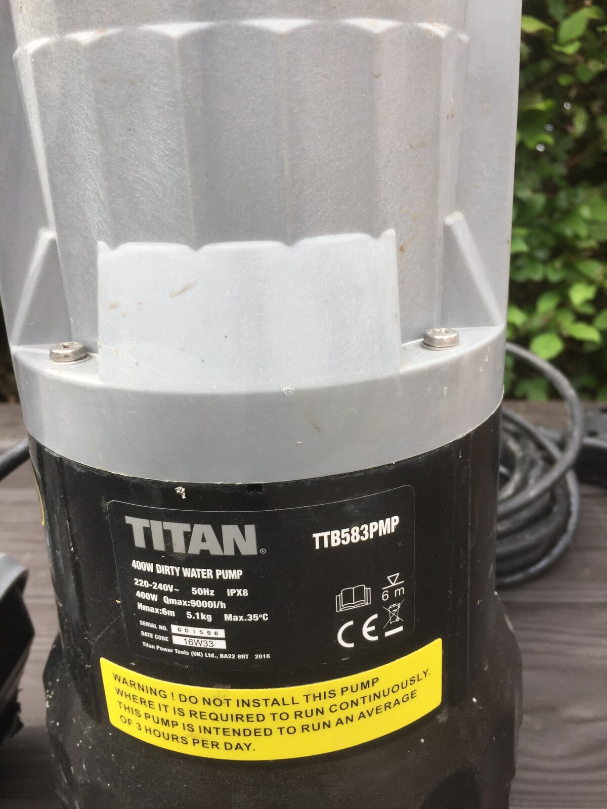

This is mine. Can pump up to 9,000litres per hour and up to 6metres which is quite impressive.
The impeller blades are tapered and at their nearest point to the base it about 5mm gap, (difficult to measure through such a small hole).
The inlet hole is 35mm diameter and the outlet is approximately 17mm bore so twice as much input as output. The force is reasonable but the volume is amazing. It can empty a hot tub in about 20-30 minutes and I used it to empty my above ground swimming pool, (18' x 12' x 4'), in about 3 hours.
Think it cost £50 from SF a few years back.

I'm happy to say that's a different quality device to mine, about twice as fast and I know from pumping out a basement getting it over 4m slowed it down a fair bit. It was half the price too so a classic get what you pay for.

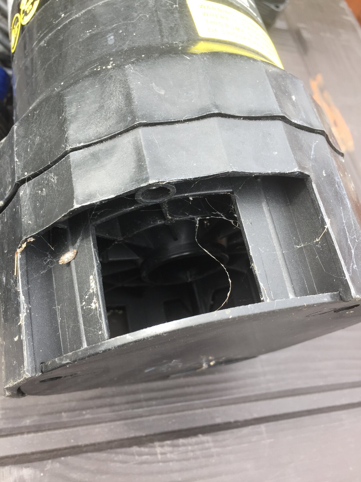

The two I dismantled yesterday were identical 400W Silverline ones, similar price and external appearance to conny's Titan one.

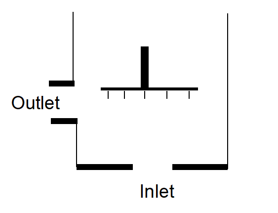

The impeller blades are almost exactly 50mm from the base with the 'inlet' hole in it (easy to measure with that base removed), and 5mm or so from the top of the outlet orifice. The impeller is horizontal (not tilted), so all parts are 50mm from base/inlet. It's vanes/blades (per photo I posted yesterday) are tiny (about 7mm 'wide/high') and curved, but the same width/height throughout their length, so not tapered. The inlet and outlet orifices are about 30mm and 34mm diameter respectively, and there is no 'shaping' of any sort on the inside of the chamber on the approach to the outlet orifice. The impeller, and its vanes/blades is both horizontal and totally symmetrical, so it will be trying to fling out water equally in all directions (horizontally), but only a very small proportion would 'hit' the outlet orifice (the diameter of that orifice is only about 8% of the circumference of the chamber).
I have to say that what I had expected to see was an impeller (or 'turbine') with very much larger blades/vanes than this, and
EITHER the impeller/turbine in an 'enclosure', the 'output of which was connected to the output port, with no 'continuity' with anything else (particularly not the 'inlet').
OR, if the impeller/turbine were not so enclosed, at the very least some sort of crude valve on the inlet (maybe a rubber flab or a 'ball in a cage'.
... but I'm seeing neither of those. If the design I'm seeing had been described to me, or shown to me on paper, I think I would probably have 'put money on' (and lost!) it not being able to work as an effective pump, let alone the extremely effective one that it is. My intuition therefore remains very upset, even though I cannot deny the evidence of my eyes!

All the impeller has to do, is produce a differential in pressure and the water will flow. The do this by 'flinging' the water out from the centre of the impeller, in the general direction of the outlet. Gaps are large, because not much actual pressure is needed for the application. For higher pressure demanding applications, tighter gaps are needed with the only way out being via the outlet.
Yes but, as I said, given the total symmetry of everything (other than the outlet), only about 8% of the water flung out by the impeller will be "in the general direction of the outlet".,
As I also said, it seems that (if the pump is in pretty shallow water) it manages to keep a pressure differential of about 0.7 bar (around 10 lb/square inch), which is far from insignificant, between the inlet and outlet orifices, about 50 mm apart.
This is very difficult! I obviously know that 'it works', but everything in my mind and 'intuition' tells me that it shouldn't (at least, nothing like as well as it does work), given everything I've described!
I suppose it must be a bit like currents in the sea. Relatively small and circumscribed high velocity currents can, presumably, result in quite marked pressure differentials between places very close together within what appears to be 'the big wide ocean'!
We're talking about a chamber about 14 cm diameter and about 7cm long, with two holes, 30mm and 34mm in diameter respectively, about 7cm apart. If one raised the pressure within any part of that chamber by any means other than 'flinging water about', I would not really expect any significant amount of water to come in through one of those holes and out through the other.
