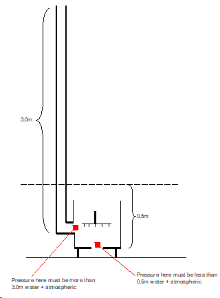

As I also said, it seems that (if the pump is in pretty shallow water) it manages to keep a pressure differential of about 0.7 bar (around 10 lb/square inch), which is far from insignificant, between the inlet and outlet orifices, about 50 mm apart.
This is very difficult! I obviously know that 'it works', but everything in my mind and 'intuition' tells me that it shouldn't (at least, nothing like as well as it does work), given everything I've described!
I suppose it must be a bit like currents in the sea. Relatively small and circumscribed high velocity currents can, presumably, result in quite marked pressure differentials between places very close together within what appears to be 'the big wide ocean'!
We're talking about a chamber about 14 cm diameter and about 7cm long, with two holes, 30mm and 34mm in diameter respectively, about 7cm apart. If one raised the pressure within any part of that chamber by any means other than 'flinging water about', I would not really expect any significant amount of water to come in through one of those holes and out through the other.

But don't forget the water is being thrown away from the blue low ressure inlet and creates the high pressure area in pink and being simultaneousely rotated, outlet is usually formed into a scoop, added to this the cavity is often not round to divert the water out of the void. the later may be verrrrry subtle or non existant
If it were like you diagram, it would be easier to understand. However, as I've said, there is certainly no 'scoop' and if the cavity is not round (it is according to my calipers) or the impeller is tilted (ditto), or the impeller not central (ditto) it must be extremely 'subtle'!
As I've implied before, if the black line in your diagram were the walls of an 'enclosure', then it would all make sense - but that's not what I have.

Is not the only thing that the impeller, and the centrifugal force it generates, does is to increase the pressure in the vicinity of the outlet orifice?
If, with the impeller not rotating, I increased the pressure at that place by any other means, the pressure would increase by a similar amount throughout the chamber, including in the vicinity of the inlet orifice, a couple of inches away from the outlet one, wouldn't it?
Kind Regards, John
Thinking aloud ... I'm coming to think that the explanation probably relates to the reduced pressure created below the centre of the impeller, extending down towards/to the 'input hole', because ...
... if, with everything else unchanged (including connections to the output port), I removed the impeller, and then created an extra hole in the casing opposite the outlet port, if I then 'pumped' a jet of water in through that hole (e.g. from a hose connected to mains water), then I would expect that most of the water would exit the chamber through its 'inlet' hole, since that represented the 'lower impedance' exit from the chamber - and I would expect that to largely remain the case even if my jet of water was directed straight at the outlet port (thereby exactly emulating the effect of the impeller in 'flinging water out' towards that exit).
If that is right, the the only difference from the actual situation (with the rotor present and rotating) would seem to be that region of reduced pressure below the impeller and extending down towards the 'input' hole.
Am I perhaps 'getting a bit warmer'?? (even though I find it difficult to understand how even that is 'enough' to achieve the performance we see!)
