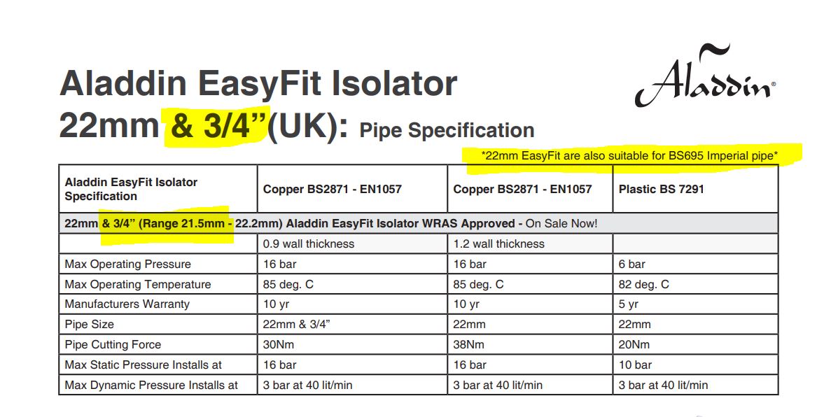

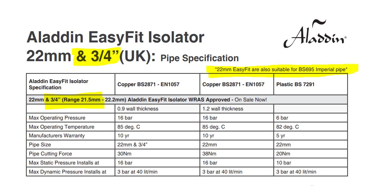

How would this product like? Seems something to consider for this type of gate valve malfunction case?
Definitely something to consider if you have good condition 15mm or 22mm pipe, anything else - lead, old imperial copper, plastic etc and it wouldn't work.

The pipe to the cold water tank in the loft is 22mm, and the 22mm version of EF Isolator valve kit is over £100 - £160 (Screwfix). So it is rather an expensive piece of kit. But if it does the job easy and reliable, then maybe worth it? Maybe I don't have to even look at the incoming mains water pipe in that case? Just install this valve under the old gate valve at the cold water tank, and then stop the water, which will enable the float valve replacement possible?

Yes, to me it seems better idea to install the Easyfit isolator before the old gate valve, and then it stops the water, which will enable the gate valve replacement possible, or just keep using the both valves until the old gate valve fails with leakage. If / when that happens, just stop the water, and replace the gate valve with copper pipe or Lever valve. Yes, this product looks so cool, and seems answer to the stop valves failure situations.

Your mains, with again the old style mains gate valve will undoubtedly be imperial (3/4"(19mm)). You will not be able to use that easy fit kit and be careful about using a new 22mm valve - you will need to use either 3/4">22mm olives (with wraps of PTFE tape) or covert the pipe to 22mm.

Great point. I took my caliper to the loft and measured the outside diameter of the pipe going into the cold water tank, and it was 22mm dot. But I was not sure whether the inside diameter of the pipe must be measured for the correct reading. The outside diameter of the pipe is definitely 22mm.
The internal diameter might be 19mm, I am not sure, there is no way to measure the internal diameter of the pipe because it is fully sealed up to the float valve connection. Something to confirm and claify before going ahead with the work for sure.
