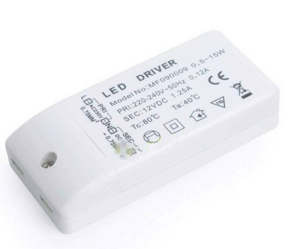

I have emailed aurora and waiting a reply to see if there is a compatible LED bulb.
Some further info:
- none of the bulbs are directly over the bath or shower (there are two separate extractor fan + light units there)
- The 'transformer' in the photo had a brother nearb, these are connected directly to the two spotlights in the ensuite.
Next door, there is a bathroom with three further spotlights, I could not lift the floorboard completely but it looked like *maybe* the bathroom sportlights are also connected to these same two transformers as there were the same thick grey wires running around and I could not see any transformers. The bathroom takes the same GU5.3 bulbs. In other words potentially 2-3 bulbs are connected to each 'transformer' hence higher load than I originally suggested.
This is all much more complex than I expected, so I am kind of resigned now to either keeping the halogen bulbs or getting a sparky in to quote the work. If it means changing everything, the transformers and bulb holders and bulbs etc I assume this is going to cost more than £100 which would not be cost efficient.
It all comes down to your DIY skill, it is very possible you could transform (change) the wiring so that enough lamps are powered from a single unit to load it up to the required amount. Nothing wrong with having 4 x 5W LED lamps from one unit as long as the cables are not too long, most manufacturers state 1 meter, but in real terms you can normally double that without a problem.
Or leave wiring as it is and swap the device what every name you want to give it for some thing like these again what ever name you want to give it looking like this
Yes it says 12 volt DC and the lamps which were linked to say AC, but I would be very surprised to find those lamps needed AC at 50 Hz I expect they will work with DC as well as AC.
Or leave wiring as it is and swap the device what every name you want to give it for some thing like these again what ever name you want to give it looking like this ...
As you imply, we seem to be back to semantic issues/confusion again. That device is labelled "LED Driver" Many people seem to think that a thing called that should be a constant-current source, but this one clearly isn't!
Kind Regards, John
That is a 12 volt DC power supply, no more, no less. Essentially the same as many wallworts used for Freeview boxes etc, except that 12volt wallworts can usually supply 2amps.
I use an old wallwort for the LED strips in my wardrobe.
