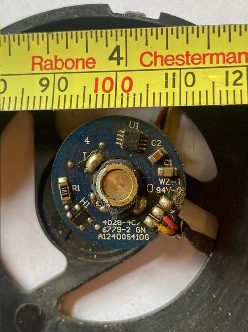

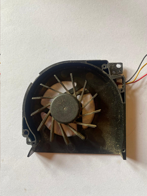

OK. I found an old laptop one - and,yes,it seems that you're probably right. Seemingly 4 windings, and some electronics on the bard the windings are mounted on - a tiny IC, a couple of capacitors, a resistor and a couple of other components. Whether I would (per eric) call than "an inverter'is something I'm less sure about! ...
Kind Regards, John
That is what is known as a brushless dc motor. The coils are energised in turn, by sensing the position of the rotor, which is fitted with magnets. +5 or 12v, ground, speed output, and a required speed input on the four terminals.
That is what is known as a brushless dc motor. The coils are energised in turn, by sensing the position of the rotor, which is fitted with magnets....
Yes, I realise that - but, as I said, I'm not sure that I would describe the electronics that do that switching as 'an inverter', nor would I be probably describe that switched output as "polyphase AC" - but perhaps I'm in a minority :)
