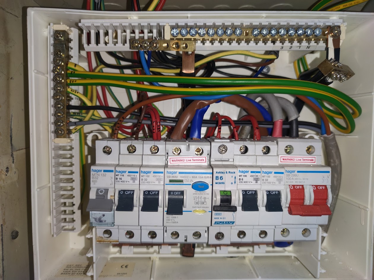

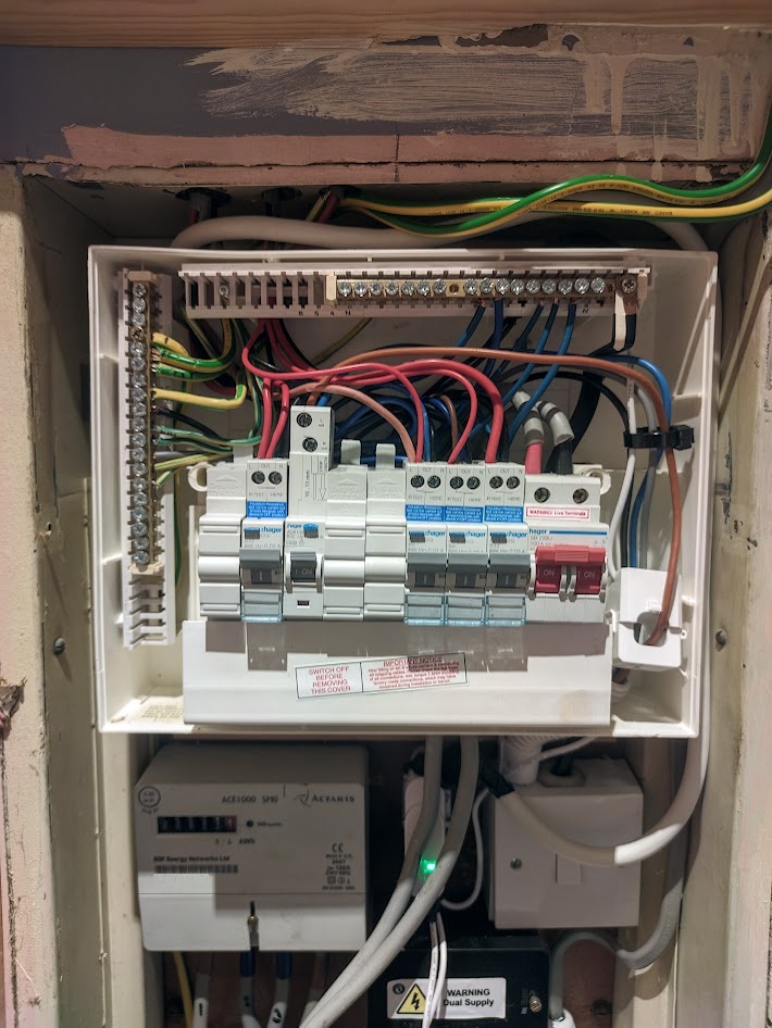

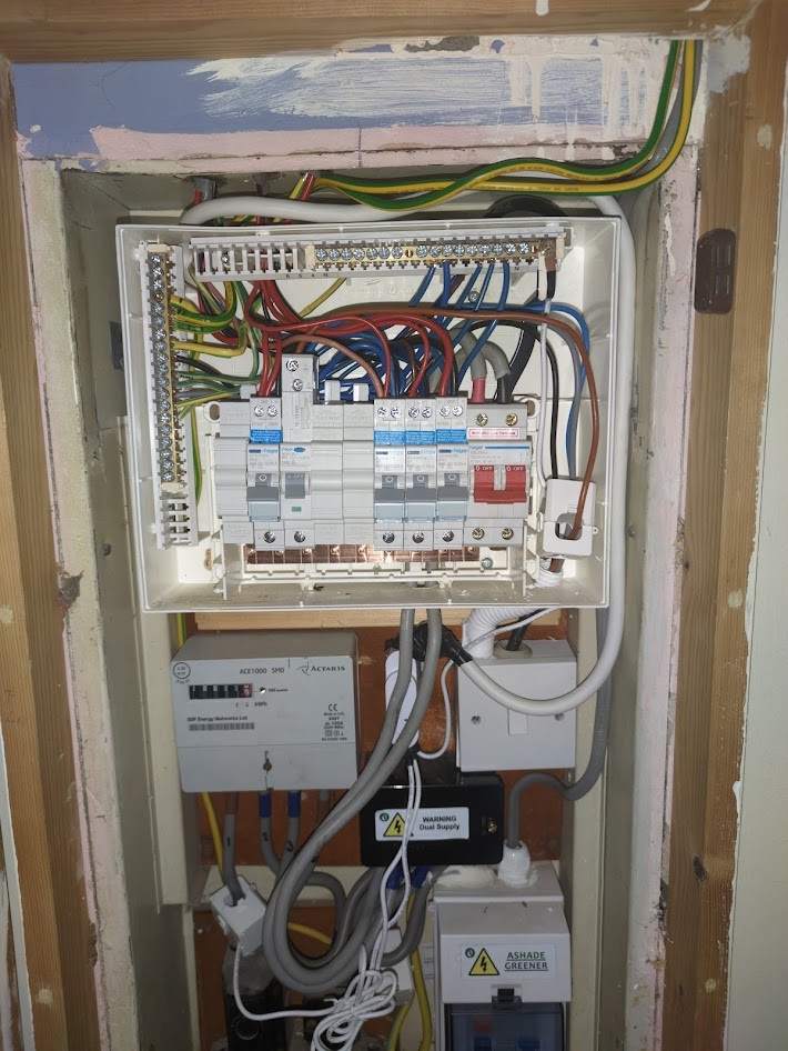

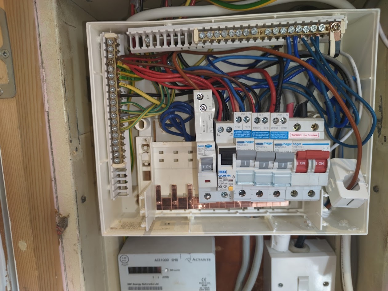

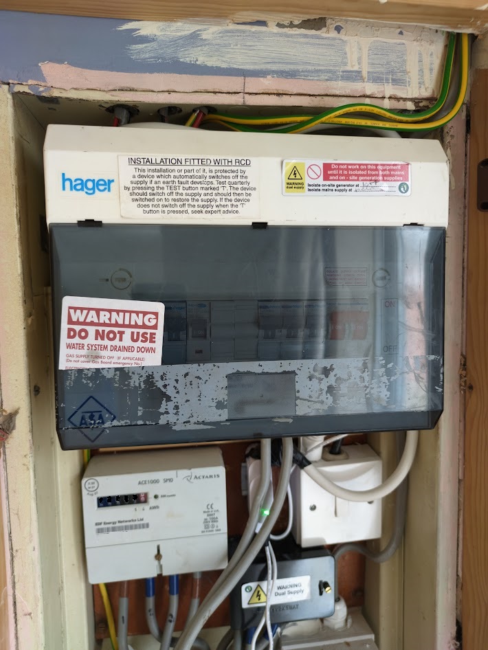

See a photo of the finished CU below.
JLE_20230328_172549_10Tp JOLE 84FS.jpgJLE_20230331_162429_10Tp JOLE 84FS.jpgJLE_20230418_200241_10Tp JOLE 84FS.jpgJLE_20230421_124758_10Tp JOLE 84FS.jpg
BeforeIn betweenAfterAfter (with cover)
Thanks again to everyone who helped!

- I wanted to install a Shelly3EM in the consumer unit and got started on it before realising that the silly busbar design of my CU wouldn't allow me to fit it in there.
- I installed additional solar panels and wanted a type B RCBO for this.
- This seemed more feasible DIY than installing a new consumer unit since I don't have an isolator before the CU. Have heard of others fitting an isolator DIY with live voltage. I decided to give this option a pass.

You completely ignored the advice sticker on the Busbar cover, the main switch is still on.

How did you get round the issue of the bussbar not fitting?
It did fit before, but wasn't held in place correctly because of the BG breaker, which made it fit awfully crooked. I replaced the BG breaker and followed the advice from the previous thread to more or less use the same slots for the RCBOs as where the MCBs were. The plastic clips don't fit around the busbar, but based on the previous thread this doesn't have to be an issue as it is firmly held in place by the RCBOs. They are very brittle anyway and seemed to serve more as a guide for positioning the busbar correctly. It's not going anywhere unless multiple RCBOs are removed, which is only ever going to be done by someone who understands this CU.
I think it's a good compromise because the load isn't split over two busbars anymore, so it makes sense that the new busbar should have larger dimensions since it should be higher specced.
If you're referring to the "In between" photo, you're right. But that's an old photo which was already discussed in another thread linked.

So correct me if I'm wrong but did I not offer one technical suggestion?
I suggested you obtained a copy of the Shelly MI as is contains some useful advice And even that you can't be bothered to do, instead you wrap plastic tape round it and produce this ****
and you wonder why I criticise?
