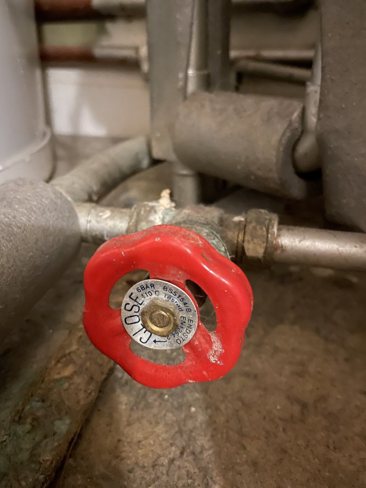

After a bit of Googling of bypass valves in my dinner break I think I might have found it. Between the pump and the 2x zone valves I found a 3rd pipe off which joins to the return pipe coming out of the hot water tank. On that pipe is the valve below, it’s closed currently which is clearly wrong, but can someone tell me if it’s a pressure valve and is there a specific way to set it?
Still a little confused because if this being closed is the cause I’d have expected leaving the rad zone valve open last night to have also seen me through the night without any banging.

This bypass valve looks to be a standard gate valve and it is closed. Does it need to be opened and if so how much?
