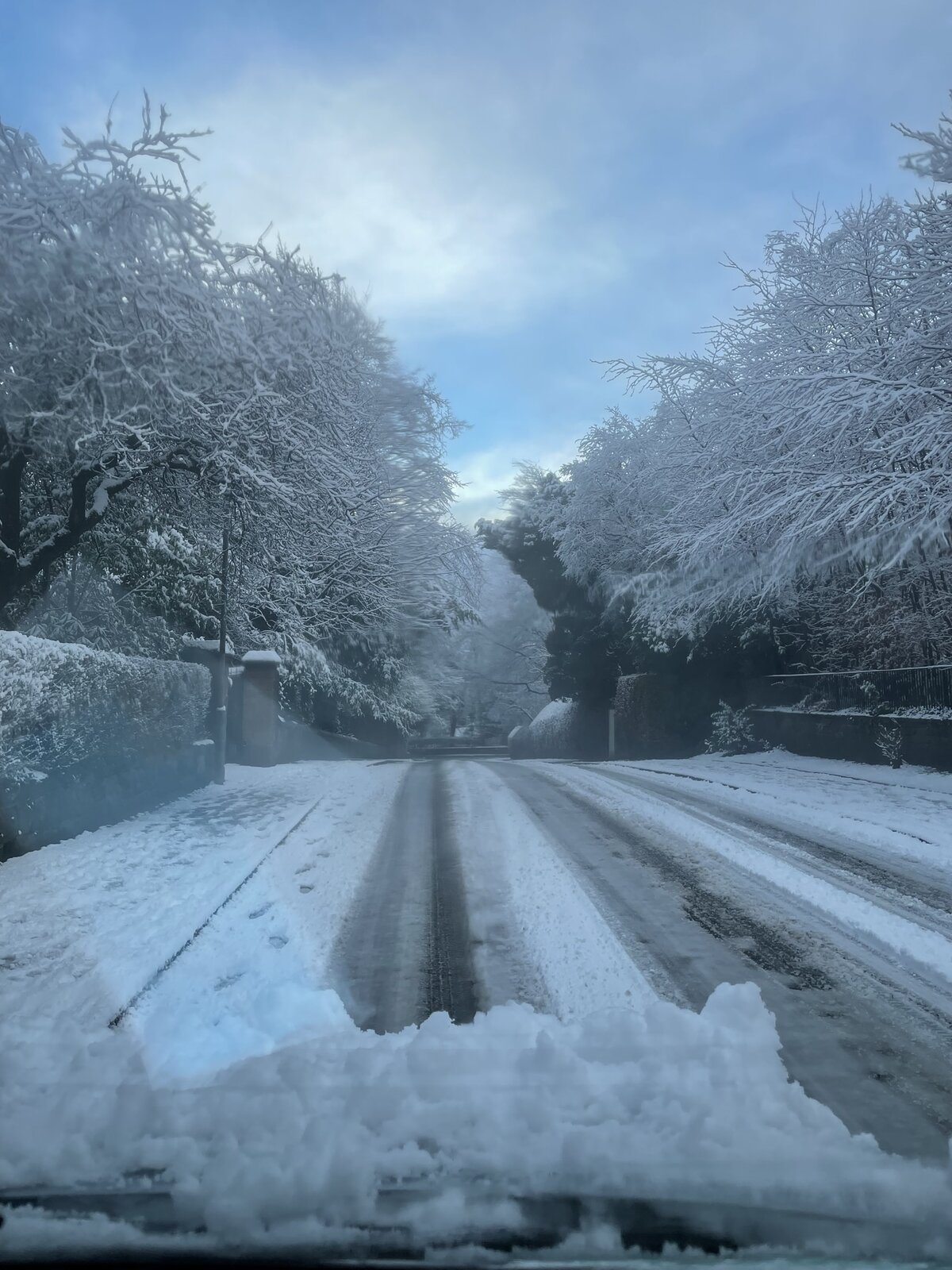

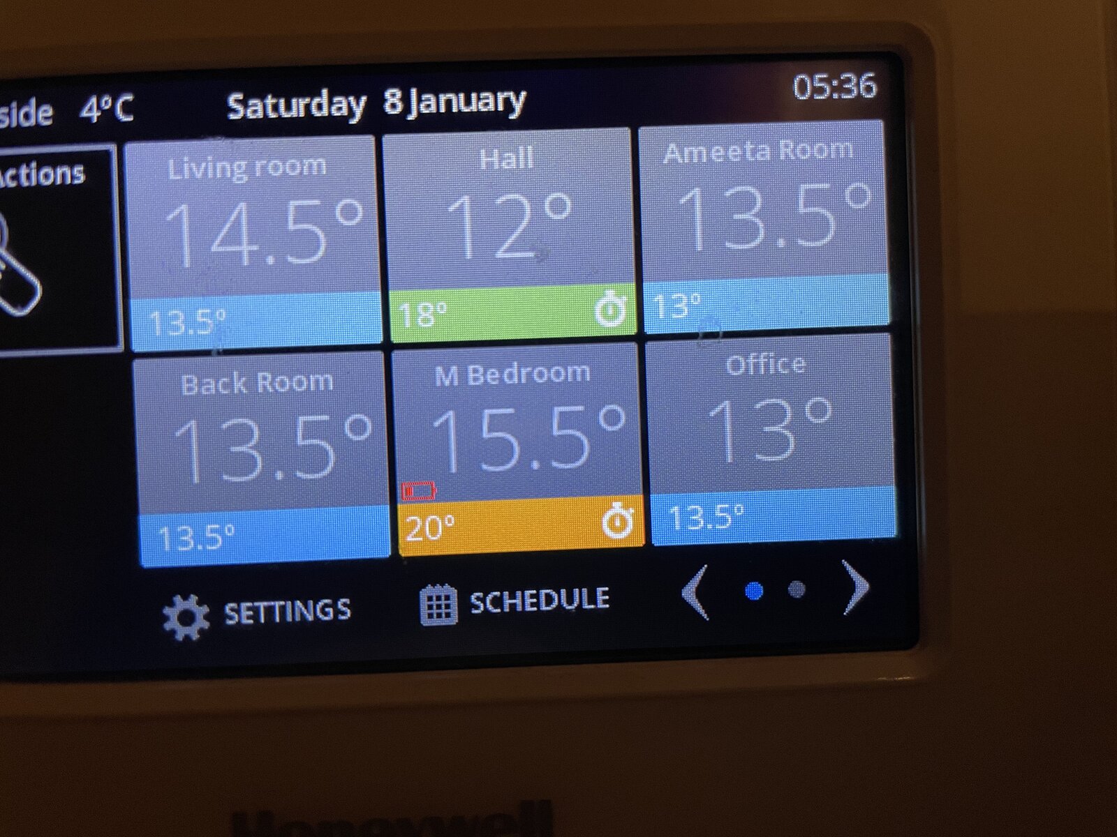

See what happens tonight- mind, it's warming up here- was -3 this afternoon, it's up to 7 now :)
Picture below shows my suggestion works like a charm.
Hall temperature prior to switch point was 12 degrees same as set temperature over night and weather was as in the picture above
