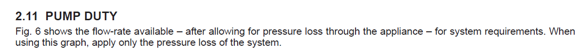

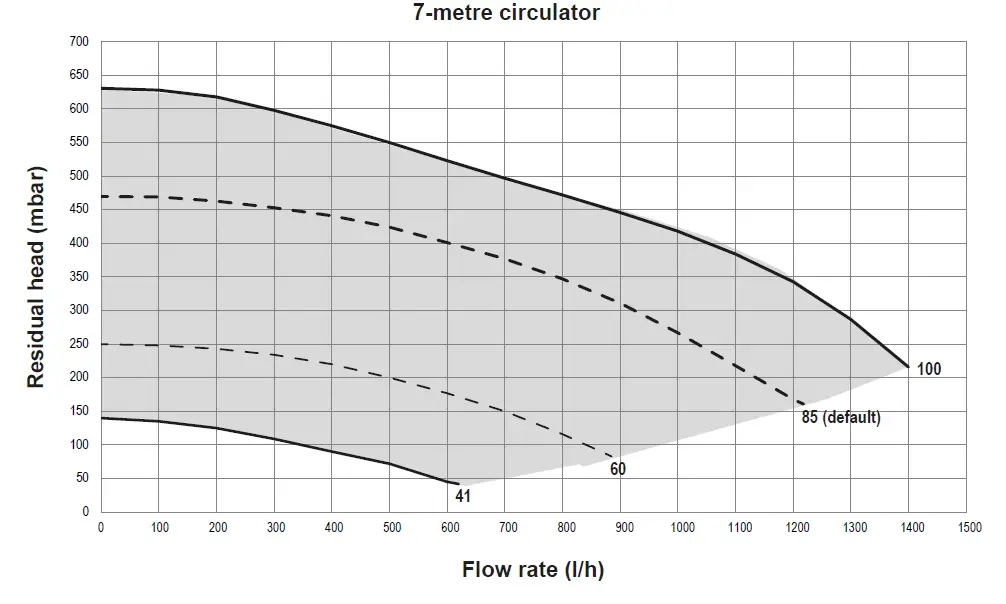

The "head" of a central heating pump is a measure of its power to force water through your central heating system i.e. the boiler, pipes and radiators. These days it is measured in mbar, bar, or metres of water. It used to be measured in inches or feet of water.
When you have a combi or system boiler, where the pump is built in to the boiler, they usually use the term "residual head". This is the amount of power the pump has left over, after it has forced the water through the boiler itself, to circulate the system water through the pipes and radiators.
So say you have a pump which can give 4m of head at a flow rate of 20 litres per minute. And say that at a flow rate of 20 litres per minute it takes 1.5m of head just to push that water through the boiler. This would mean that at a flow rate of 20 litres per minute, there would be 2.5m of "residual head" left over to push the water through the pipes and radiators.
Below is a graph which I think is from a Vokera. It shows the residual head vs flow rate for various pump output percentages.
That's genuinely helpful.
I wasn't familiar with the term 'residual head' but can see it's meaning from what you've kindly said.
Having said that I still say I don't see it openly displayed by manufacturers in their literature. Furthermore I'm unsure how, in practical terms, I should use the information if it was.
I remember in my training, in 1974, amongst many other topics we had to learn we had classes entitled Hydraulics. We seemed to work in feet, inches and gallons in those times and I can assure you that we were given to understand that a gallon of water weighs ten pounds.
Using that graph from a boiler with an unusually powerful pump for Vokera on the Y axis you see the available head.
Below you see flow rate on the X.
To get the flow rate for a condensing boiler installation multiply the specific heat capacity of water by the temperature difference across the flow and return then divide the result into the kW you need so, 4.2x20= 84 divided into 8kW = 0.09l/s x 3600= 342l/hr.
If the system has a resistance of 2m strike a line across to see what flow rate it will actually provide against the resistance if left unaltered and it's nearly 4 times that which is required therefore the water comes back to the boiler too quickly and the delta T narrows from the desired 20 to 5 or 6 degrees.

Yes, residual head, one would think, is the head available after the boiler HEX, I have seen remaining head stated as well on some boiler MIs,

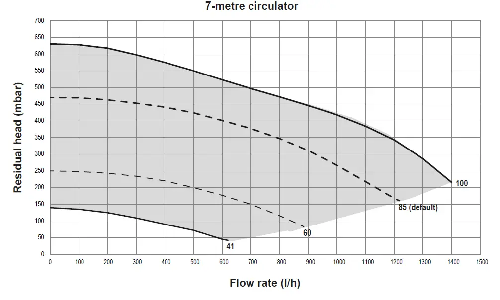

Looking at a typical "7M" head pump like a Dab Evosta 4-7 which has a closed valve head of 6.8M, its pump curves show a flowrate of 20LPM (1.2m3/hr) at a head of 4.7M, now IF this is typical then a residual head of 3.4M at 20LPM (above) means that the boiler HEX loss is only, 4.7-3.4, 1.3M, this seems extraordinarily low IMO, Vokera, though, do state, quite clearly.......
