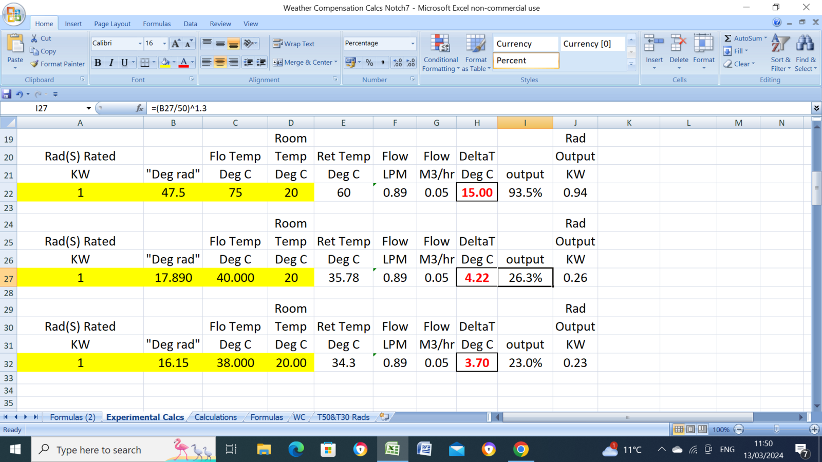

Its fairly basic, gas boilers can't really deal with very low flow temperatures once the heat demand is less than the boiler's minimum output as they fire up at ~65% of max output and will exceed the target flowtemp by 5C = burner trip and recycle, then, after the recycle time has elapsed and they refire, the flow temp will again exceed targrttrmp+5C before they can modulate down, more anti cycling. Reducing the flowrate will increase the dT but the rad(s) output will then be even less and even worse making it yet more difficult to successfully refire as the boiler requires as high a flowrate as possible to refire.
Assuming dT at almost full output is 15C then you just can't avoid running at a dT of 5C or less with WC once the flow temperature is less than ~ 40C, it goes down to 3.7C with a flow temperature of 37C don't know what the minimum output of your boiler is but just assuming 6kw then the rated outout of your rads must be ~ 6/0.23, 26kw to avoid the boiler cycling and its going to be very difficult for it to fire up without repeated cycling at a flow temperature of 36C.

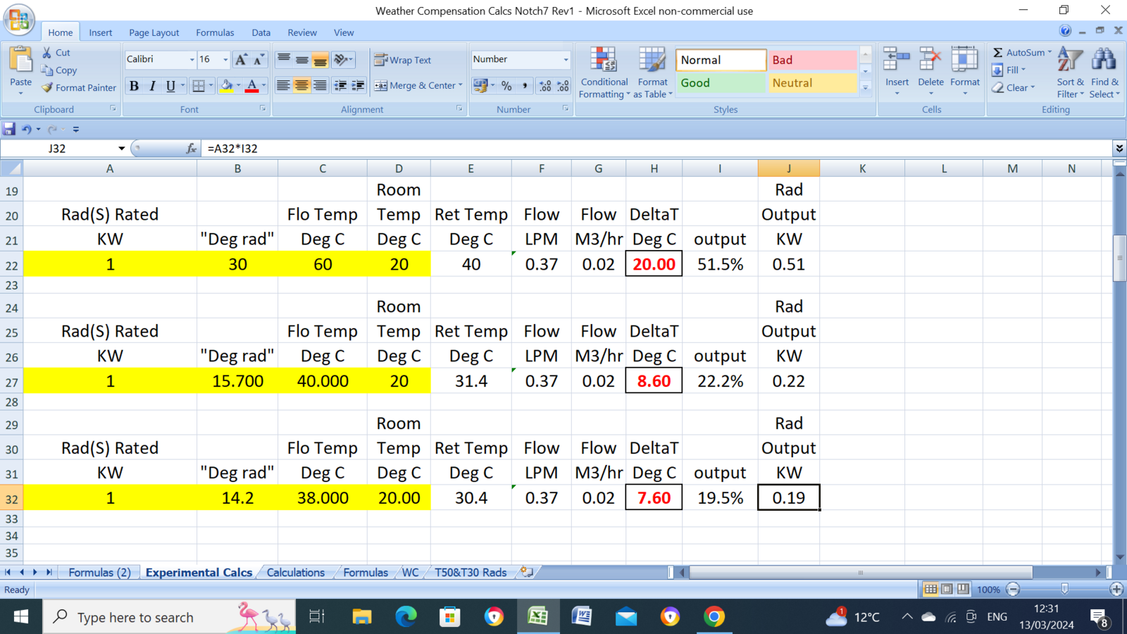

Thanks. That's so interesting. I'd really like to see the same calculation but starting with a dT of 20C at a flow temperature of 60C?

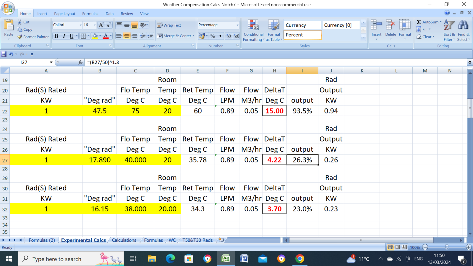

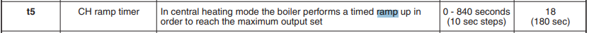

Intergas have step modulation
Step modulation is set to function (factory setting) so that the power/speed is increased gradually from the minimum (parameter c). This provides the best CH operation.

Anyone who's interested can do their own calcs below, I had to .zip my file to post it. Just change the values in yellow.

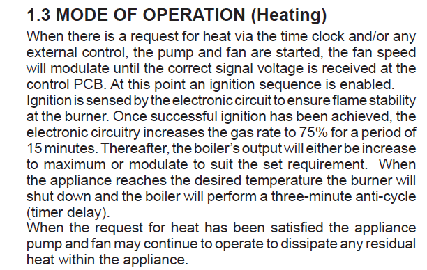

This is what it states in my daughter's 9 year old Vokera Vision 20S MIs.
Not sure how to interpret it but it certainly comes up to target temp very rapidly but the heating load is only ~ 12kw max, but I allways thought that it would take 15 minutes to incrementally rise from 75% to 100% if target temp not reached in the meantime.
I'm quoting a two year old post below. It seems categorical that the 75% mentioned is 75% of the range rated maximum. I imagine we would have an ignition sequence (3 or 4 seconds?) at perhaps 50% of full output, followed by maybe 10 seconds also at that output to check the flame is stable. Then the boiler drops to 75% of range rated output, then gradually ramps up. As regards some other manufacturers, this info is not easy to get hold of. I have no idea how Worcester Bosch and Ideal do it.
Vokera not only limit htg output to 75% for the first 15 minutes but the limit is 75% of the range rated heating output not the maximum htg output.
