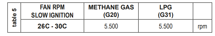

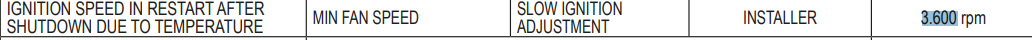

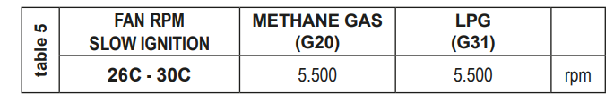

Thanks, very interesting. So what is the ignition sequence e.g. what % of full power (or range rated power) does it ignite at, and how long (if at all) does it stay at that power to check flame stability before going down to 60% of range rated power? I couldn't work it out from the manual. (Maybe it is 3600 rpm which is about 45% of full power? but how long does it stay there)
Just found this but have no idea what slow ignition is:
Ignition speed at firing to ensure reliable ignition (higher than minimum) then it rapidly modulates down dependant on the flow and return thermistor readings.
Once alight the fan speed can reduce but ignition has to be reliable.
Fan speed determines output and that will not rise above 60% of range-rated maximum for 15 minutes, then 70%, then 80% etc until the sequence is broken.

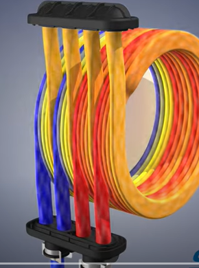

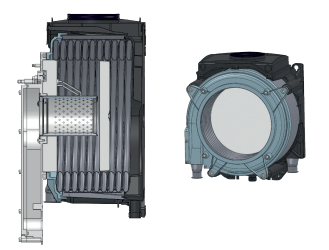

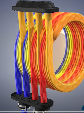

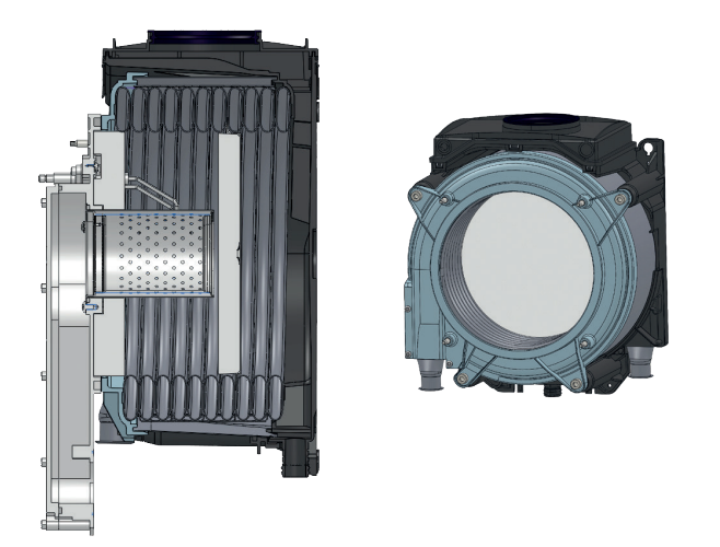

I see the Vibe is stainless steel. Is it classed as large or small bore? Does it pass straight through like a coiled hosepipe or is it a complex pattern like below?
Large bore, no cross welds or manifolds or constrictions. The retarder makes it 2 pass and ensures the flue gases engulf the whole of the tube, throughout it's length.

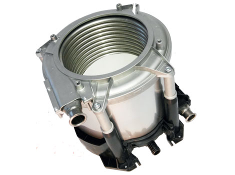

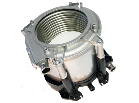

A poster commented a little while back that Worcester Bosch had launched a lower priced boiler with a stainless steel heat exchanger. I think I've tracked it down. It's a new model by the same people who make the heat exchanger in Vaillant/GlowWorm/Ideal/Baxi etc., but this one has a large bore continuous tube design. Maybe they copied yours! I'm sure this is the one because it has a very distinctive front.

It fires at 5,500 then immediately ramps down to below max but comes back up again. With the heat dump turned almost off it reached the set flow temperature (58degrees) then dropped to minimum happy to run continuously.
