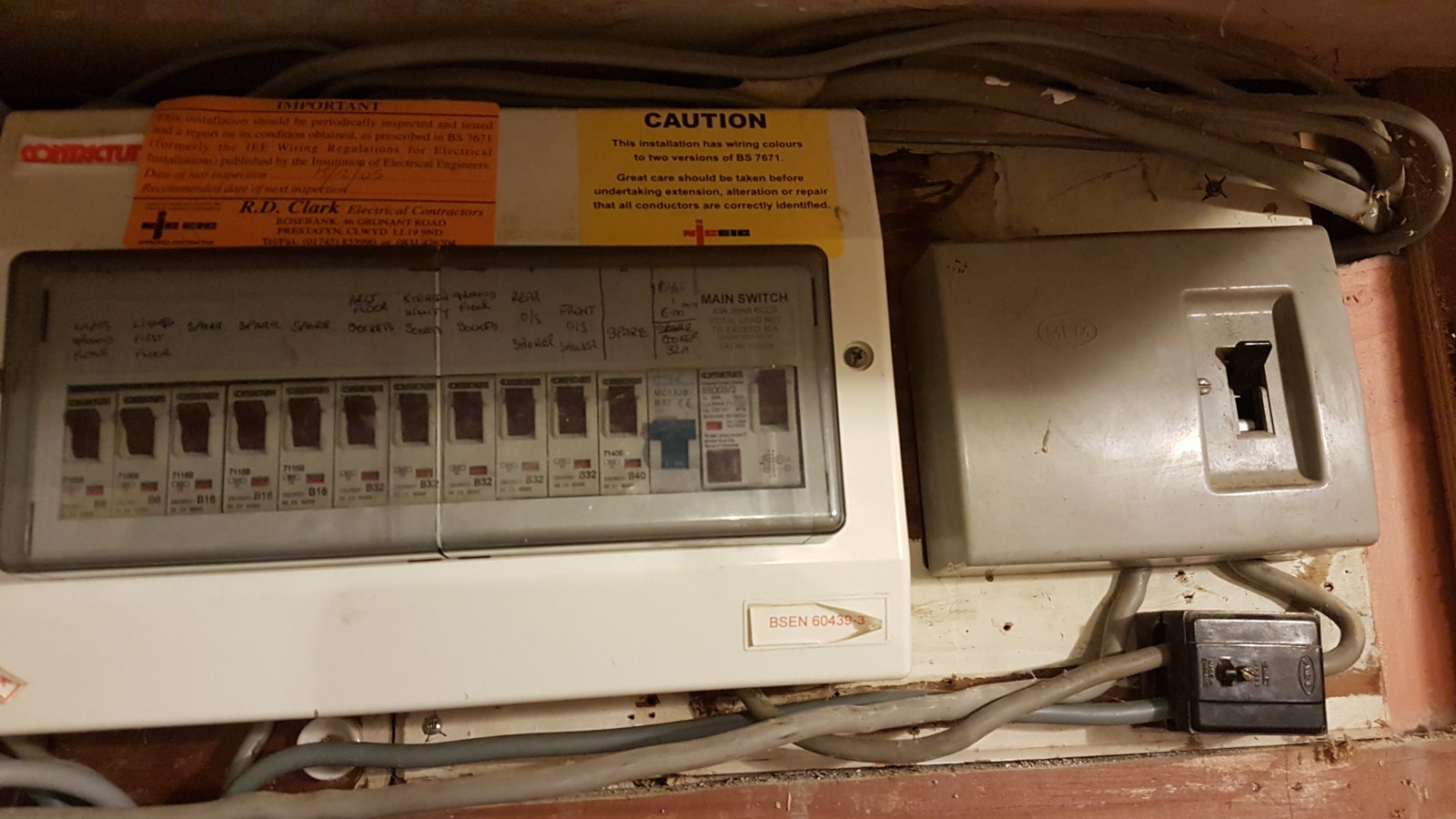

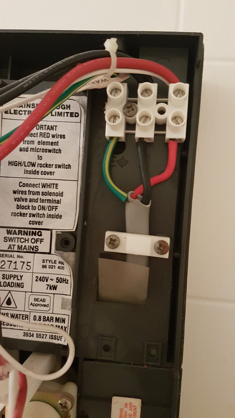

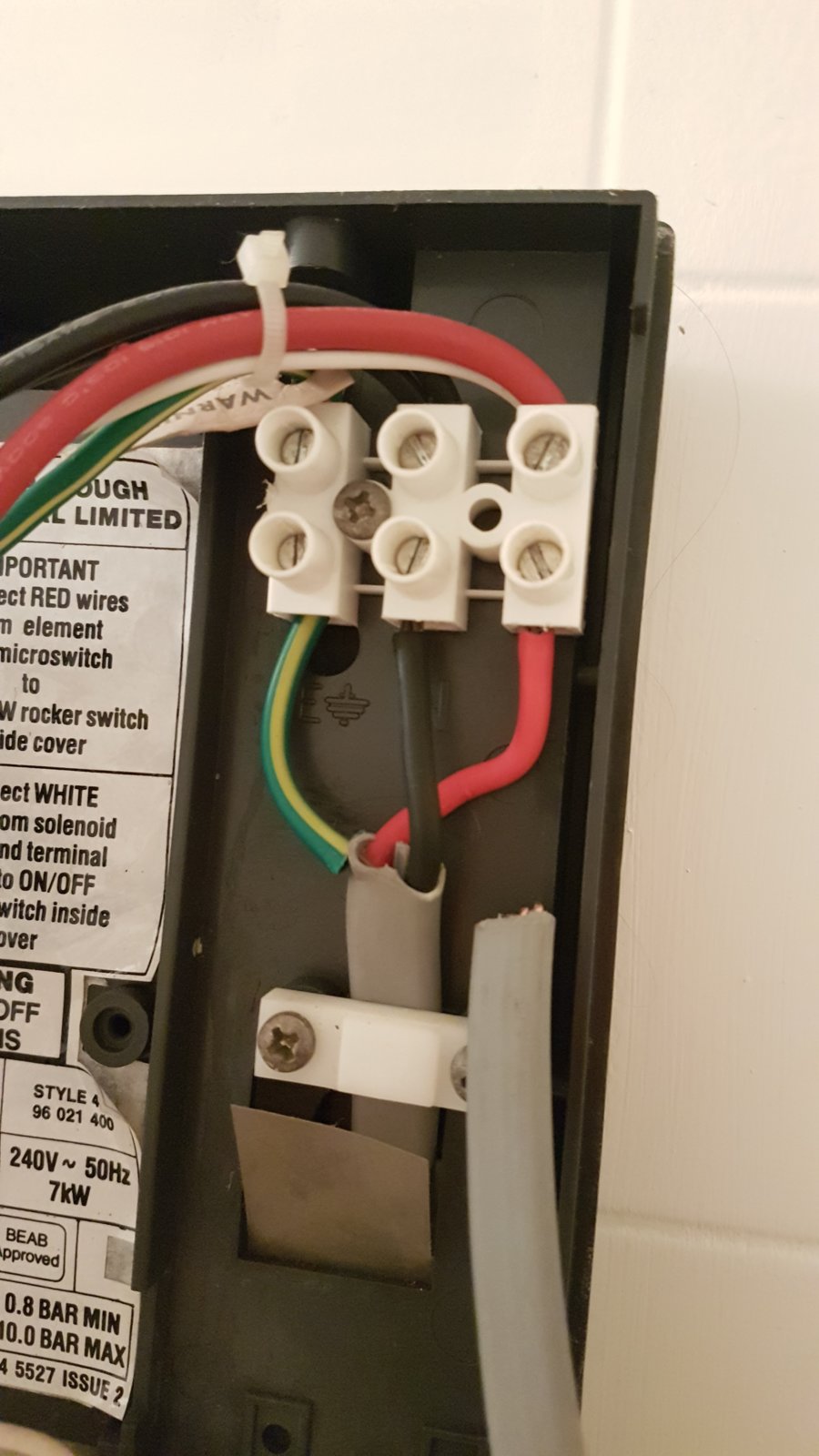

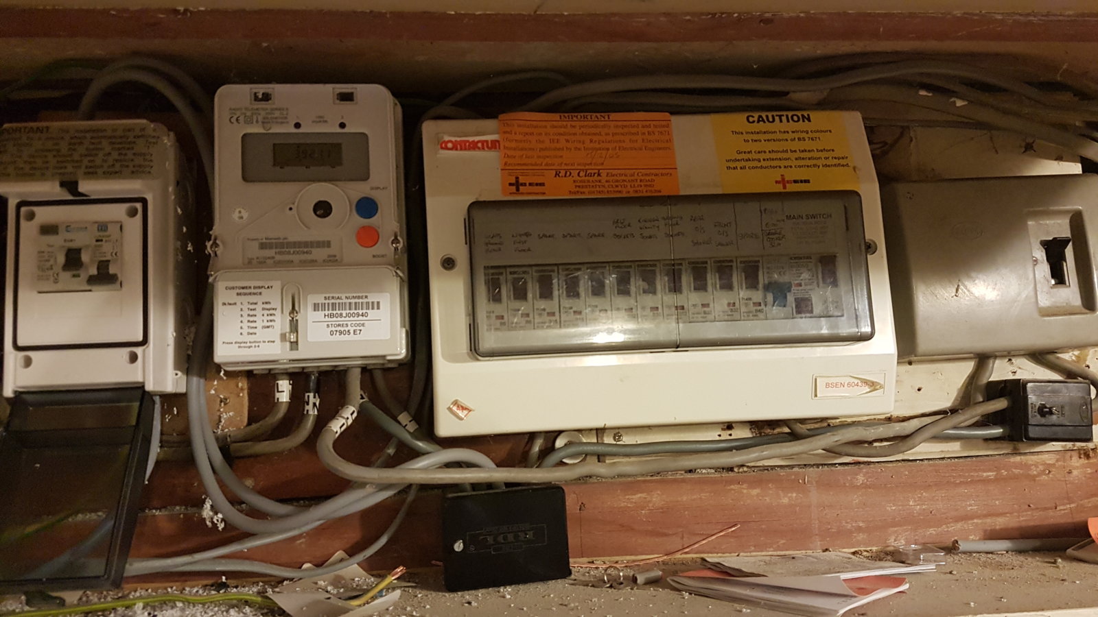

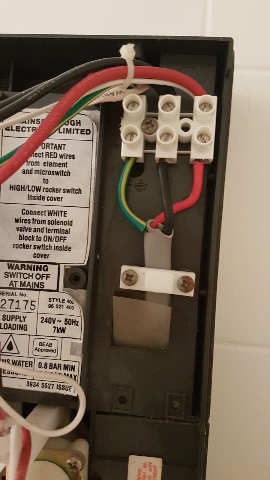

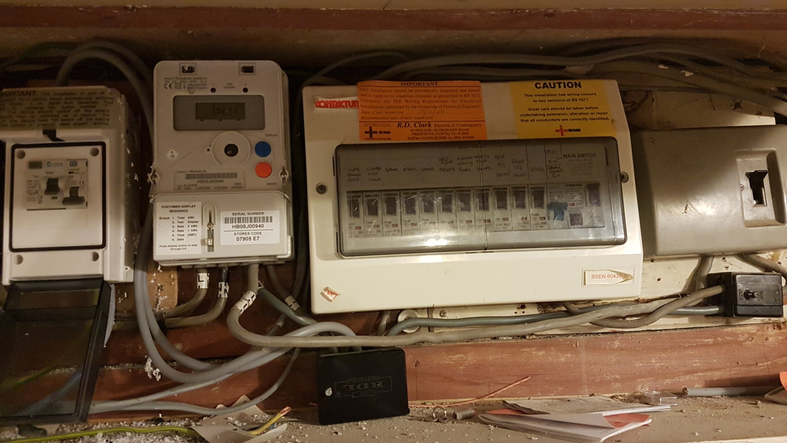

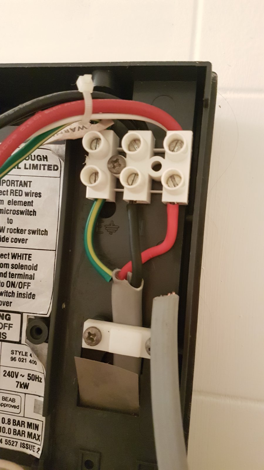

Hi
I'm refurbing a couple of ensuites, want to replace the electric showers (one 7kw and one 8.5kw) with new ones, either 9.5kw or 10.8kw.
Can anyone help identify if the current mains cable is big enough to handle the extra load? The cable measures approx 12mm across flat side. I held a smaller cable up for comparison, that cable was about 9mm across.
A few pics below, including the rcd.

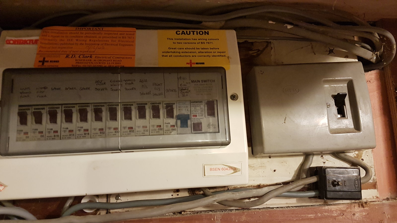

Not possible to accurately identify the size from the pictures, but given that it's smaller than the wires inside the shower, it it very likely undersized.
Are the wires solid core or several individual strands of wire?

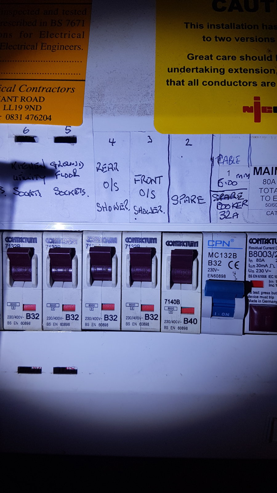

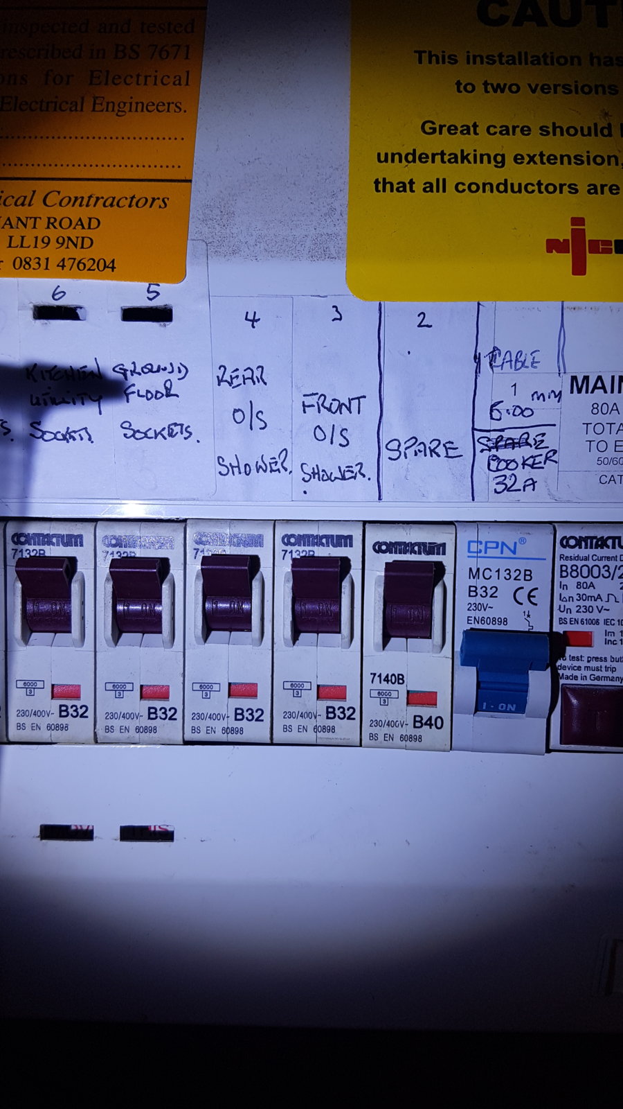

Both circuits are 32A, which is OK for a 7kW shower.
An 8.5kW shower is over 35A, so that is already wrong.
9.5kW requires a 40A circuit, and 10.8 at least a 45A.
As you have 2 electric showers and a cooker circuit on what appears to be an 80A RCD, it's already in danger of being overloaded. Increasing the rating of the showers makes this far worse.
A lot more investigation and work will be required here.
Humm I guess it could be 4mm.
I hadn’t considered anyone would be stupid enough to install 4mm for a shower
It certainly can’t be described as big!

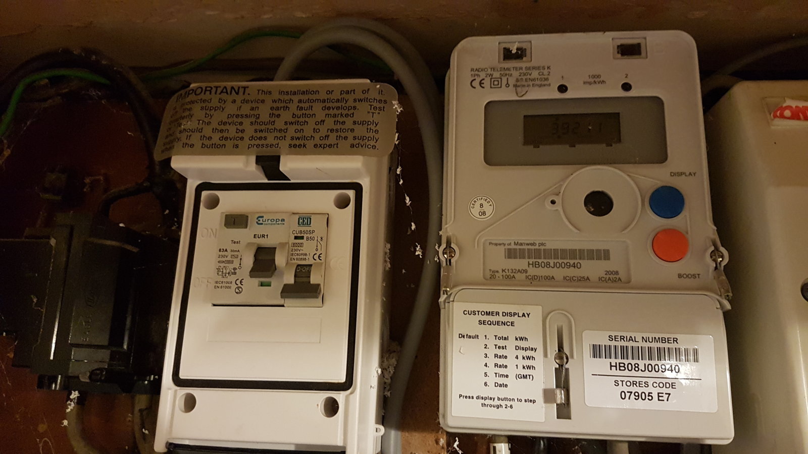

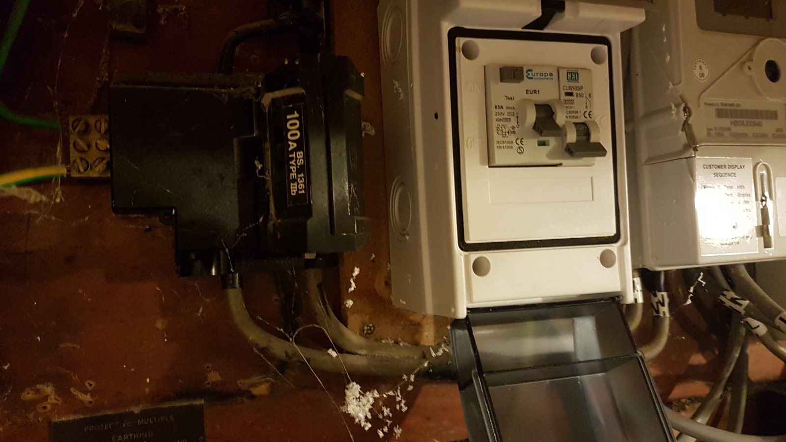

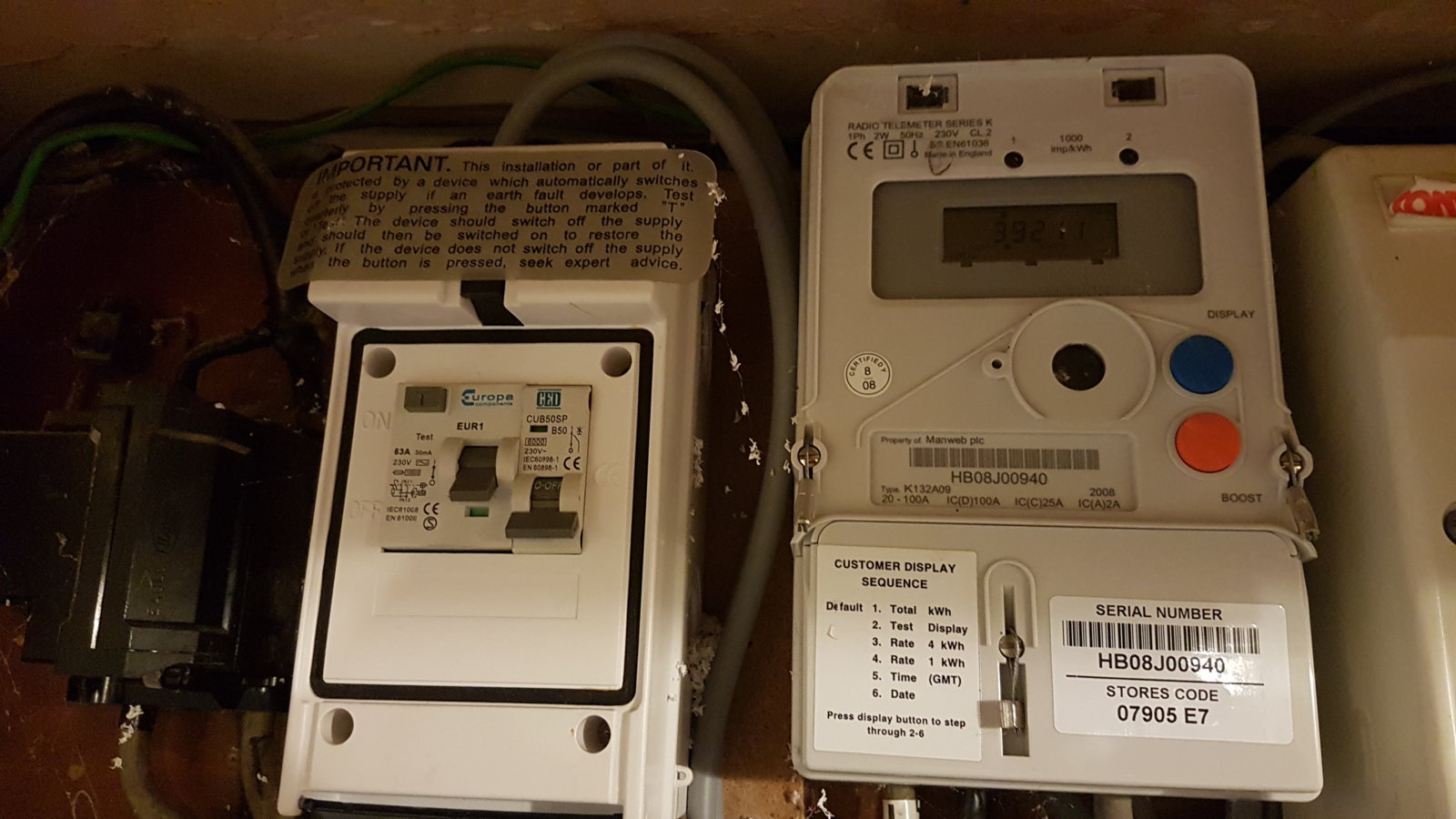

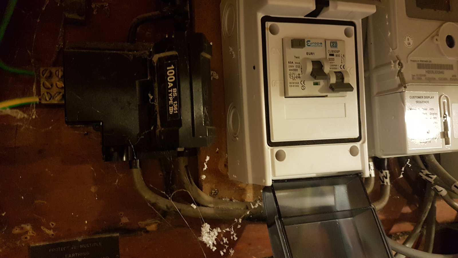

I think possibly it's 100a supply? I've attached more photos of the units.
It seems the unit is incorrectly labelled too. Where it says "cooker" I think this is no longer the case. In the first photo that shows a unit by itself with a 63a rcd (labelled EUR1), that's the cooker. I tested it by switching this off, the cooker went off, but switching off the 32a labelled cooker did nothing.
With that in mind can I out a 45a rcd in the unit for a 10.8kw shower? Everything else on it is just lights & sockets.

If someone can let me know regarding my supply for the property, is it 100a?
If the cooker is on that separate 63a unit what does that mean for the main unit?
In the earlier days of showers, 4 milli was very commonly installed for showers. The leccy boards used it for 6-7kW units.
Can't tell. The 100A on the label is the maximum rating of the housing.
It could have any fuse inside 60, 80 or 100.
