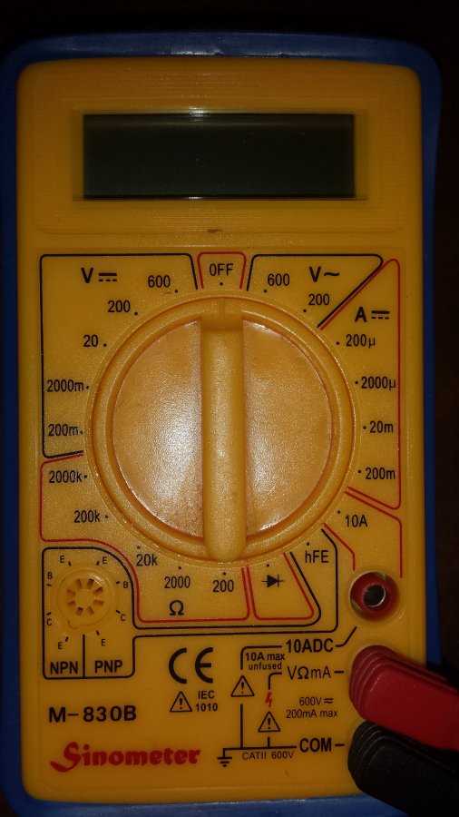

Morning
I've used the following meter to test this morning (don't laugh please, I know it's old school!).
I mainly used the sections V--- and V~, as the ohm section produces some weird readings. Placing the leads on the grey and blue terminals (elements), returns some results in the region of 0.17 and upwards. When placed on the grey and brown terminals of the stat, the readings under the V sections are 0.00, but under ohms, the readings fluctuate.
Would this suggest the stat has gone?
OK - let's try again!
1) Turn off the power to the immersion
2) Set your meter to 200 ohms - dial pointing to the bottom of the meter
3) Touch the two probes together - your meter should display 0.000
4) Rotate the thermostat setting so that the arrow points to the dot next to 80
5) Place the probes on the grey & brown wires and note the meter reading
6) Rotate the thermostat setting so that the arrow points to the dot next to 180
7) Place the probes on the grey & brown wires and note the meter reading
Post back here with the readings

Touching the probes when set at 200 ohms results in 00.4. When not touching, it shows 1 . .
I can't see the 80 and 180 points you're referring to?
Thanks.
On your first attempt, you were using the AC and DC voltage scale, which would give you all sorts of spurious measurements.
Your meter is off at 12 oclock - turn it to 6 oclock (200 Ohms) and bash on.

You will NOT get 0.000 by touching the probes together though. There is always SOME resistance. 1.6 ohms on mine, might vary slightly on different models of course but in that ball park. But that doesn't affect your other results.
Well in that case you need to clean your probes - what's the point of a meter which always gives you an inaccurate reading? In your case, every resistance reading would be out by 1.6 ohms!
