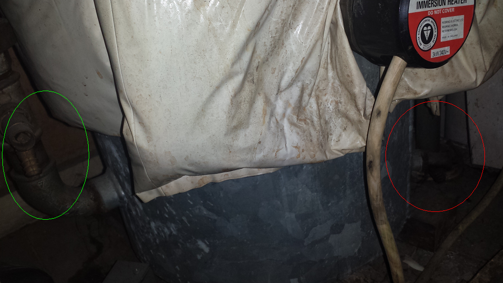

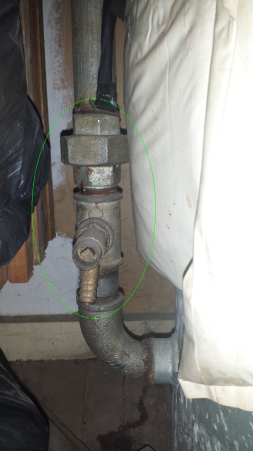

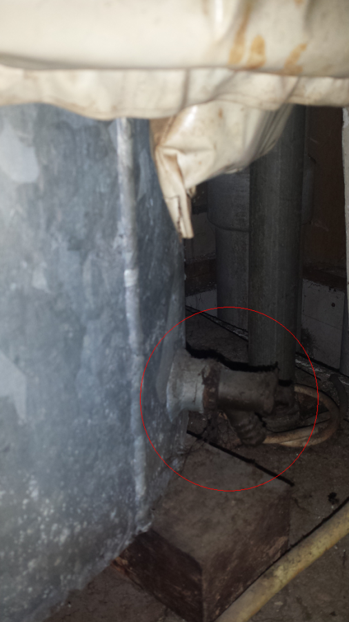

Whilst I'm waiting, does anyone know which valve I've need to use to drain the water from the cylinder?
Red or green? I think the water inlet is from the green pipe, so I'd imagine the drainage would be the red valve?
