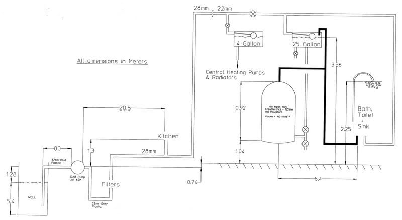

Ok, here's my schematic with sizes and dims.
I've measured the flow rate at the bathtap and kitchen tap and they are both 11 litres/min.
For the Un-vented system to work, it requires a min of 1.5bar / 20 l/m. I checked the pump whilst the bath tap was fully open and it held 3bar (well, the needle was shaking +/- 0.2bar!)

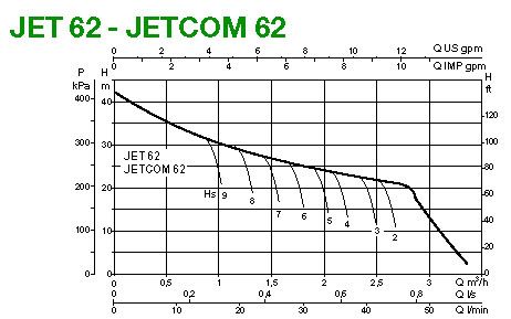

This is the graph of the pump
As you can see, the pump has to only lift the water about 10m.
Am I right in saying that, if I were to install the un-vented tank in place of the hot water tank, then the Head would decrease, thus possibly increase flow, as the pump can work easier?
If your drawing is as fitted then you have a blockage, at 3bar you should have at least 40L/m
Check the fiters
Almost 300 feet of 32mm suction delivery pipe to a centrifugal pump ?.
Im surprised you havent questioned this Doitall !.

Why !!!! 32mm can easily supply the pump, there must be a ducks foot or other type of non return valve, and once the pump is primed it should run ok.
Saying that there is obviously a problem with the supply as the pump should suppy more than 22l/m. Could be the filter is blocked.
I would have a word with the manufacturer for possible problems and get their feedback on board before making any alterations.

How did you read that pump graph for 40l/m @ 3bar?
Is 3 bar not equivelant to 30m of head - saying that 1.42psi = 1m of head?
I did some pump calculations at Uni and gave it a go last night..........I don't think my answer was anywhere near the truth! lol
How many Psi in a bar, methinks you have the dot in the wrong place :rolleyes:
E.G. 14.2
The kitchen sink if it is connected as per the drawing you should get virtually 3bar at the taps, certainly enough to cause a splash :rolleyes:
Er... no! He was refering to ONE metre which he has correctly shown as 1.4 PSI.

Looking at this I would certainly not have installed any more than 30M of 32mm mdpe suction pipe to your pump.
These set ups are quite common in my neck of the woods and I have never seen the pumps situated at great distances from the well head.
The old practise was always to build a pump house at the well head and run the electric cable to this and not the other way round.
Where is the pump situated at the moment. ?
Is your vertical lift (elevation) definately no more than what your diagram states ?.
