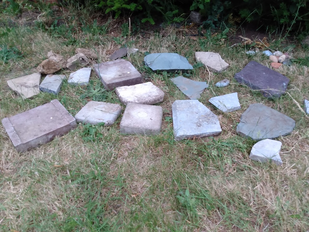

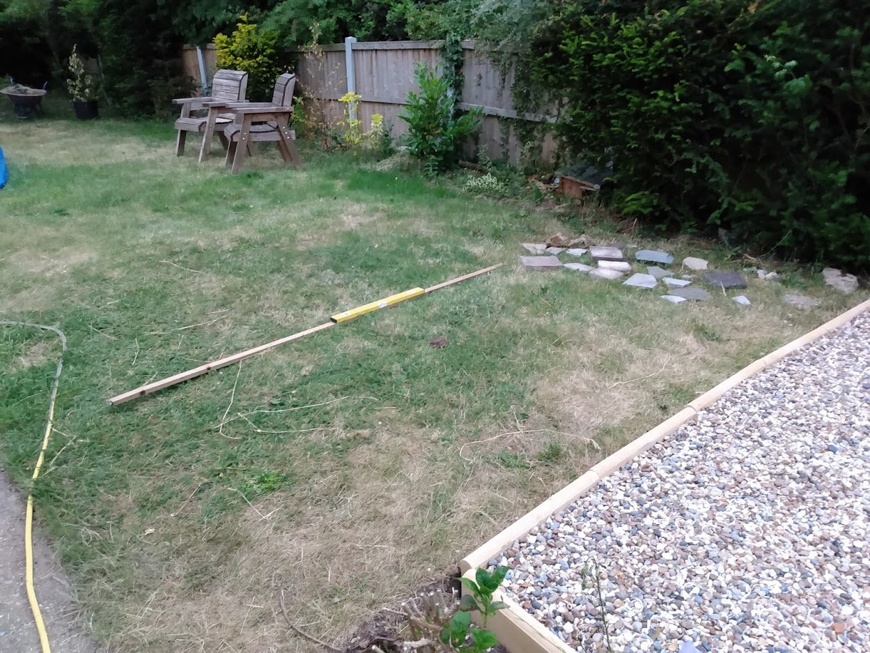

Well, this is my pool plot and random selection of slabs and things from around the garden.
Quite a few have smooth edges. Hopefully enough and all the perfect size ...
Just an idea - don't put too near trees coz it will soon fill up with debris?

Trees - yes, will make sure nothing overhead and will cut those yes right back. That is mostly why this is the spot, as no trees hanging over in this bit of the garden.
Also, when it is not in use it will be covered. Cover will come off only when somebody wants to go in.
At least, that's the plan. SHould help keep it warmer and reduce evaporation too, and fewer bugs landing in it!
It's very important that the ground is as flat and level as possible. Any slope will put extra pressure on the down sided walls.

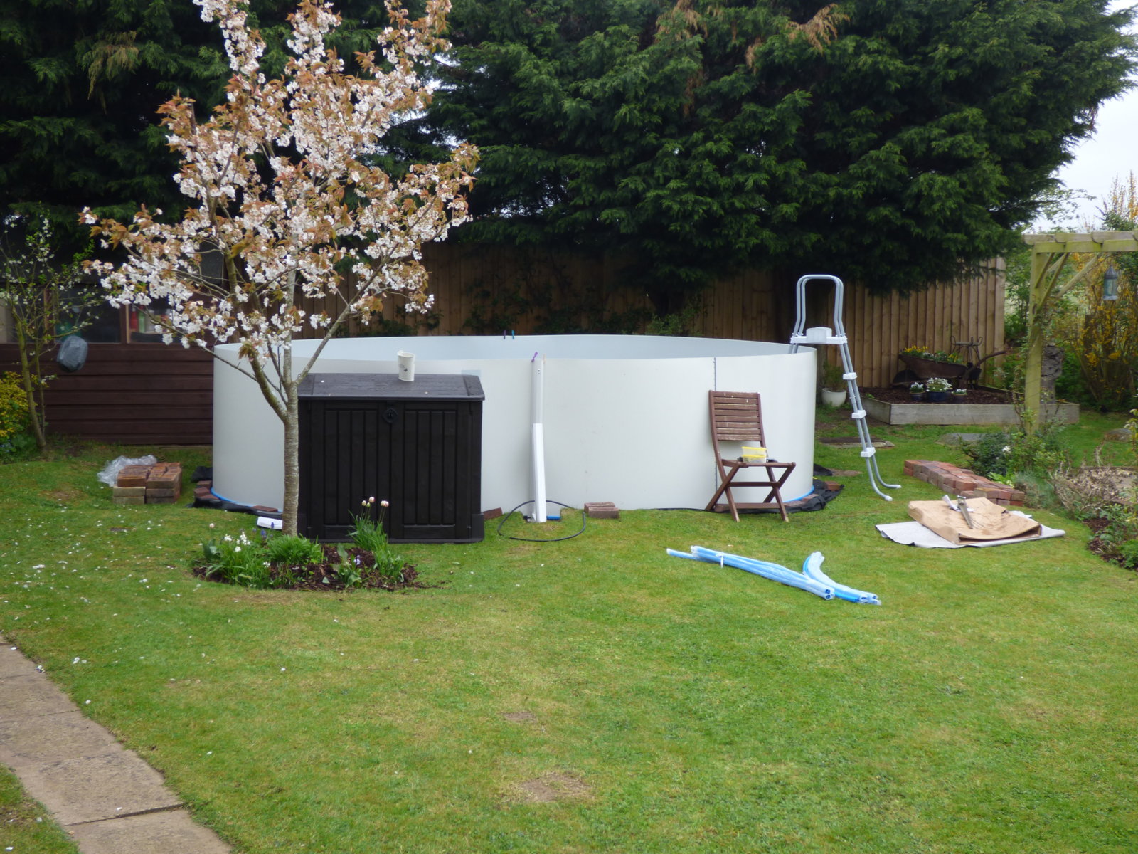

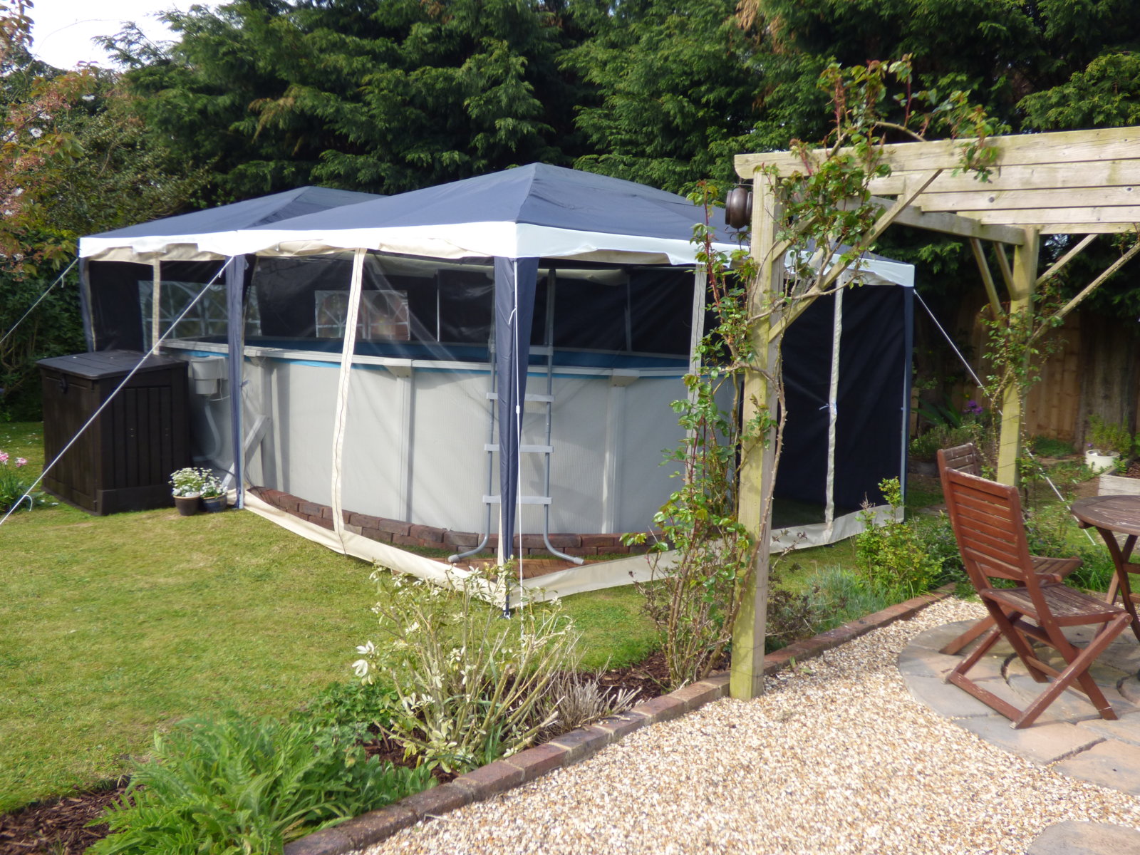

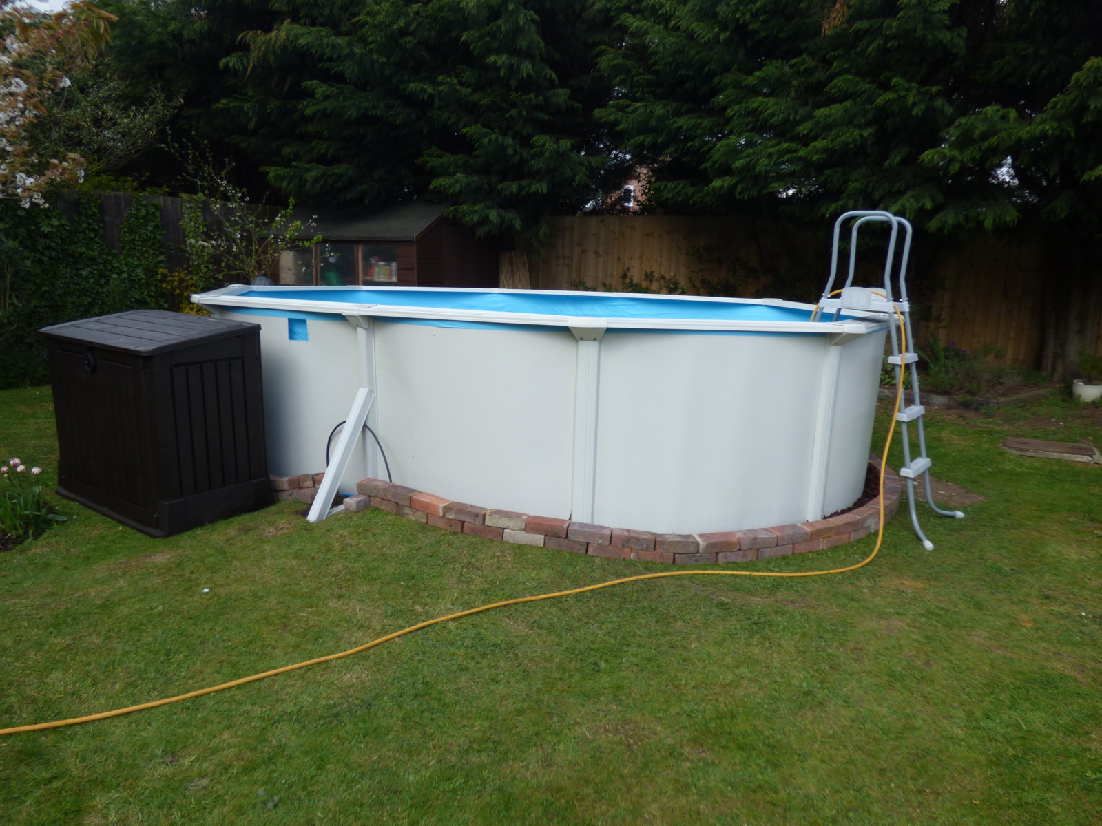

For heating we bought an air heater. Cost was near £700 but it paid for itself by the savings in electricity. Using the supplied 2.8Kw heater we couldn't get the temp over 21-22C
Using the air heater we could get it to 34+ overnight. The problem with our pool was it fed the heated water in at top level which created a lower cold level so we used to stir it with a large paddle before getting in. This tended to lower the temp to around 30-32C so was still comfortable.
Our pool was quite large, 12' x 16' x 4' deep so took a lot of water, (thankfully we were not on a meter LOL). Here are some pics taken during construction. I did have a few of the pool full and an adult in the water, which would have given some perspective of the size, but can't find them. Maybe if I tell you it took me 5 full crawl strokes to go from one end to the other you can get an idea. The plastic box housed the filter
& pump and the air heater was situated to the left of it
One final warning. DO NOT kick off from the side walls!
The bricks around the edge are roughly placed and purely decorative and hide the pipe works to the left.
