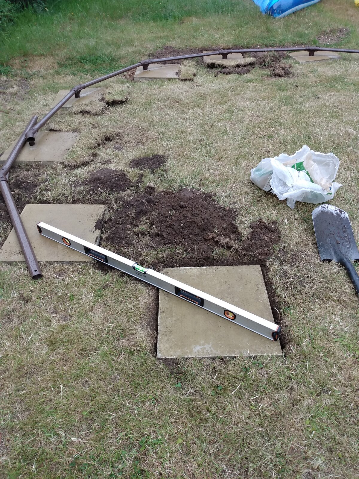

WEll, i thought it was levelish, filled it, out by a mile.
Now emptying. Then need to level it!
What is best way to level:
  • Dig out until level - and possibly remove a large root just under the grass...
  • Dig out as much as possible, then put edging around the area for the pond, and fill with sand - I have a square groundsheet so could level to this size
  • Something else.
Want it done soon. Don't really want to put down anything too long lasting, as in a few years it will be back to lawn probably (or some odd round dead feature...)
Need to get a bigger level too.

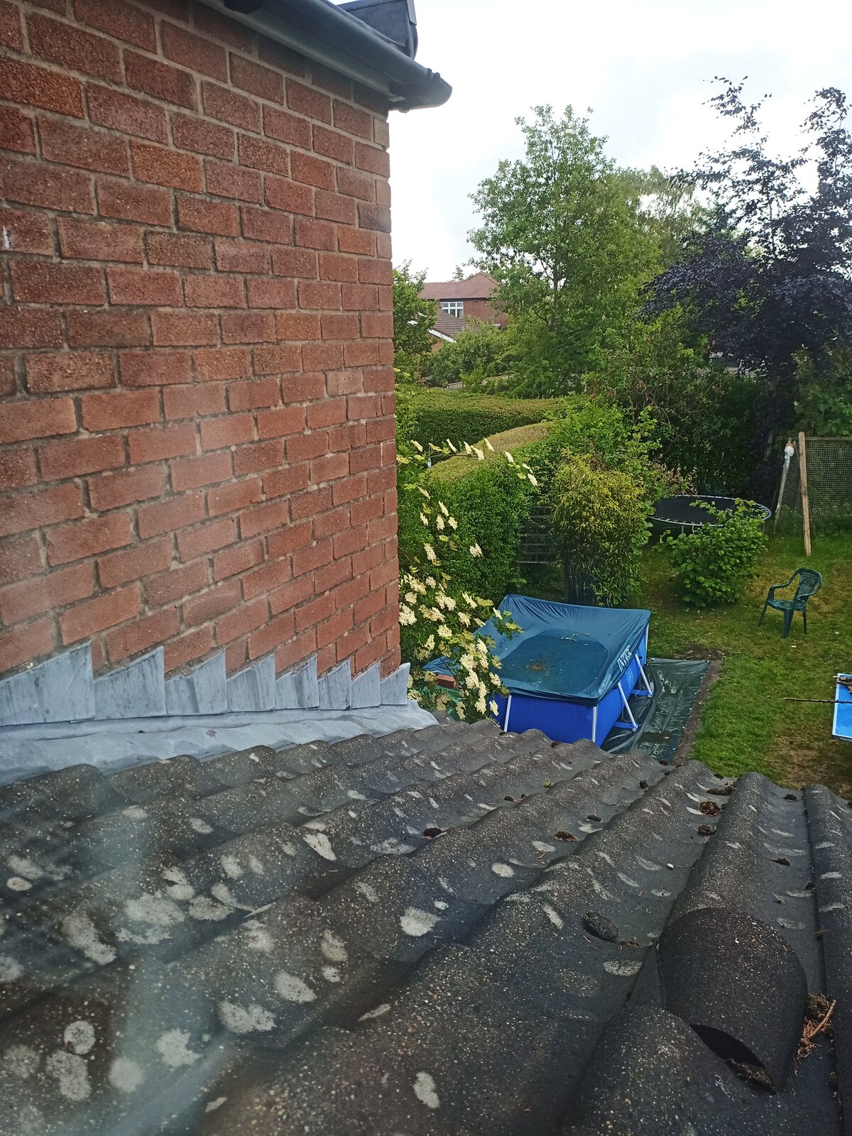

We have an Intex 3m x 2m pool. We had an area where we put a swing set that was dug out a little. When we got the pool, we threw a load of sand down, levelled it as best we could, then put a tarp under. That lasted a few years (the sun eventually got to it) so this year we bought a new tarp.
We fill it using some hot from our new (ish) combi boiler, but don't have anything to warm the water. We considered a heater pump, but they were around £300....

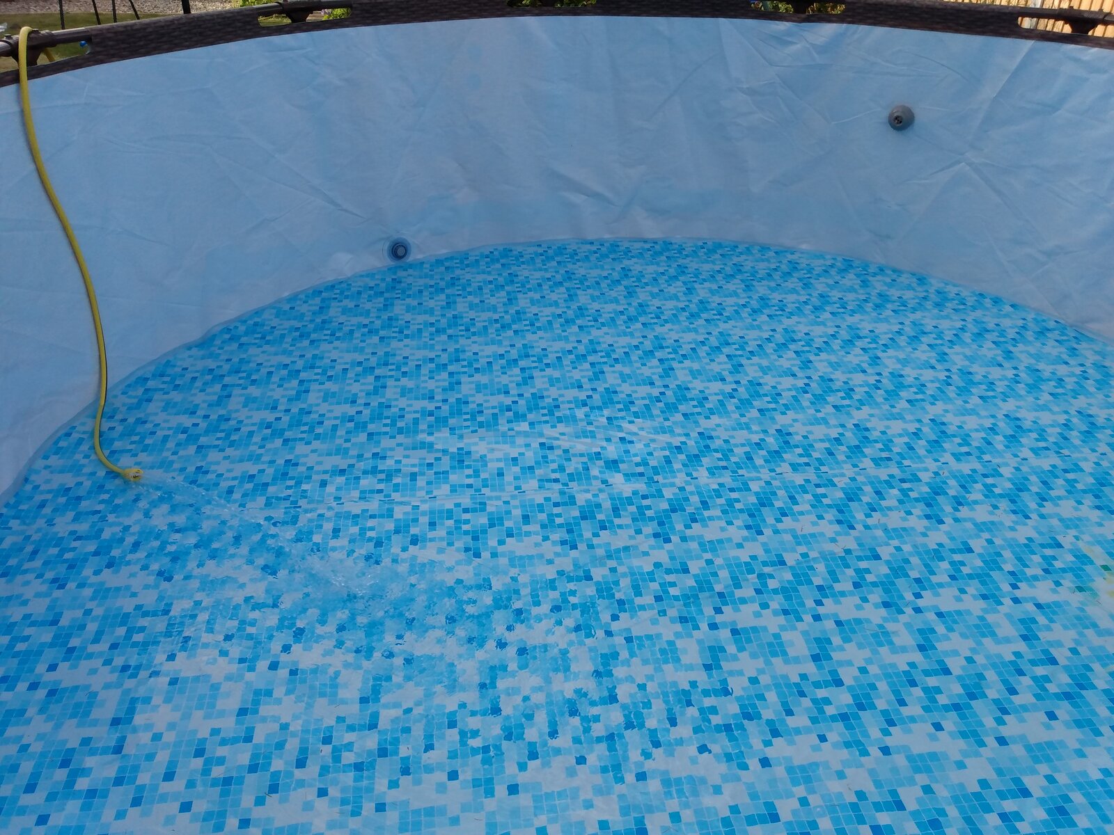

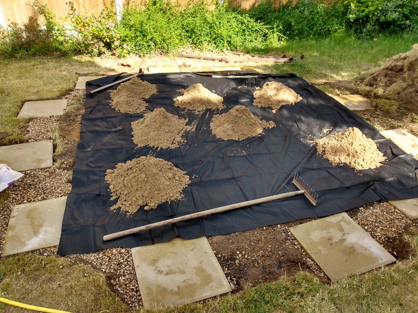

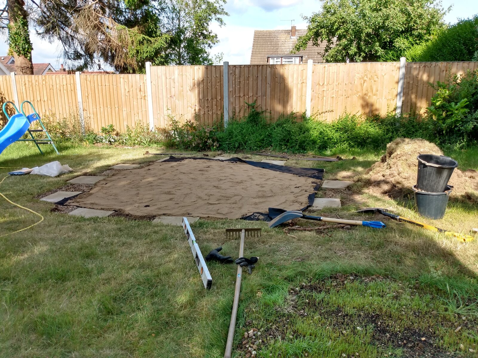

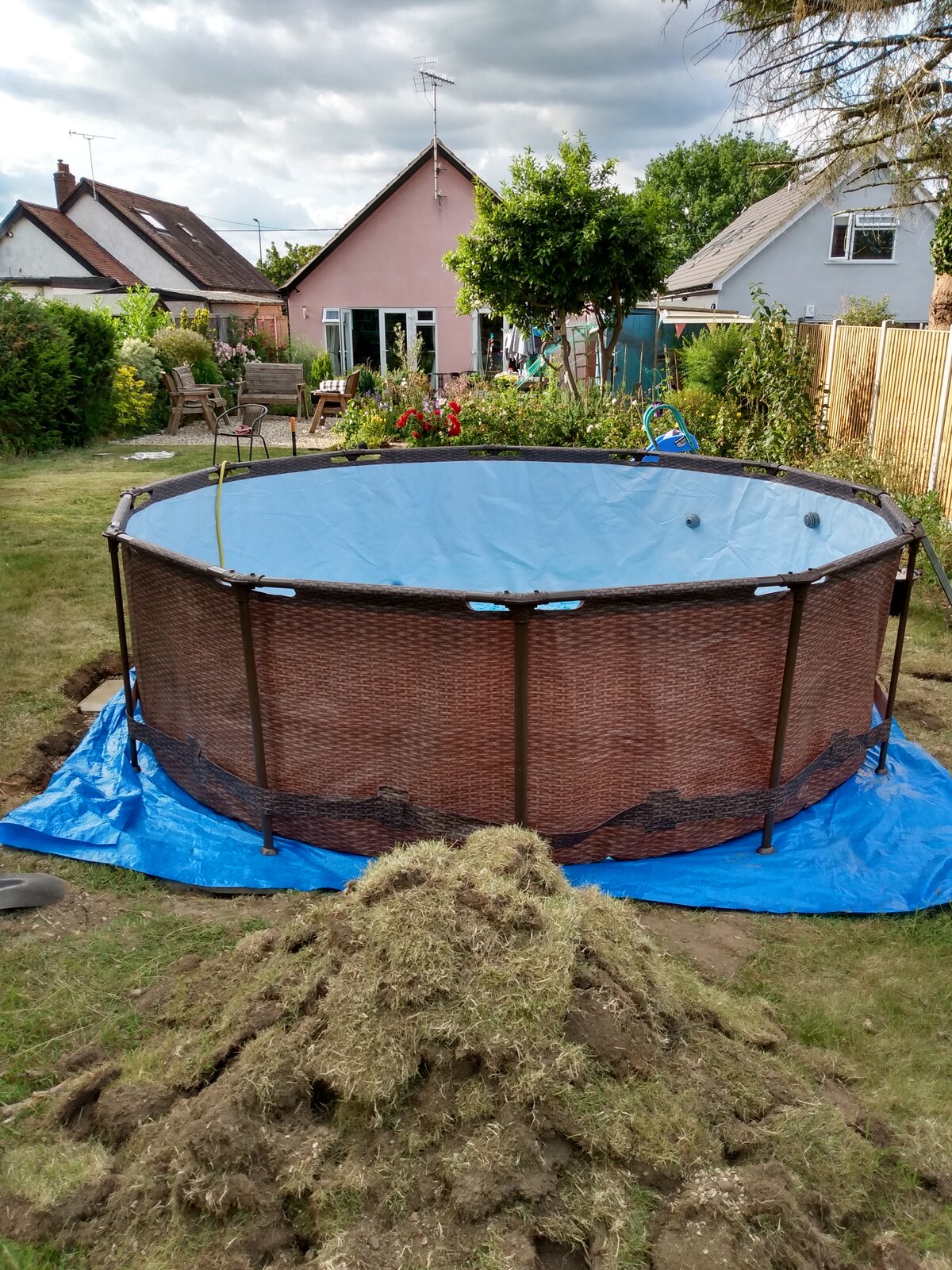

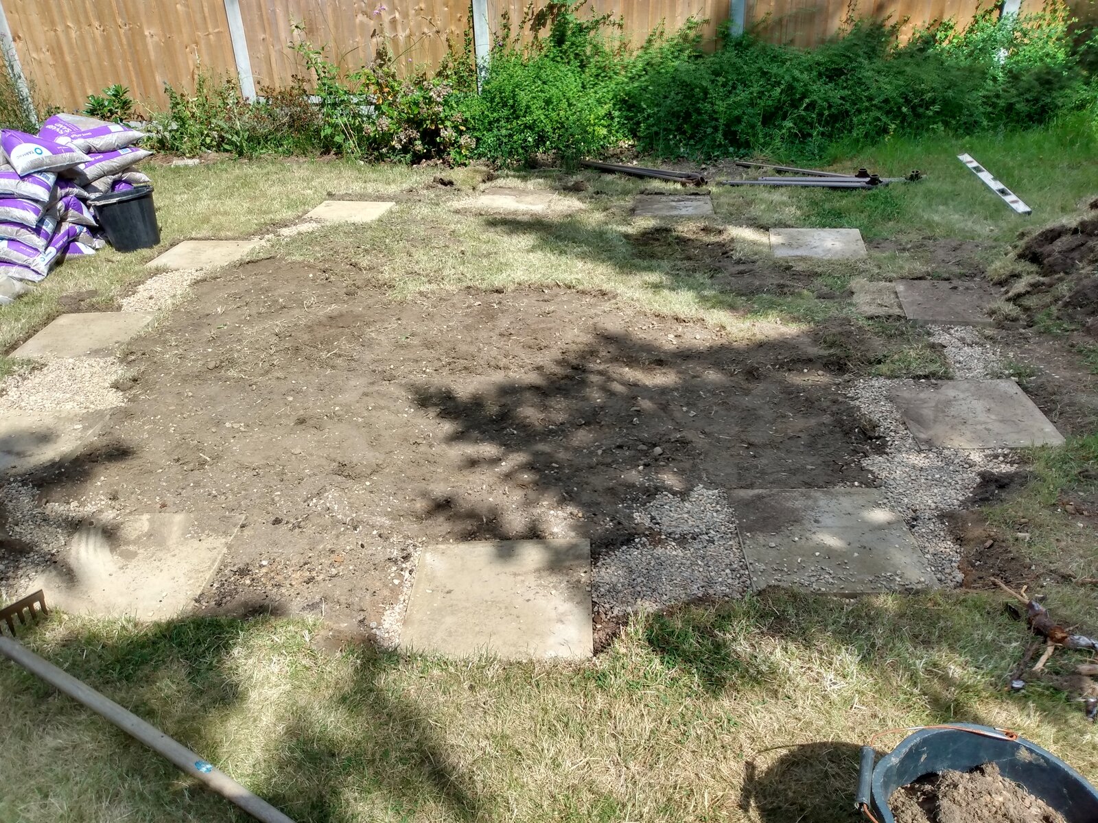

Finished installing today. Had to dig a tonne of earth out, then discovered an old tarmac path under the final 3 slabs. Removed turf, put down weed killer, then weed barrier, then 12 bags of sand, then another weed barrier, then the blue tarp that came with it. Just started filling it.

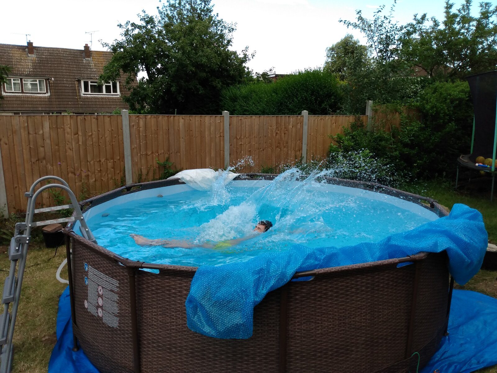

Pretty level. Just need to set up the pump and heater, work out how much chlorine to add, and build a little house for the electrics, in case of unexpected shower.
He's made of tougher stuff than me. Says it's warm. Thermometer days 23 degrees.
