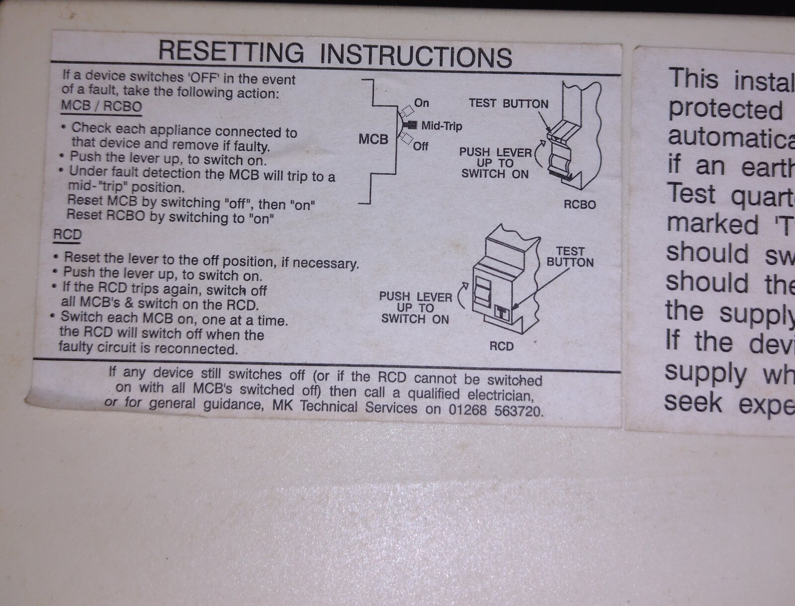

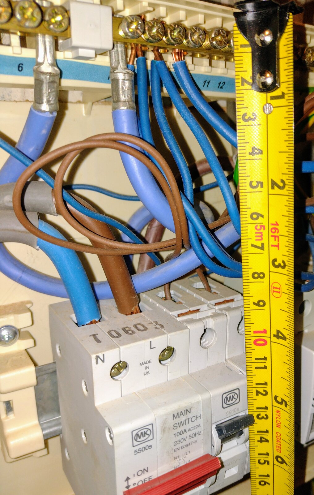

I'm planning to only uograde the lighting curcuits from standard MCB's to RCBO's because currently I have no RCD protection to any of the lighting circuits.
I only found out about this when adding a new light to my uninhabitable loft area.
I will all of the other circuits e.g. Ring and cooker in place as they are RCD protected.

Also, looks like I have room for the RCBO's
I would say there is room. Sometimes you have a mass of cables coming across you can’t move.
Personally I would go for 2 6A to ensure your lights will stay on as much as possible.

However looking at the way that is wired it may be tricky making the space for full size RCBO's
These https://www.tlc-direct.co.uk/Products/MKH7732M.html at £14.20 are rated 6KA and much easier to fit in there

Hopefully, you have isolated things prior to the CU i.e. using a DP isolator at the meter.
Otherwise, please avoid removing the cover off your CU while live, especially when wielding a metal tape measure.
On the right hand side use the existing RCD then put the other lighting circuit here and Bob's your uncle?
Not permitted, as the existing RCD is a Type AC, which is no longer permitted for anything other than fixed equipment which has no DC components - basically resistive heaters and nothing else.
