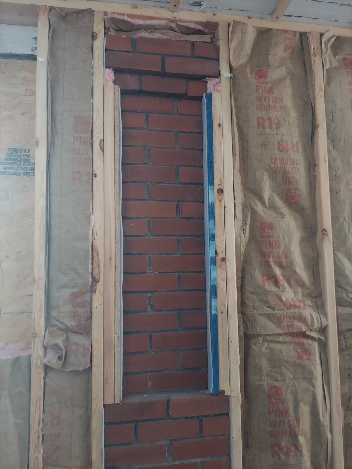

Recently enclosed porch. There are original brick columns supporting roof/second floor.
I believe it's considered brick veneer as there is wood inside columns.
I am insulating and drywalling new walls.
What do I do with columns? I have been given 2 completely different sets of advice, both from contractors.
1) just insulate as possible and drywall. Area will be heated and I need not worry about condensation behind insulation.
2) Do not insulate or drywall over columns as condensation will cause mold/rot problems and may compromise the brick.
I don't mind the appearance of brick, but I'm in Central PA and on days like today (12° F) the brick is very cold and I can feel air movement.

On the brick columns, insulate them, then fit a vapour barrier, then plasterboard (drywall to you).
What is important is you have a vapour barrier on the warm side to stop vapour travelling through to cold surfaces.

Anyway..insulation is faced with paper, im assuming that's enough vapor barrier.
It's particularly important I get this right, I may not leave home for next 4 years!
Probably not to be honest.
to be confusing there are vapour barriers and vapour control layers
You need a vapour control layer, it goes on after the insulation and before the drywall
Im not sure of suitable brands in the USA also it may require a particular type depending on your climate.
heres a bit of info on vapour control, it is important as interstitial condensation can be a real problem in timber construction
