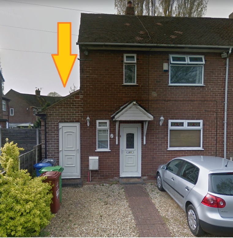

It seems you have a supply to your garage but there does not appear to be an separate mcb supplying the garage. Is it possible it is fed from the kitchen socket circuit & if so is there a junction box on an outside wall anywhere between the kitchen & garage? Damp in a junction box is a much more likely cause of intermittent tripping of an rcd.
Sorry, I just put garage as it's easier than explaining what it actually is. It's just a little storage room on the side of the house, where the Combi-Boiler is, and my girlfriend's treadmill. Whoever did the kitchen extension to the rear side had this put at the front of the house for extra storage. The sockets in there aren't on the kitchen circuit though.

Is your combi boiler on the same mcb as kitchen sockets ? Incidentally ,every time you ran a hot tap ,the boiler would be firing up and using electricity. Just saying , as when you think nothing else is using electricity ,the boiler may be.
I'll double check when I get home - but I expect the boiler is on the circuit labelled 'Water Heater'. TBH, that's the only MCB I didn't switch off when checking the circuits as that's something I just assumed was labelled correctly, and didn't want to mess about with it.
However, I definitely wasn't running water at any of the times it has tripped off so far - once I was out of the house at work, once I was sat on the sofa watching a film, and last night I was in bed.
