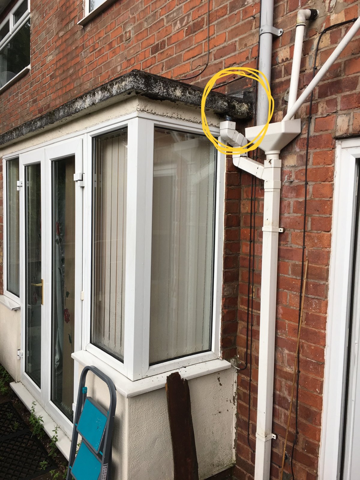

Another Update: I think - though I obviously can't be sure - that I might have figured it out.
At the back of the house we have French doors, with a flat roof over the top. The drain for the water to come off the flat roof was completely blocked up with mud and leaves, and so it was like a lake on the flat roof, and the water was over flowing and pouring down the wall of the house. Unblocked the drain, all the water came cascading out like Niagara Falls, and now the roof is clear of water.
Photo attached with the area where it was blocked circled. The white frame you can see just to the right of the photo is the frame of the back door leading into the kitchen - so it could well have been getting onto the kitchen circuit through cracks in that wall? Maybe? Hopefully?

Very unlikely ,in my opinion. Water presence that causes RCD to trip ,would ,more often than not, not allow the RCD to reset straight away ,and would have to dry out. But its not beyond the bounds of possibility.
Has the RCD tripped today ,with all relevant mcbs on ?
That's the thing - on Saturday night and the early hours of this morning it wouldn't reset straight away, it kept tripping back off until I switched off the Kitchen MCB. Friday I wasn't home when it tripped off so it could well have dried out by the time I got home, and so reset straight away.
