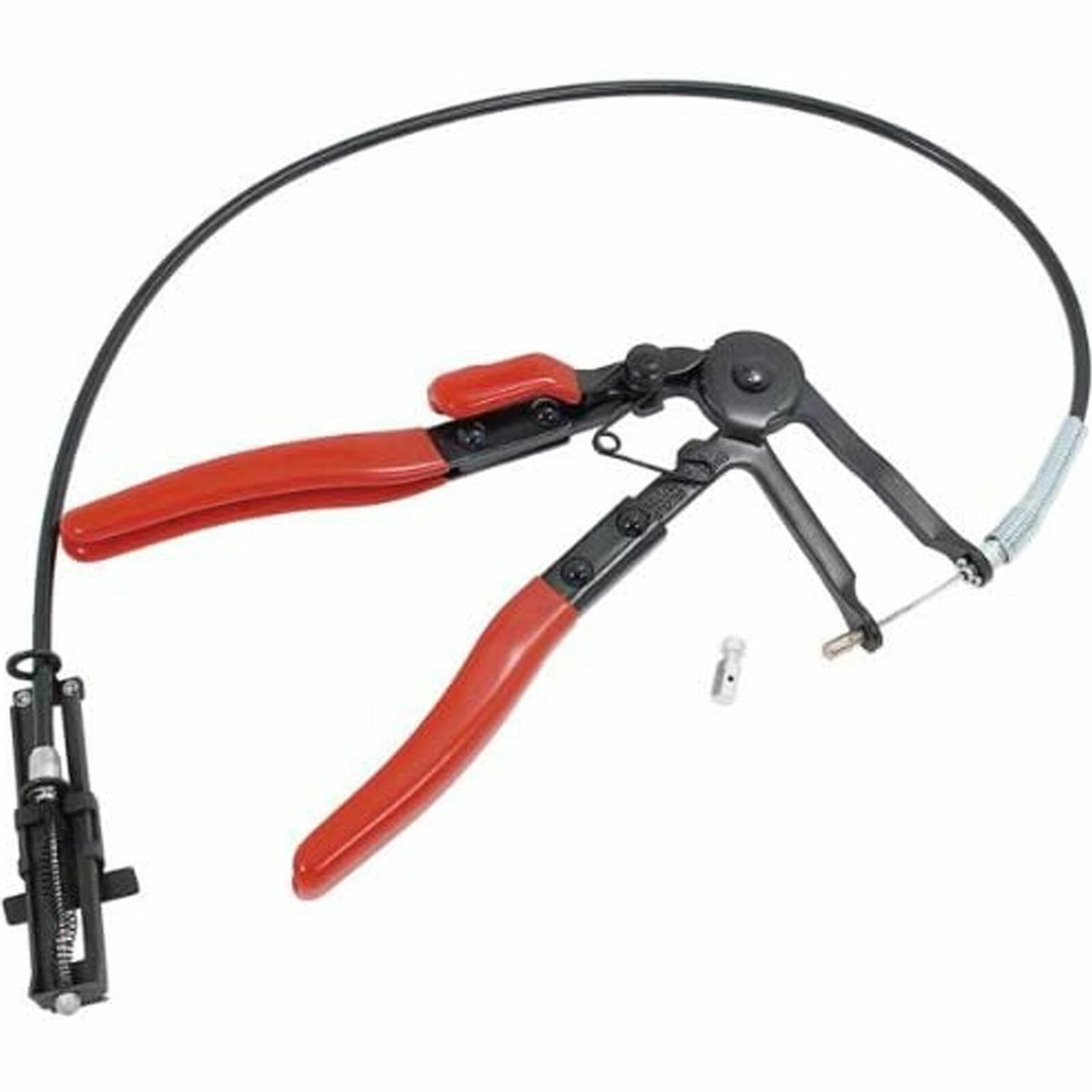

I use a pair of these on those clips - much easier, even if you can only just get your hand to them.
