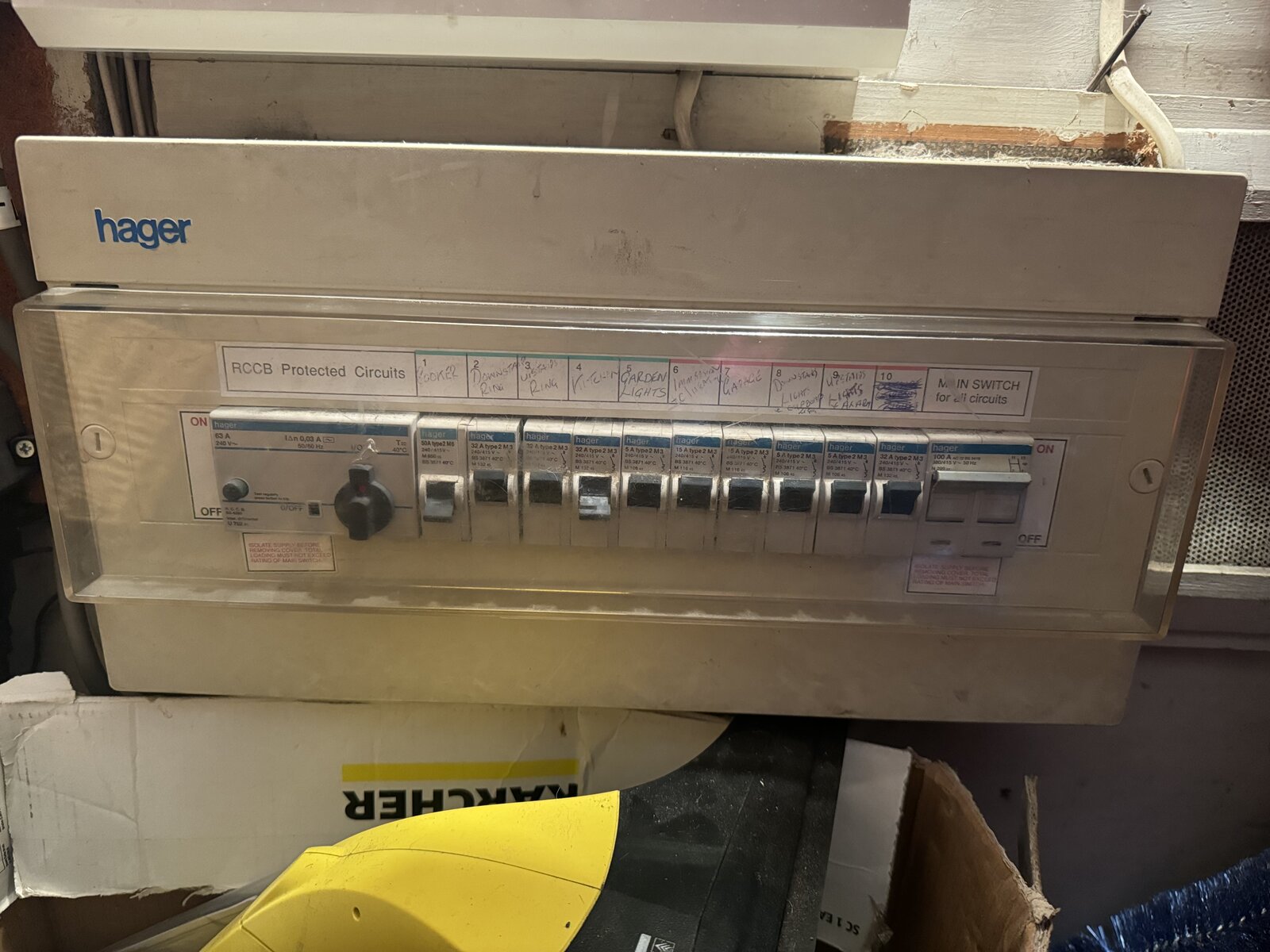

This is what I’ve got - my Brother in Law fitted it about 20 years ago. Is it worth me cutting my losses now and just have the whole bloody thing replaced?
Would be a good option to replace the board with a full RCBO one. Depends if you've got the £££.
That’s definately on the books when this kitchen is finished but for now, I think I have it sorted. After a lot of chopping, sawing and hacking I managed to remove one board at the side of the hot water cylinder in the airing cupboard using my multi-tool and using a piece of trunking, I taped two 2.5mm cables to the end of it and with a bit of luck, guided it from under the floor under my stairs near to the hole in the floor in the airing cupboard. I felt around and fished it out. I now have 2 x 2.5 cables running from my consumer unit to the location where the ovens will be. Another bit of luck, if you look at my consumer unit, there’s a 32a breaker on the far right with nothing marked on it. I took the cover off and checked and there is nothing going to it so it can be used. I spoke to my electrician mate and asked him if it could be used for 2 x 20a feeds (one to each oven) and he said we can just connect the two 20a dp outlets with a link wire to make up a separate mini ring main just for the ovens.
